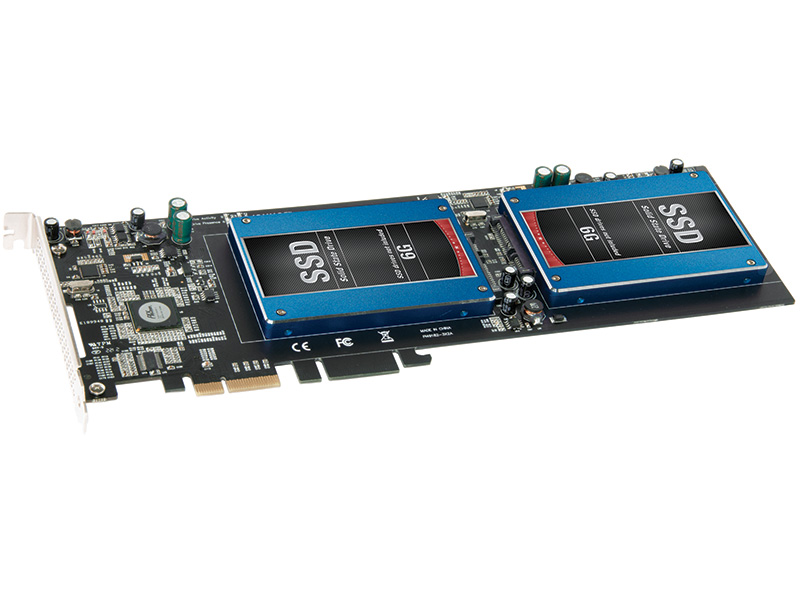

Just for the record, there is also the Sonnet Tempo SSD Pro, which let's you build this thing yourself and might end up less expensive/with a higher performance if you use different drives than the OWC.
This is exactly what I've been waiting for... it's just a shame that it's $300. It should really only be about $100. However, even at this price, you can build the equivalent to a 1TB Accelsior for about $1K USD.
EDIT: One other thing to keep in mind when evaluating or benchmarking SSDs... particularly Sandforce based SSD's as in the Accelsior... they rely on data compression to achieve rated performance, so obviously perform best with compressible data (like programs and documents) and perform lower than expected when dealing with compressed media files (images, video, or audio). As a result, Sandforce based drives make great OS/Apps drives but are eclipsed by other brands when it comes to media storage duties.
If you really care to get one of these, the cheapest price around is $252 with (as far as I can see) free shipping.
In a few reviews, they all mention that the Marvel RAID controller in the Accelsior is the element that is bringing down performance in the 4K chunk area.
How are we to know what the RAID controller is like in this Sonnet card??!
