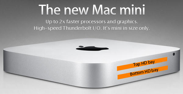

So is the "upper" bay the one on top when the computer is right side up (normal) or upside down when you have the bottom opened up?
I'm also about to do this upgrade. My spinner is in lower. I was thinking of swapping the drives anyway for two reasons. I'd rather have the spinner above the SSD, closer to the aluminum body, where I suspect heat will be taken away from it a tad quicker. Second, I'd rather have easier access to the SSD in case I need to replace it again.
Also, while I'm at it, I plan on re-applying the thermal paste, using some Tuniq 4 which seems to be recommended here and on other forums for the Mini.
Also, this graphic is helpful:

The confusion comes from some of the Ebay listings, since they don't specify which way the Mini is oriented when they say upper and lower. Some list the second drive cable as upper bay, others list it as lower bay. As the stock HDD position is always lower bay, it wouldn't make sense to sell a second drive cable as the lower bay cable.
I'm able to boot from either position in my 2012 i7 mini so I put the 2TB HDD in the 'upper' as I don't see a larger 2.5 HDD coming out anytime soon, while I do see myself upgrading the SSD sometime in the future...
The 'bottom' drive can be swapped out without taking out the logic board.
The nomenclature comes directly from Apple - it's what they call the bays in System Report and Disk Utility.
The stock HDD isn't always in the lower bay. According to OWC and iFixIt, some models shipped with the HDD in the upper bay, hence the need for two different kits:
NOTE: A small number of 2012 units were shipped with the drive mounted in the upper drive bay rather than the more typical lower bay shown in this video. If you have a 2012 or later model, you will want to determine the configuration of your Mac mini's drives prior to ordering. To do this, open Applications/Utilities/Disk Utility.app and click on the grey drive icon at the left-edge of the window. If you see "Lower" after the "Connection ID" at the bottom-left corner of the window, you may proceed using the standard installation instructions. If you see "Upper" then you have a special configuration which will need additional components, and you will need to also refer to the Addendum video.
