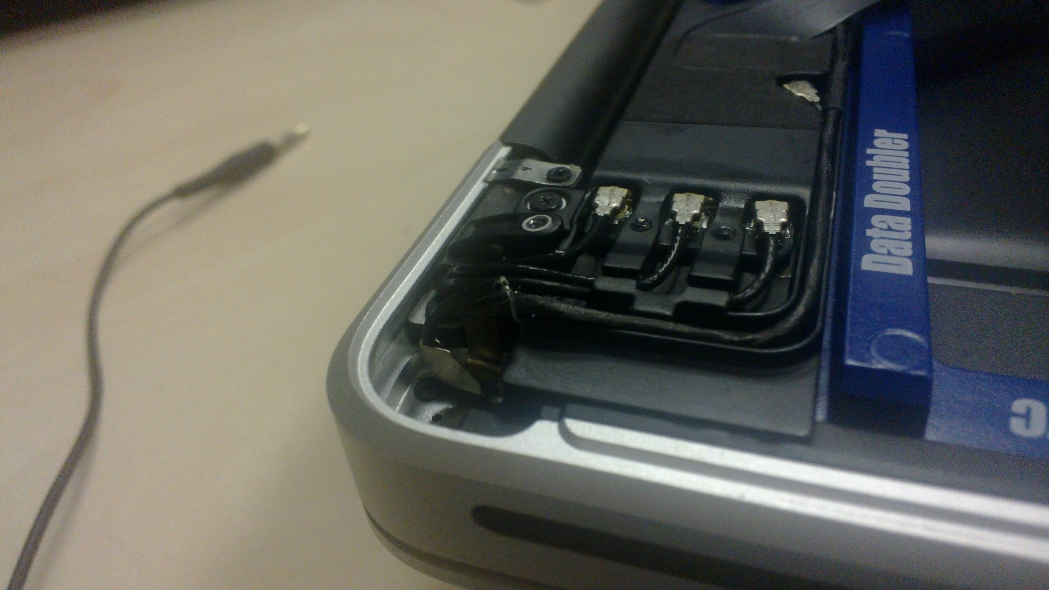

Yes, I managed to install it correctly. It required me to unscrew screws on the OWC, lift connectors - only after that I was able to secure SSD in place. Then I secured connectors on OWC device.
While I was doing that, I saw that I damaged one of the wires on the module near the edge of laptop (isolation went off - but wire is still connected).
Its the wire, that goes to a middle connector on that module. (see pic)
I checked my laptop - everything seems ok, but what wire have I broke, and is it dangerous?
Thanks

Not entirely sure what that corresponds to nor can I even tell where the damage you are speaking of is. I notice you said the middle wire, but it looks like the other two in the photograph.
In any case damaging internals is never good - may not necessarily be "dangerous" but you may notice some things not working. Hopefully someone with more knowledge that myself can comment on what that actually is as I am not to savvy with internals past the serviceable parts.
Those three cables are the antennas for the Wifi card. You'll likely see poorer reception, but there's nothing dangerous about it. Probably not worth fixing unless you really get bad reception after this.

and what about the fourth connector? what is it for?
i think i`ll just scotchtape it - since cable is intact, only isolation went off
thanks!
I think that's the Bluetooth antenna (the one that winds around further).
jW
since I have wifi & bluetooth both working fine, I will just apply isolation to that broken wire - and will live happily after 🙂
