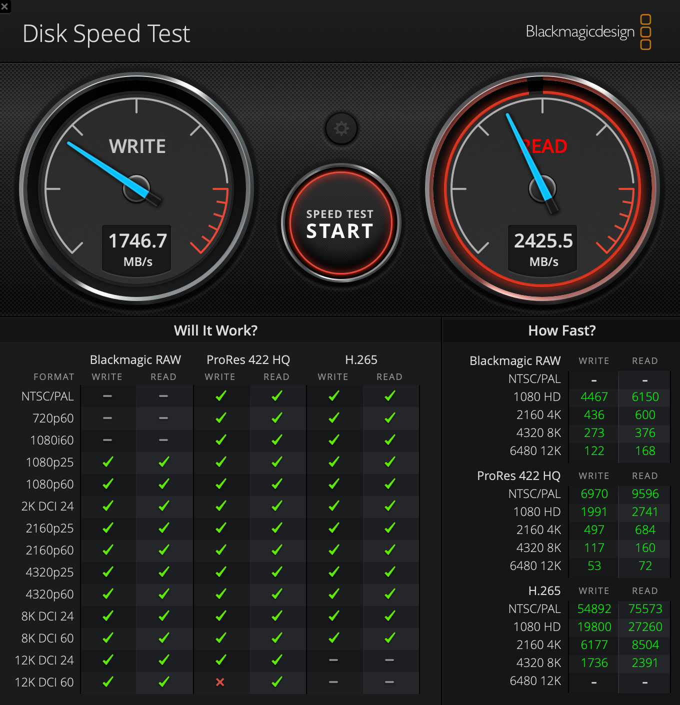

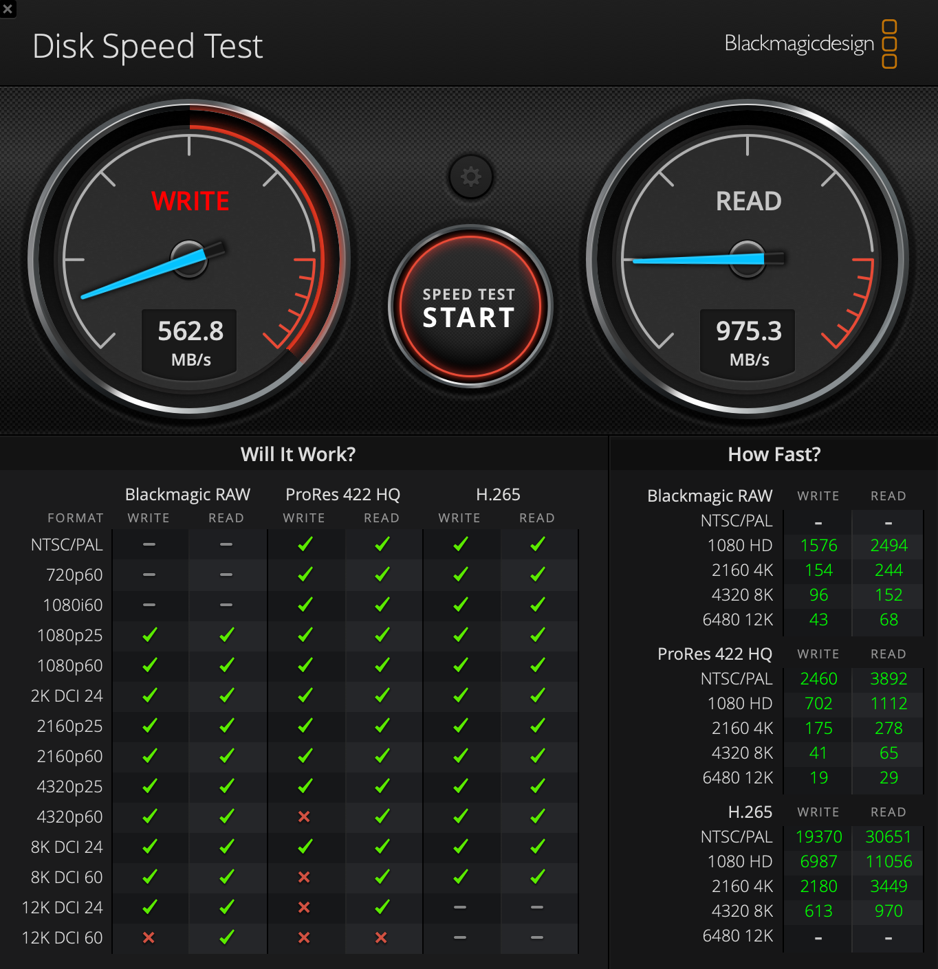

Title says it all. I have the 4M2. If I do an extended write session which I assume fills any caching, the write speeds slow down - which I expect. However, the read speeds also are cut in half. Upon unmounting, then mounting the drive again, read speeds return to normal. I expect the difference with the writes considering the drives are QLC, but why with the reads? Anyone else notice this behavior?
Note: speeds were also verified looking at activity monitor.
Note2: Drive had been in sleep for >12hrs after the write session
OWC Express 4M2 w/ 4x Crucial P3 2TB in RAID 0
Speeds after an 300 GB write session
Speeds after unmount/mount

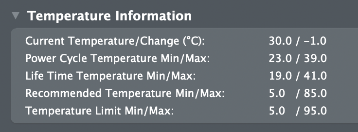

NVME, yes. But they get nowhere near close to temp to throttle (fan cooled, and don't run at max speed due to interfacing over thunderbolt: each drive can only max 700MB/s out of 3,000).
Also, this test was conducted over 12hrs after the extended write session, and therefore at their coolest operating temp.
A simple unmount/mount, with no other changes, resolved the issue.
