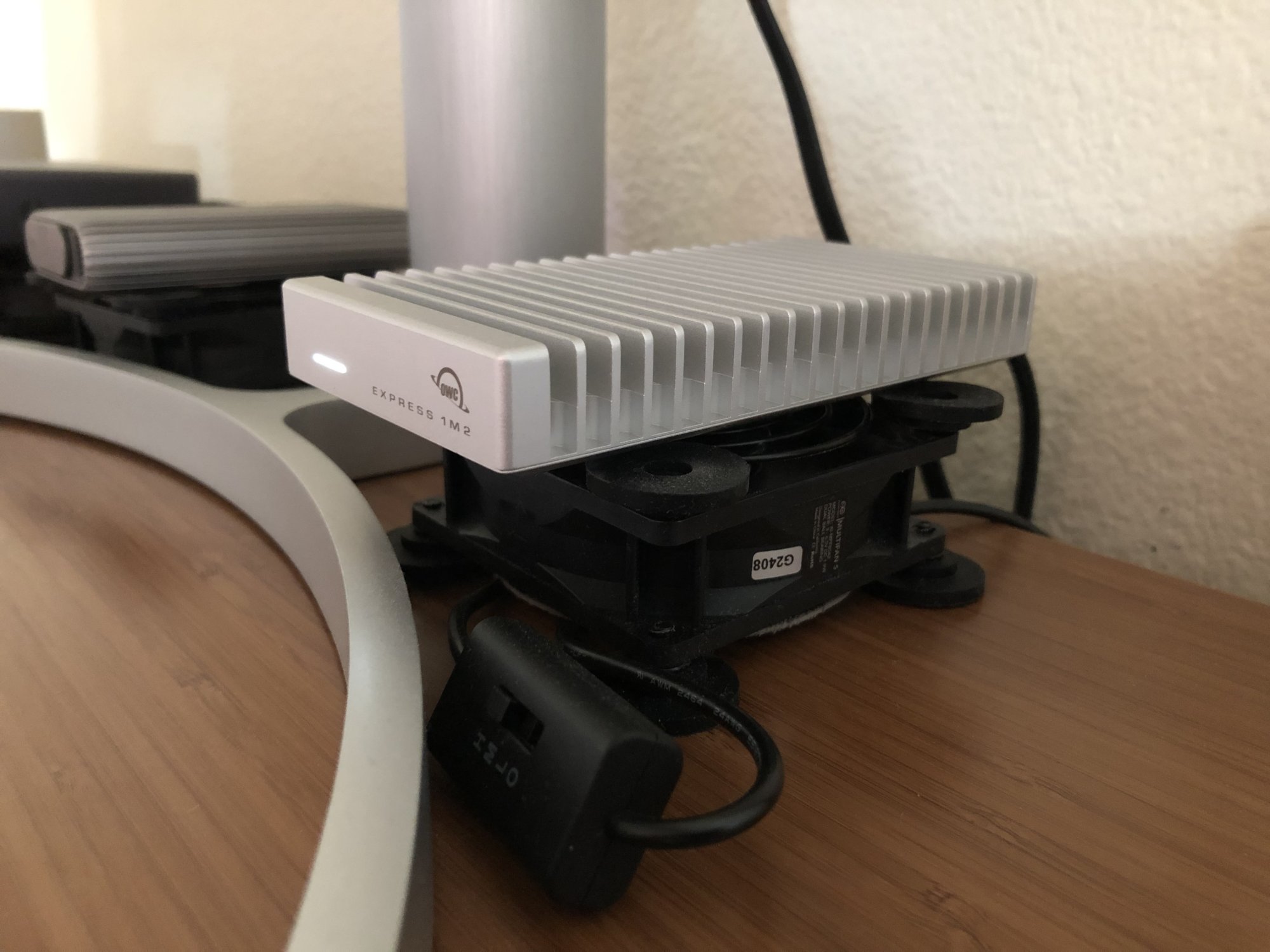

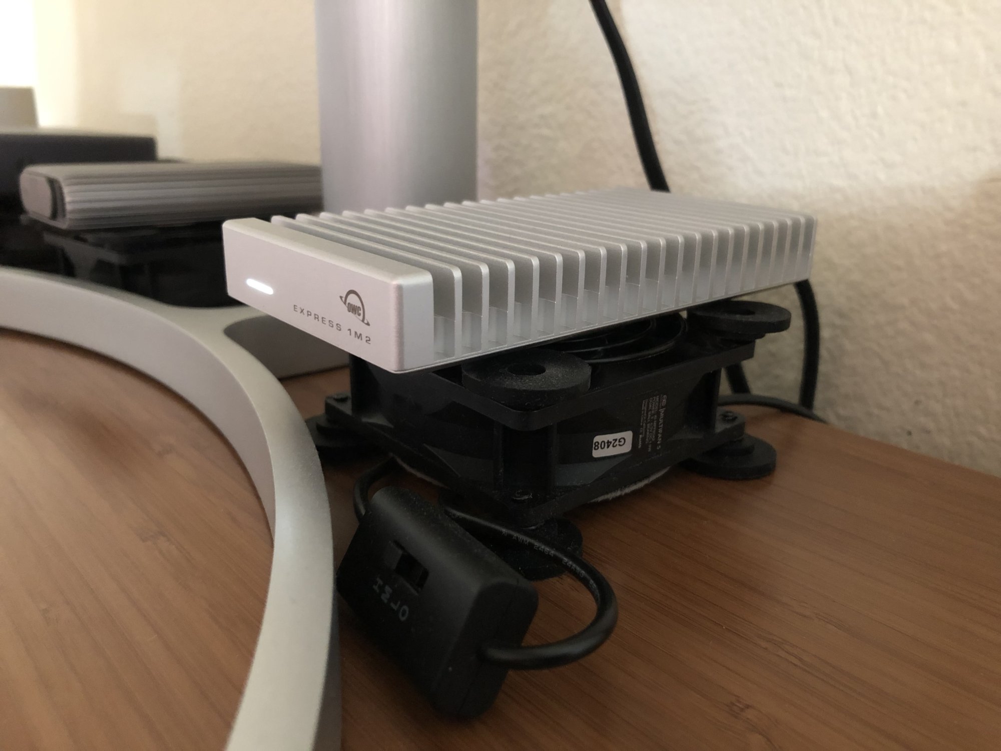

I have been using this portable USB fan to cool off both enclosures. I'm pretty happy with it. It keeps both cooler at least 10 degree.
