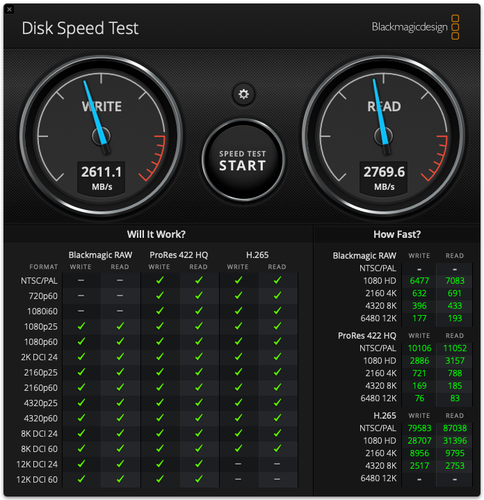

In addition, the WD SN770 (Temp) was shown to me the first time in iStat 7 and then never again, only Size.
At the end of the day I almost don't care, because I checked the external TB4 to be used as a boot drive option for the basic Mac Mini M4 on my MBA M2.
And there is no difference to run it from my internal 1TB, but it is a bit faster.
(measured when booted from)

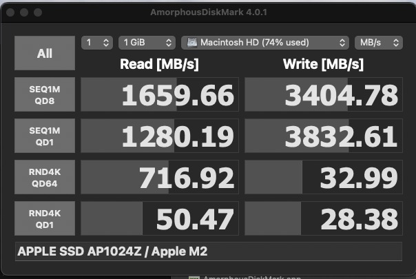

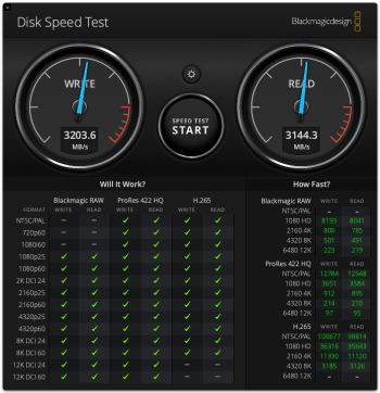

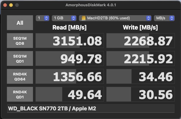

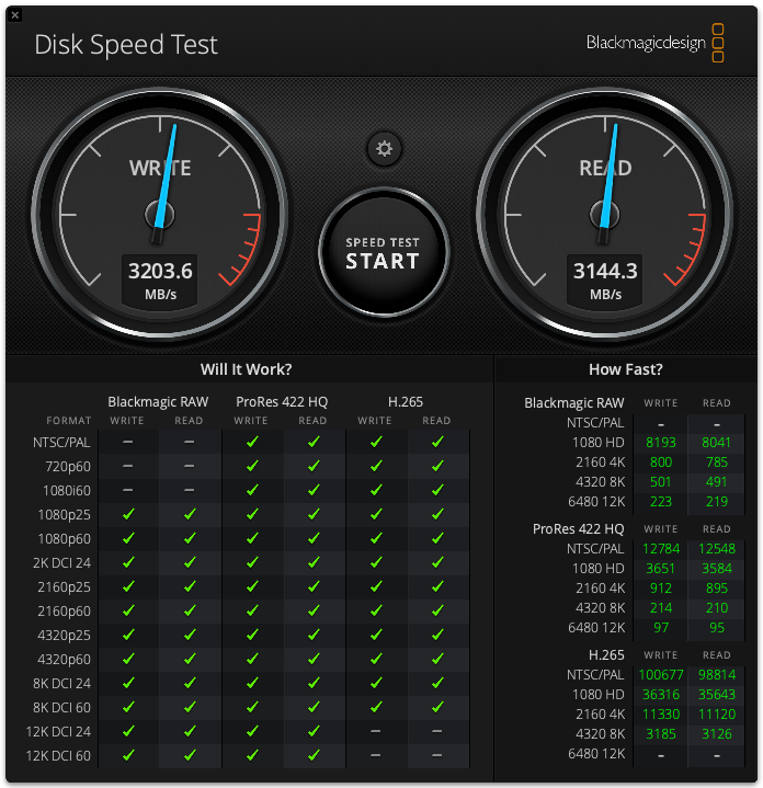

Whatever you say, it is faster with the external in any Situation on my MBA M2.
That could potentially also be a consequence from being less fragmented after imigrated to the external.
brew install --cask amorphousdiskmark
WD SN770 in Acasis TBU405 AIR while booted from.
MBA M2 Internal while booted from.

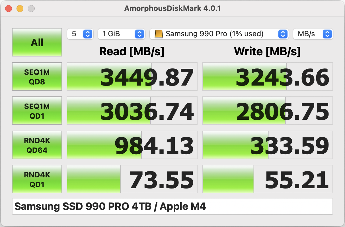

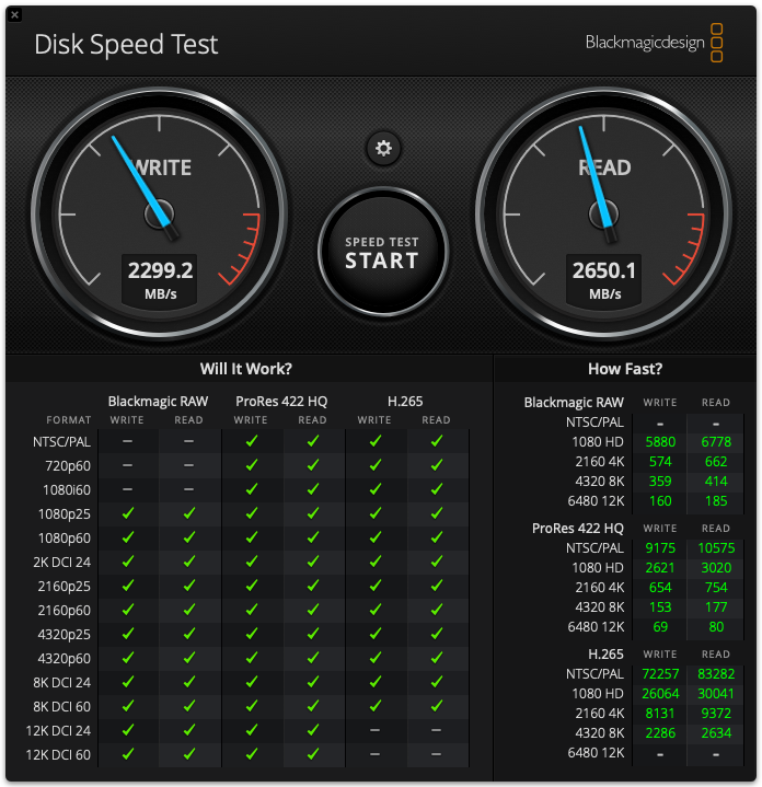

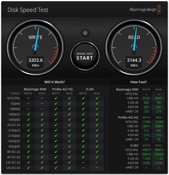

@EugW Which speeds are you getting with Colorii enclosure+990 Pro? (if it’s ok to ask)
Qwiizlab ES40UR + 4 TB Samsung 990 Pro:
BlackMagic_Samsung990Pro-extendedwrites.png Samsung SSD 990 PRO 4TB - Apple M4 - 4.png
Note though that most modern drives in these USB 4 enclosures will get over 3 GB/s for the sequential transfer speeds, so the bigger differences you'll see may be in the random read/writes.
