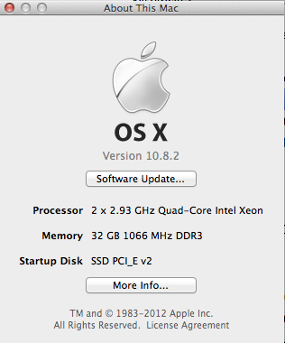

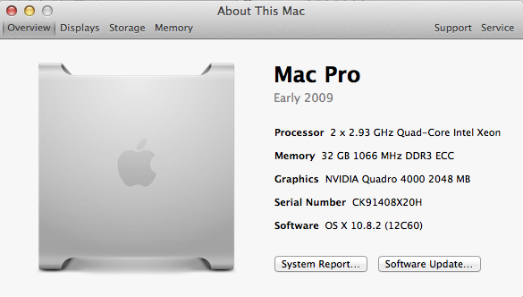

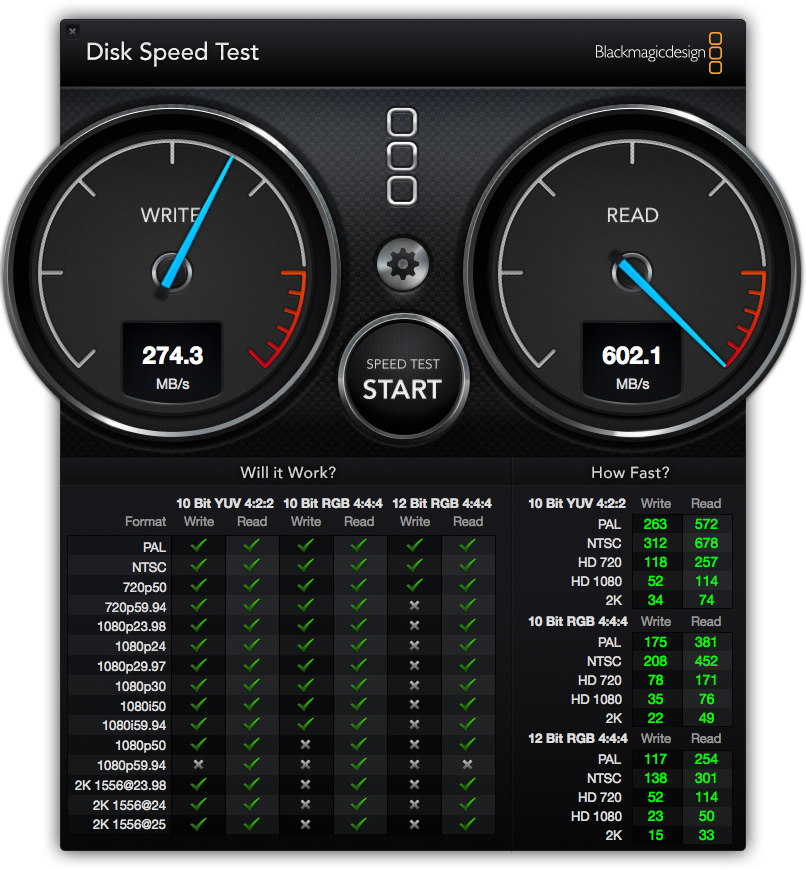

I think I have the same spec Mac Pro as you (with 32GB RAM) and have the 240Gb:
http://eshop.macsales.com/item/OWC/SSDPHW2R240/
Make sure you use the NEWER driver on the page I linked above.
In my opinion there seems to be some issue with stability. Apps start up fast which is great but I've have beachballing and and issue twice where the Boot HD needed reformatting. I think this was after I tried to sleep the comouter.
It just doesn't feel 100% right - although apps do start blindingly fast.
Please whatever you do backup/lone your boot drive regularly. I have a second SSD in the optical bay for this using Cronosync.
I'm not sure if my issues are the OWC Mercury Card or the RAID 5 I have set up at the same time (external drives).
I have included a Black MAgic speed text (not sure how to use AJA to test the boot speed). As a rough guide its about 10 secs boot time and Photoshop CS6 is ... let me test now...less than 2 seconds.
Any help I can give - please ask.
Screenshots attached.
Ged
