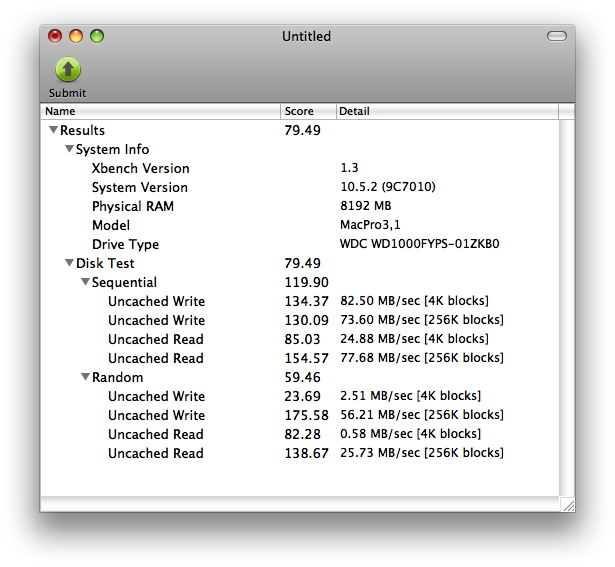

I just got my OWC Mercury Elite-AL Quad Interface (I guess it wasn't on backorder), the eSATA Extender, and the (1 Terabyte) Western Digital "Green Power" RE2-GP hard drive.
After about a 2hr installation (The eSATA Extender installation was a BlTCH, though, mainly because NewerTech didn't update their installation instructions to reflect the 2008 MPs and I lacked a proper screw driver, light and common sense 🙂 ), the external hard drive is up and running via eSATA and pushed through it's first TM backup with ease. What once took hours over a USB drive has been reduced to about 25mins.
Pros:
-No fan/No added noise
Cons:
-Though it can be disconnected, the blue power/activity light is a little bright/annoying.
-During the TM backup, the HD's temp hit 101 degrees and appears to be staying there. At idle, prior to the backup, it was around 90-94. Internal HDs are at 88 a piece (1x Samsung F1 750GB, 1x WD 320GB).
Other thoughts:
Even with a slower (by design) hard drive, it still outperformed the stock WD 320GB that came with the MP.
And to answer my own question from above; yes, you do need to power the drive on prior to powering up the Mac Pro.
