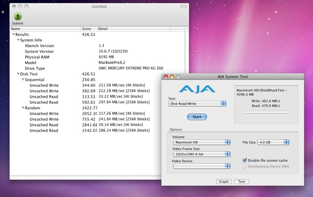

Here are mine:
(45% used)

Here are mine:
(45% used)

No worries, made the same mistake myself.
Just for comparison:
Write: 466.7 MB/s
Read: 481.2 MB/s

Hey guys, how do I get this AJA System Test to work? I just tried to run it on Lion to test my new OWC Mercury Extreme Pro 6G, but when I click "Start" it stops right the next second without performing any tests.
Why?
Btw, why am I getting ONLY 240 MB/s Write and 490 MB/s Read speeds on this drive?? (Blackmagic Disk Speed Test)
same problem ... no solution yet
Why?
Having the same low performance issue and AJA is not working in my early 201 MBP 15" with same specs.
I'm ramdomly having problems at starting the computer. Some times I get a folder icon with the question mark blinking.
I've installed all the updates (including the last EFI update) but nothing changes
Did you find a solution? Have you tried the ifixit hard drive sata cable?
I believe the test is incompatible with Lion.
Anyways, I've never experienced other issues you described, though.
It has to do with the low level permissions not be allowed in Lion. I forget exactly what I did to get it to work, but it involves changing the permissions on it to allow the writing to root, which by default is not allowed and not a good idea to do.
jon8, are you still getting ONLY 240 MB/s Write and 490 MB/s Read speeds on this drive with Blackmagic Disk Speed Test? the drive it's supposed to work at 500 MB/s speeds writing and reading
Black Magic is not a good measure of performance with the Sandforce drives, as it has been changed to measure based upon throughout with compressed data and the way it is handled differently with the Sandforce drives (this happened with the latest application update, even los of the manufacturer for Sandforce drives recommend testing with AJA as a baseline).. The AJA is the best tool for measuring Sandforce drives.
I haven't run it lately, but I'd assume it's not much different. This test is not good for Sandforce drives, as squeakr has mentioned.
On a different benchmark I ran, I got 450 MB/s write and 505 MB/s read speeds....
