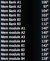

I have been wondering something about the OWC RAM I bought for my '08 MP. I got 8x2GB, and it's been working fine, so that's all good.
However, I have noticed in iStat Pro that the temps of the RAM cards in the bottom riser approach 165°F when I'm doing next to nothing. I then look at the riser sensors, and they're usually sitting around 110°F or so. Much lower, in other words.
I installed SMCFanControl, and have bumped up the CPU/Memory fan, and I can bring the temps on the DIMMs themselves down into a reasonable range, more like the 120-130°F or even lower if I really jack up the fan.
I don't really mind having the fan(s) spin faster, since the thing is so quiet anyway. Fans are cheap, computers are not.
But I do wonder if the heat fins on the OWC RAM are partially to blame. Seven's better than three, right? Well, I'm beginning to think not. Sure, if there's a lot of airflow, you can take advantage of the greater surface area. I wonder, though, if the fins are spaced so tightly that at the programmed fan speeds (based on the riser-based temp probes) there's not enough air moving around for the heat to dissipate. I wonder if the MP uses the riser probes (rather than the ones on the DIMMs) to determine how fast to spin the fans . . .
165°F seems awfully hot. I can bring the temp down, but only with SMCFanControl.
Does this make sense? Where is my thinking flawed?

Yes, once you have all 8 modules in all 8 slots there really isn't a lot of room for air circulation. I have all my 8 slots filled and I need to run SMC fan control continuously to keep the temps of Slot A 1 & 2 (my hottest) around 130F.
One easy thing you can try is to swap the modules from the upper riser to the lower and see if the temp. follows or stay the same. At first I thought mine were faulty too, but when I did a simple swap, temp on the upper (where it is hotter) is still the same. It makes sense, I have all 4 slots in the upper occupied. Only 2 in the lower.

Do you know what the fan speed of your MP is? The RAM temp looks a bit high.
I do not know the default values, but the fans are running at normal speed.
DIMMs don't even 'break a sweat' until they reach 190 degrees F, so I'm not worried about it. Running smcfancontrol to get more airflow through the machine does not outweigh the extra noise that it would cause.
Why do you think my RAM temps are high? What temperatures would satisfy you?
