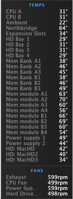

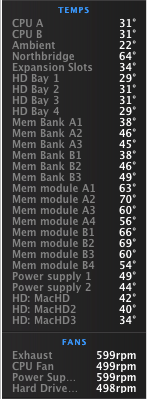

Attached are my temps right now, with the fans at the base settings (for the 2006 Mac Pro). I'm not doing anything intensive on the machine. As you can see my high temp dimms are A2 and B2 (both 2GB dimms).
It's really amazing that I can use smcFanControl to bump up the CPU fan to 710....and it will drop RAM temps from 70C down to 61C in about 10 minutes. I'm still shocked Apple hasn't allowed users to up their min fan speeds to keep the machine cool.
-Kevin

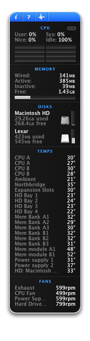

Looks about right. Not doing much, room in the low 20s C,
with stock Apple RAM (1GB + 1GB), iStat pro reports these
temperatures:
Curiously, I don't see what is obviously a GPU temperature in
that list. Is it possible to get the GPU numbers for a Mac Pro?

The reading for the "expansion" slot might be for the GPU. Also, is it the internal case ambient temp or the room temp?
