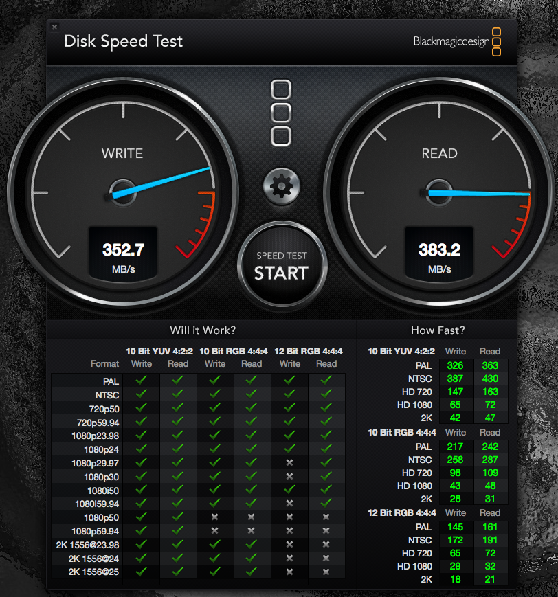

Picking up a late 2013 13" MBP for my wife recently had me curious as to my MBPs disk speed, as I was pretty impressed with hers at >600MB/sec, and the newer MBPs with > 1TB/sec read/write.
Current system is a early 2011 BTO, 2.3 GHz i7, 1680x1050 matte screen, now 16GB, and had replaced the 'primary' drive with an OWC Mercury Electra 6G 500GB SSD, + drive doubler + 1TB backup drive.
Besides when initially purchasing, I don't generally benchmark my laptops, especially if there's no known issue I'm chasing, but I went ahead and did so after seeing the 2013's SSD performance.
I'm not so thrilled with what I saw, but am at a loss as to the 'why', as third party older reviews seem to put the OWC and even the Samsungs (SATA 6Gb/sec bus) as relatively close 'enough' to each other, but I'm seeing only ~150MB/sec read and write speeds via Blackmagic, which isn't near saturating the interface.
BM is a somewhat 'unusual' disk benchmark - for apple to apple rough comparisons, it's fine - I'm just using the PAL scores for reference at 153MB/sec for both read and write.
I'm having a hard time believing that's the best it gets on the bus, as theoretical max for SATA III 6Gb/sec = ~ 6000000000/(8 * 1024000) = 732MB/second. No doubt rounding 'license' has been taken in manufacturers favor, but still ~600MB/sec should be achievable.
Anyone else have a similar system with the same drive for comparison?
Trying to sort if something's off here with my system, especially as if I decide to pass on the next MBP updates, I'll be looking to pick up a 1TB SSD to tide me over for a few. The system performs reasonably well, but this is curious..

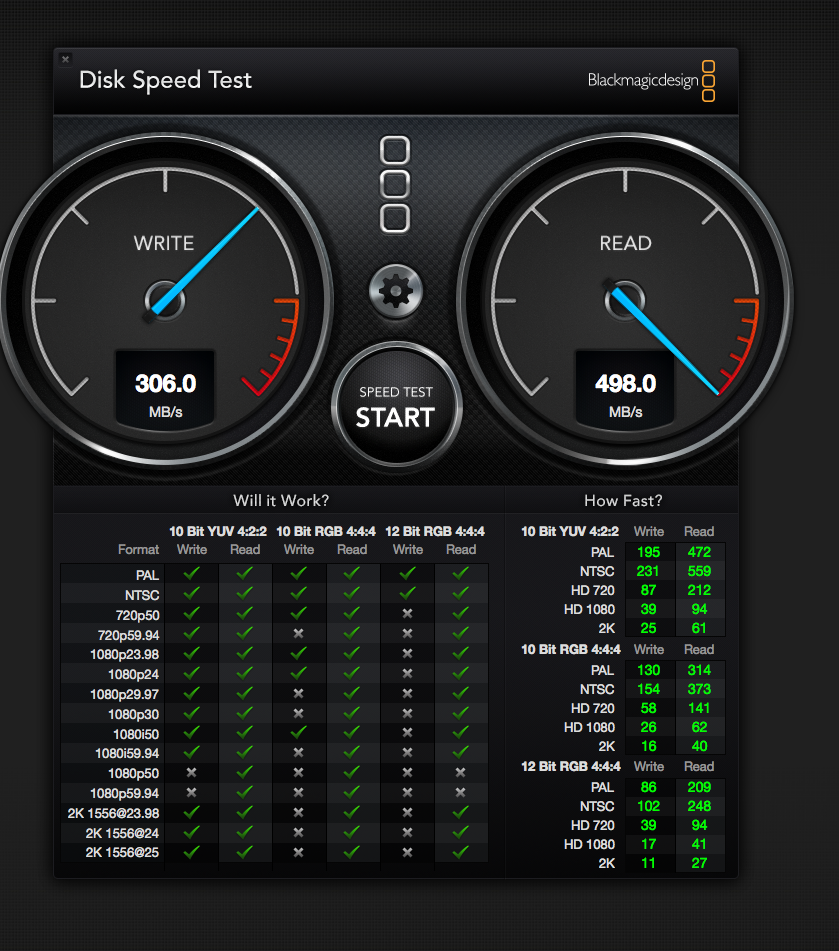

The below is what my Samsung 850 Pro achieves in my machine, which is pretty well identical to yours.
You are using the main drive bay and showing a negotiated link speed of 6 Gb/sec, right?
Yes to showing a negotiated 6Gb/sec connection, and using main drive bay for the SSD. I stopped keeping up on drive interfaces/keeping abreast of latest performance developments once I stopped purchasing hardware for work - thought it was ~600MB/sec or so but figured I'd do the math to keep myself honest. 😉
And yes, virtually identical system as yours. Hmm.
TRIM shouldn't matter all that much in speed, IMO, unless/until the drive has had a lot of file churn, but theres no difference with TRIM disabled or enabled either way.
Off a clean reboot, nothing running..just seems on the low side.

Here is my OWC SSD 6G under blackmagic running in my MBP 2011 2.5ghz, 17" :

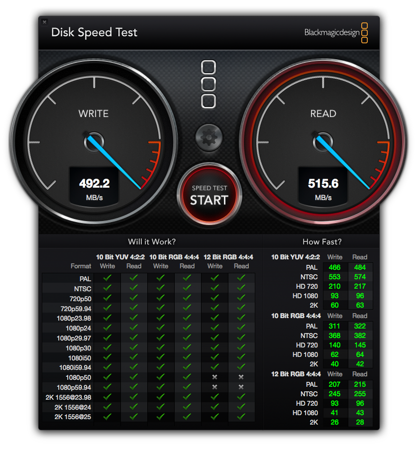

Either way, now 'resolved': (Samsung 850 EVO)

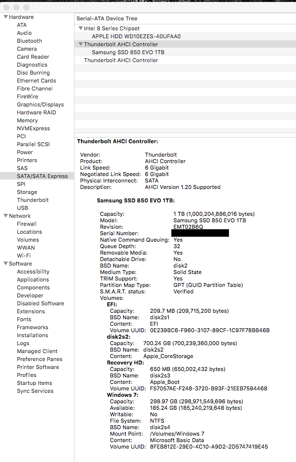

I just installed an 850 EVO drive in my Buffalo Ministation TB enclosure and my read/write speeds are quite slow compared to what the drive is capable of. I was just wondering if there is anything I can do to remedy this?

- I'm going to say it's most likely just due to the Thunderbolt chipset or SATA implementation in your Buffalo unit not being optimised properly.
