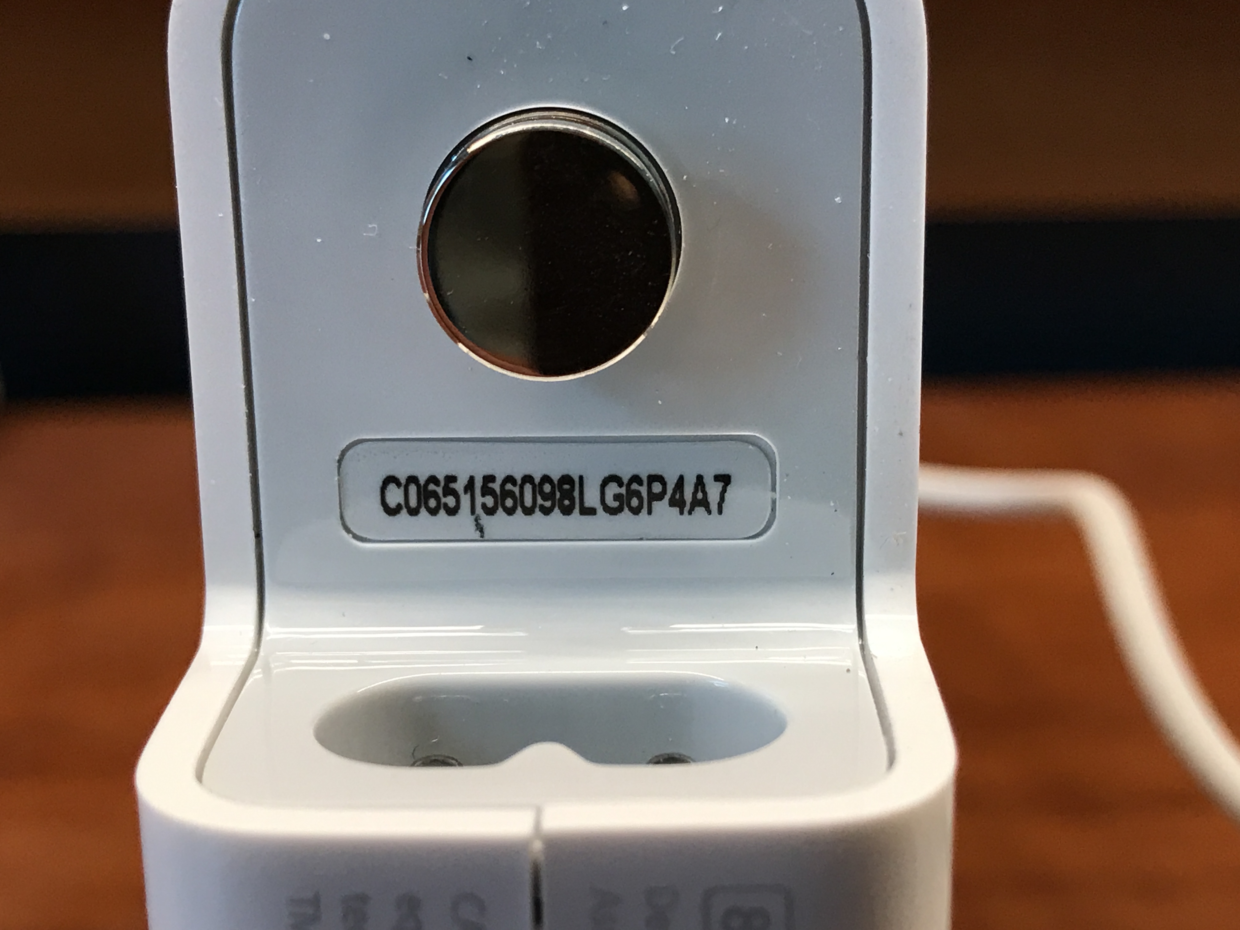

I just bought a MagSafe 2 from OWC at MacSales.com. I was immediately suspicions and did some testing:
-the green light comes on immediately upon plugging it in.
-the amber light (and likely green) stays on for half a second or so once it is unplugged
-the serial number sticker does not match the color of the charger
-the cord to the mac is thicker and smoother (I can measure with digital calipers later)
-the ID reported in System Profile is 0x0100
-the weight is 8.5oz vs 10.5oz of the original we have
We have dozens of Macs and this is the only one like this. I called Macsales.com and they said they get them directly from Apple and they are original. I am returning it and she said they would look into it.
Fake? Real?
Top is the original Apple charger. Bottom the OWC charger.
Note the serial number label and female plug. The label is a different color and there is a small lip on the plug (easier to see on the right).
I also have video of the light. I'll try and post that later.
The moulding looks a little off, that's usually the only external sign with these things. How much was it? If it was cheap then it's probably fake.
I'd advise you to take it into an Apple Store and have them confirm it for you, if it's fake stop using it as it could potentially cause damage. Otherwise return it and be done with it. Peace of mind is the most important thing and I'd be suspicious of the casing/behaviour of it.

It was $52 and from OWC, which I regarded as reputable. Not sure now. They said they get them directly from Apple. Not sure how that can be when all indications are this is a knock off.

The serial number isn't even on centred! And I see the pin socket has a pointy rather than rounded pin guide. The moulding on that section has injection overrun on the bevel. And the serial number appears to be of inferior ink, and has bled a little. The more I look at this thing the more there is wrong with it. Apple are so pedantic with QC this would never leave the factory (And judging by a few defects I'd be surprised if it was built by the same machines, it's pretty hard to get those defects once things are set up). 99% certain that's a fake.

I had one Apple employee look at it wasn't an official opinion, but he found at least five signs it's fake. Some mentioned here and others were:
-MagSafe plug is bigger
-sheathing on the cable is shorter
He also said Apple is very strict about things like this so it can't be a bad batch or different vendor.
Fakes are getting good. but they still don't have the fit/finish of a real one
Do fake chargers still not have the delay before the green LED comes on?
That is one of the most common and obvious signs. It indicates that the charger is not doing the system/safety check that the real ones do. This is why the fakes are potentially dangerous. They lack some of the internal hardware that has very real safety features to protect you and your equipment.

I took one glance at the photo and I knew it was fake. That metal stud is an electrical ground. Putting a date sticker on it would be like putting a QA sticker on a power plug prong.

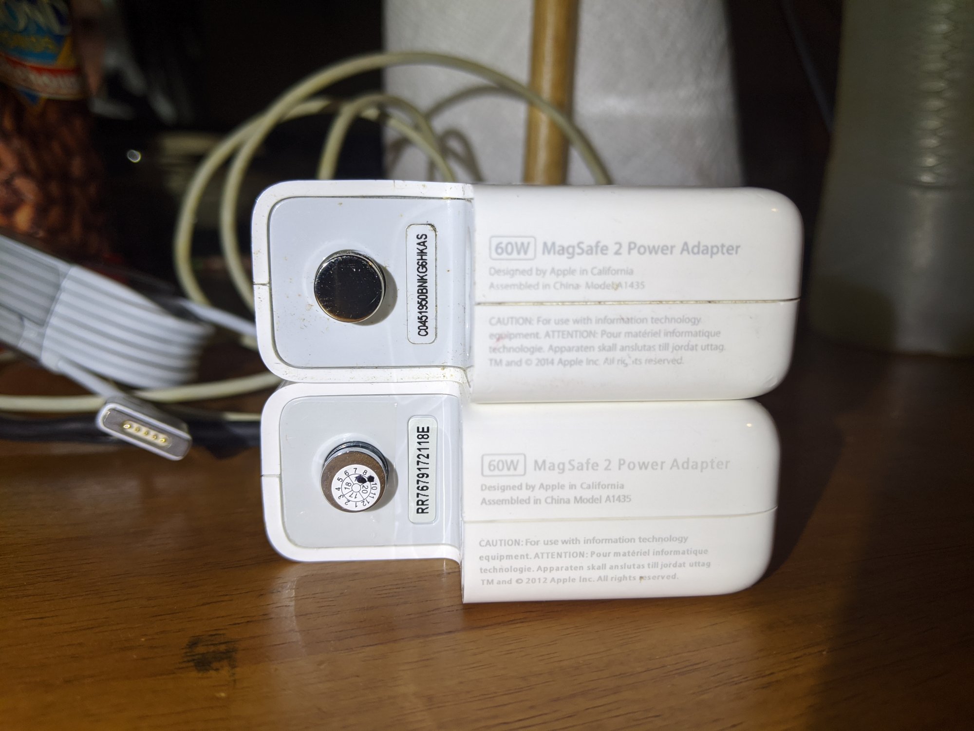

Hey guys, thought I might like to share my experience:
Bought a 60W MagSafe 2 from OWC. Arrived in the mail today. Here's a photo of that one alongside an OEM charger. Guess which one is OWC's?

Called them today to request a refund. Their response is standard RMA, I pay shipping. Not acceptable. I will be following up with a reversal from my bank, and I'd be happy to take this up with the proper authorities. Where can I direct my help?

they are not authentic. They have the Apple logo and markings that suggest Apple made/designed products. Talking with and in writing from OWC staff they claim 100% authentic and direct from Apple.
So pretty much these are the definition of counterfeit.

Apple would NEVER use the font in the caution statement on the bottom one.
And on that note, the font looks like it changes starting with the second line.
