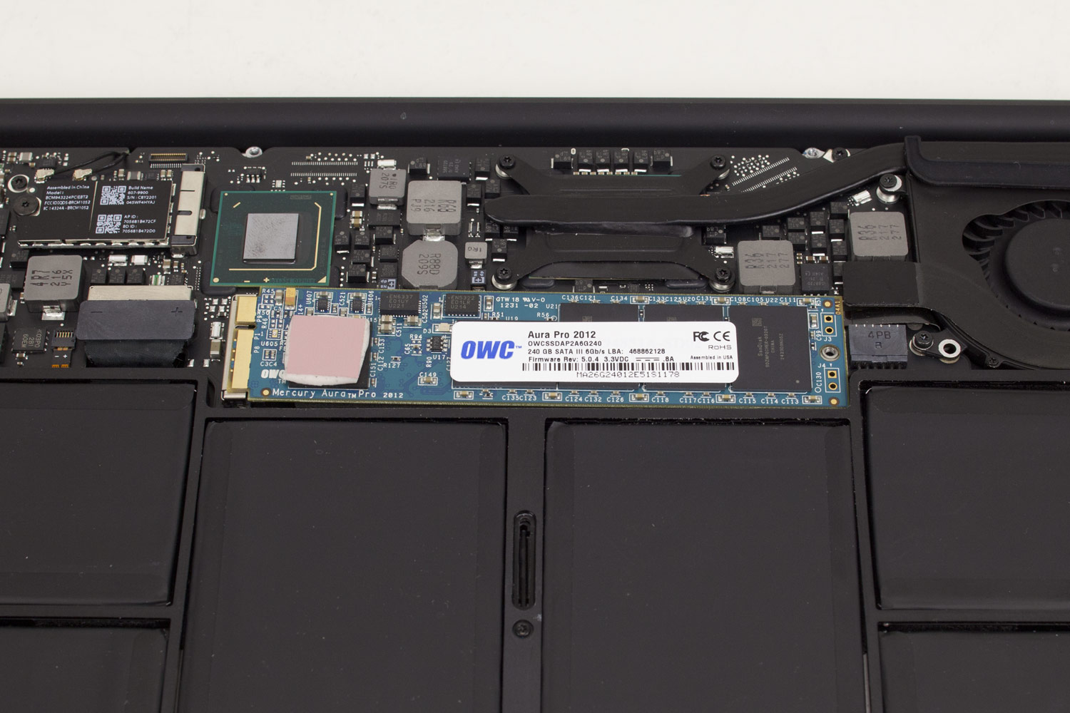

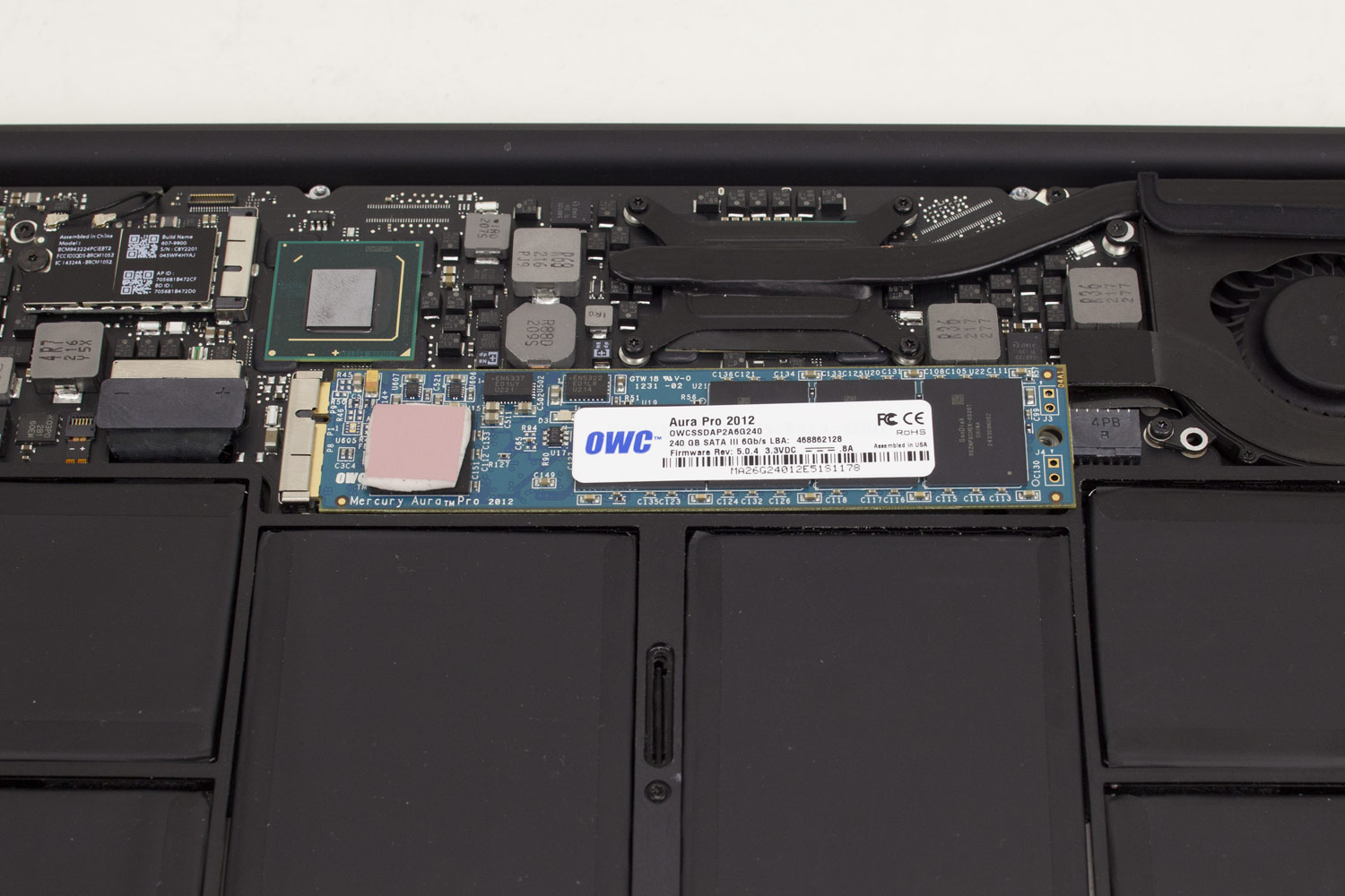

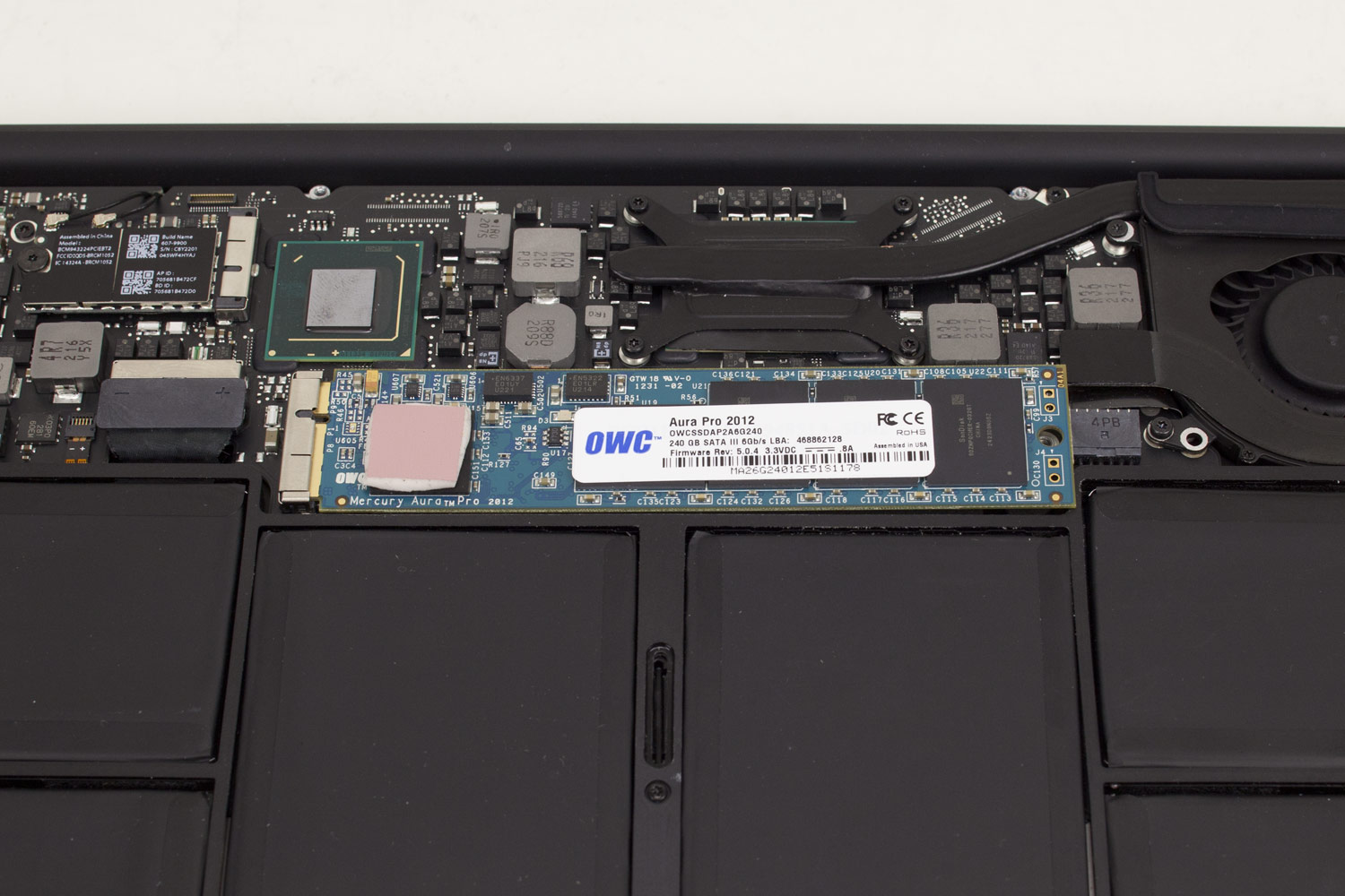

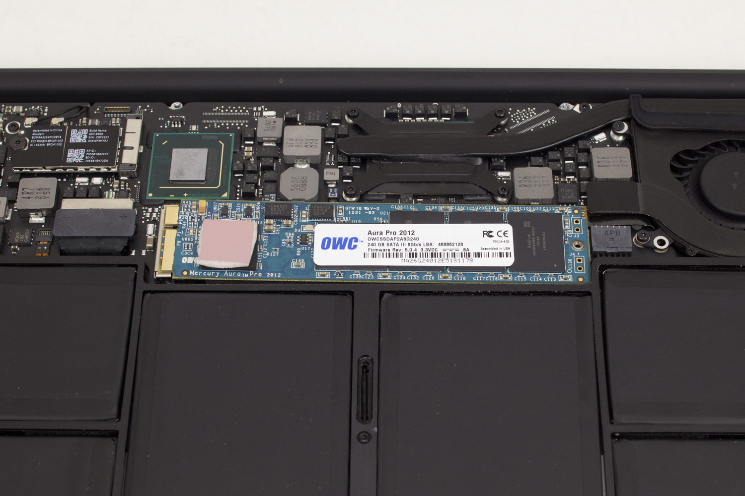

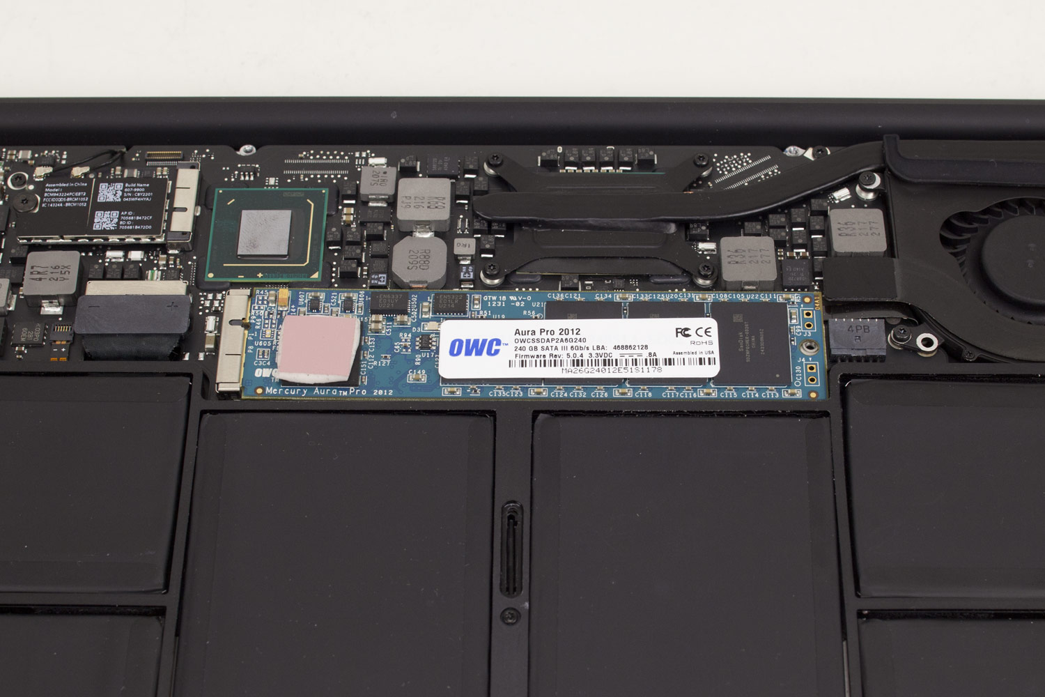

On the Aura Pro fit concern, we took a new from inventory Aura Pro SSD for the 2012 MacBook Air and installed it into one of our machines to replicate a current, in the field install. As the attached picture #4572 shows, it does indeed fit.

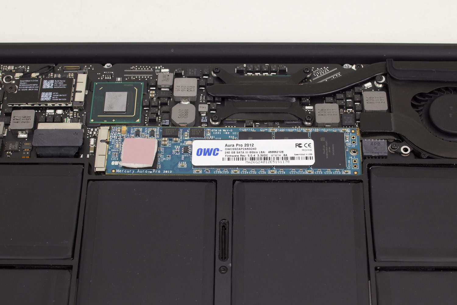

As the next picture (#4574) shows, if the SSD module is not pushed completely into the Air's drive connector, the Aura module will appear to be too long as you and several forum members have experienced.
To visual confirm proper board length relative to the connector, we placed the Aura module on top of the connector and the attached picture #4576 shows everything lines up and should fit properly.
But regardless of it working here, if our customers are not satisfied with the fit, we have taken immediate steps to provide additional clearance of the Aura Pro module so that any installation difficulties of a tight fit are alleviated.

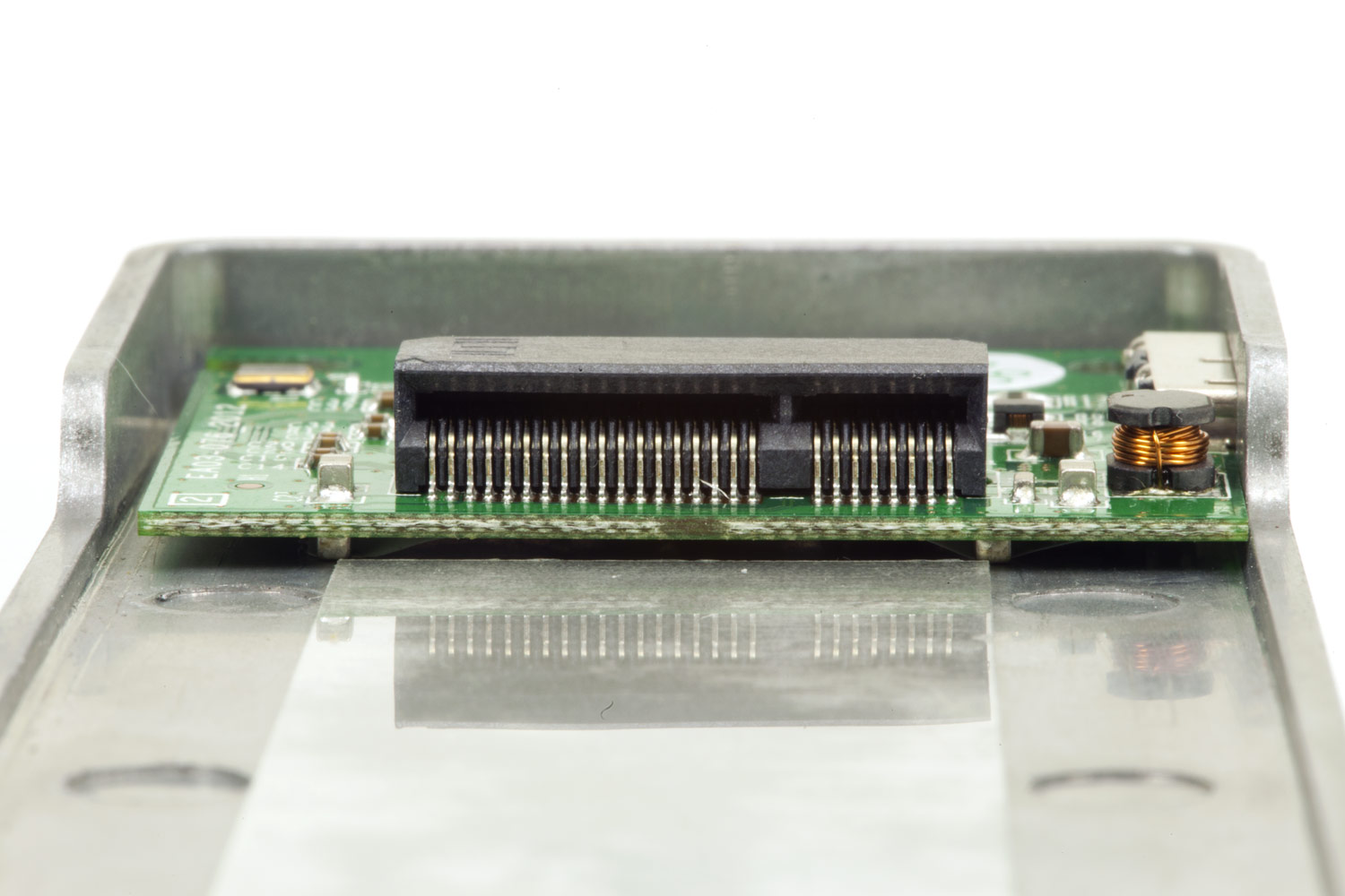

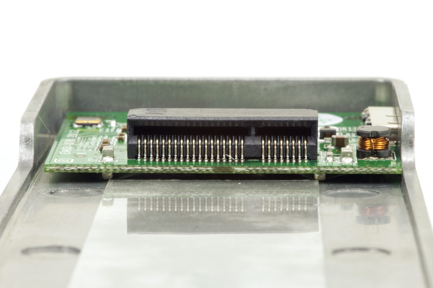

On the Envoy design, when the case is not closed and properly tightened down by the two screws, it does appear - and as our picture #4582 shows - the resistors could make contact with the Envoy housing right where the mylar insulation strip ends.
What's not apparent is that the internal posts of the housing create a lift of the board when the two halves of the enclosure are assembled and fastened together. It is impossible to provide an internal picture of such. However, to prevent any concern over the resistors touching, even if the Envoy is used outside of its expected assembly requirements, we are installing additional mylar insulation to the housing to alleviate any concerns of resistor contact. It is worth noting the 2012 Envoy design is nearly identical to the 2010-2011 design which has had thousands shipped without a return related to this concern. Additionally, we just began shipping the 2012 Envoy two weeks ago and have not to date had one returned. Again, though, customer satisfaction and confidence are our primary objective and we feel this additional insulation resolves the matter.
We do greatly appreciate you bringing your concerns to our attention and trust our immediate consideration and modifications meet with your satisfaction. I understand our customer service team is working directly with you to ensure your complete satisfaction.
Ok, so you tested a single drive and it fit. I tested a single drive and it didn't. A sample size of 1 is not a large enough sample for you to say they're all OK.
But, beside that point, no, mine did not fit. I placed mine on top of the connector as well, and it looked like it would fit (there is no way you can eyeball a 1mm difference over the 6cm? length of the SSD). Also, I checked from the part where the connect meets the rest of the PCB (the little shoulder thing) butted up against the connector in the computer, and the other end of the SSD cleared the battery. No eyeballing there, and that supports my theory that the v-groove on the end of the connector is the primary issue.
OK, this is where you piss me off. That is a flat out lie. A few of that, actually. First, an easy one: you did not begin shipping the 2012 Envoy two weeks ago. I ordered it the first day I saw it was available, which was the 23rd of Dec. I was checking fairly often, I know it was not available on the 21st of Dec. That's 1 week ago, and you weren't shipping it then. (here's a comment from OWC Michael on the blog that proves it wasn't for sale on the 19th: http://blog.macsales.com/14528-owc-...for-all-2012-macbook-air-models#comment-61965 ) Lie number 1.
second, those are capactiors, not resistors. You don't have 2 large resistors like that from 3v3 to ground. I called them capacitors, but you somehow switched to resistors? Why? Do you know what you are talking about?
Third, those capacitors missed the insulation by a couple mm. It's not a small thing. If you look at the pictures I posted, you can see the insulation is barely wide enough to even span between the two capacitors, and doesn't even cover all of them (you can see this in your picture). But it was off by a couple mm in the other direction (the long dimension of the case).
The second lie is that my screws weren't tight enough. (If I had gone any tighter, I probably would've stripped the screws or screwdriver, because of the relatively large size tolerances of at least one of those) Look at how the board mounts: the board is on angle, and when you put the cover on, it pushes those caps toward the housing (because of how the SSD is mounted).
The additional insulation does not resolve the matter, that is my crappy stopgap solution that I can do in 30 seconds so my drive at least works minimally. That is not a professional solution by any means.

And right you are, those contact points on the Envoy are actually ceramic capacitors and not resistors. I do apologize for the terminology mix up. But again, the resolution we've proposed...and to be clear....the mylar insulation will cover the width area as well, thus preventing any possibility of those capacitors from making contact with the metal housing.
That's not technically asscusing me of anything, but you are trying to imply that the screws weren't properly tightened down.
Keep in mind I had this issue with a fully closed and screwed together case.
Here is another picture: http://i.imgur.com/yYQSR.jpg
That's of my electrical tape solution after 1 day. You can clearly see the indentations from the capacitors on it (on the left there are 2, you get both ends of the cap. On the right, there's just one, and that's only the 3v3 side of the cap).
You can see that there is a fair amount of pressure on that when the whole thing is closed up and screwed down properly, and how easy it would be for those caps to touch the metal housing when it is screwed down properly. This is why simply adding insulation (and the mylar insulation in there is thicker and less flexible than the electrical tape I used) is not a sufficient solution.
Also, I have no doubts that you can put in mylar wide enough, I was saying that the mylar that is currently in mine is not wide enough to cover both capacitors entirely

I think its important to clarify not fitting versus tight fit. Since some time has lapsed since first replying to this thread, only 10 modules have been returned to us as not being able to fit. Of those, upon investigation, only 2 were deemed to be too thick to fit regardless of pressure used to install. Hope you can appreciate can't divulge the number sold for business reasons...but just two is an incredibly low number to be deemed truly defective based on physical characteristics.
With any custom designed module, there is going to be +/- variances. This is not a matter of deficient QC...this a matter of expectations for a fit that perhaps are unfounded.
Regarding the worry about damaging machine by applying too much pressure during module install...can only share what we know...in that we have not done such ourselves nor been informed of such out in the field.
Come on guys....from day one nearly 25 years ago, OWC has been about honesty, integrity, transparency. Not likely at this stage we're going to offer a product that will damage your machine.
Can I say 100% of all Auras will fit? Can't based on production variances. But can say for certain that we're QCing these even more so to prevent even those two referenced above from getting into a customer's hands.
