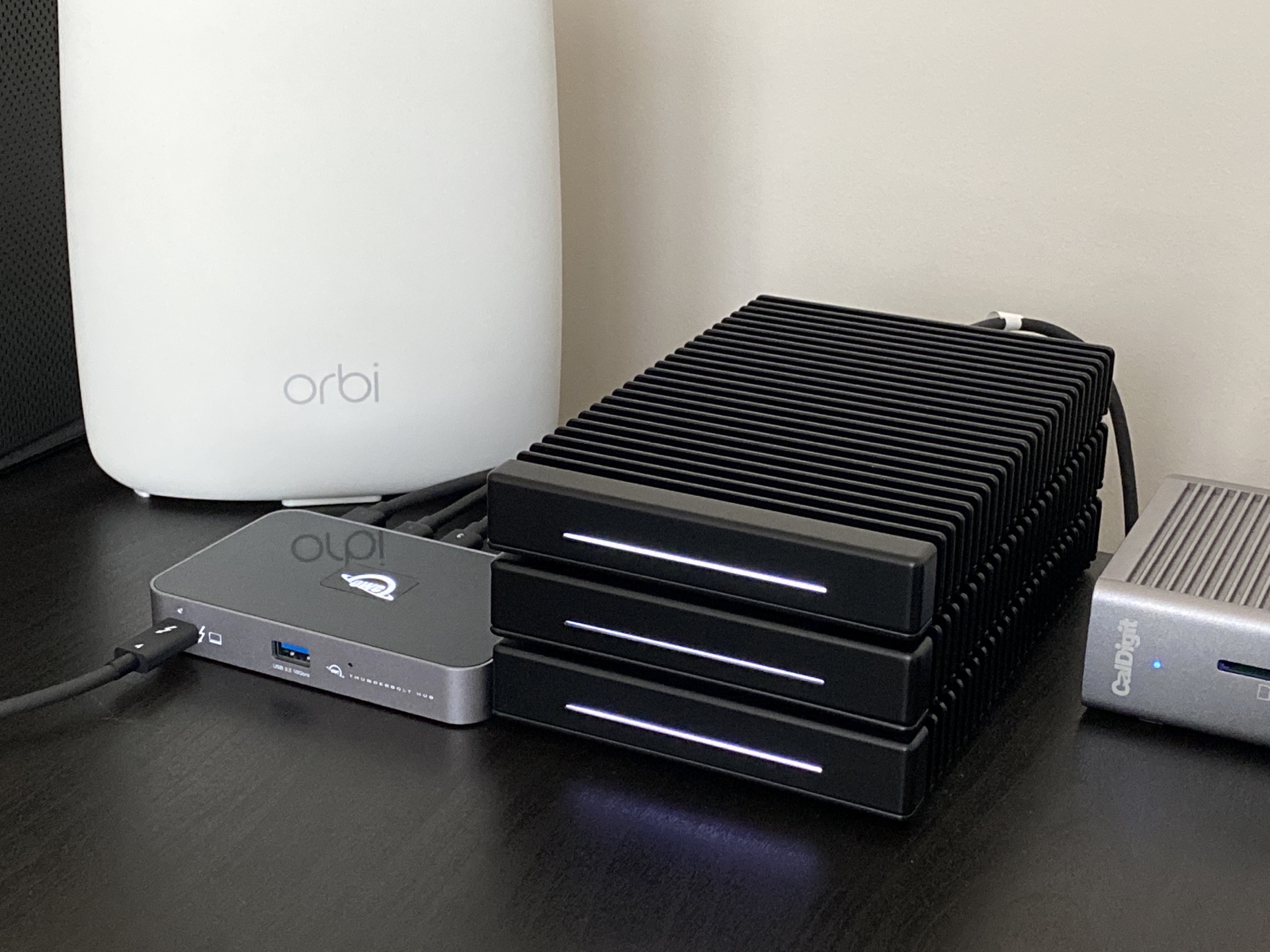

I have the OWC Thunderbolt 4 Hub connected to my MBP16. I use i to connect 3 OWC Thunderblade V4 drives to the one port on my MBP.
The hub will also provide 60w of power to the connected system - hence why it doesn't 'sleep'. When used with a notebook, you can close the lid for it to sleep and the system will continue to charge etc. I don't think its a 'problem' - I think its supposed to stay on by design.....
I haven't come across many docs or hubs that go to sleep - my CalDigit TS3+ does the same thing.
I only use my Thunderblade drives while editing - so I usually unplug the hub when its not in use anyways.
First thing I did was to turn down that ultra-bright light on the top though!! lol

Sweet looking drives you have there!

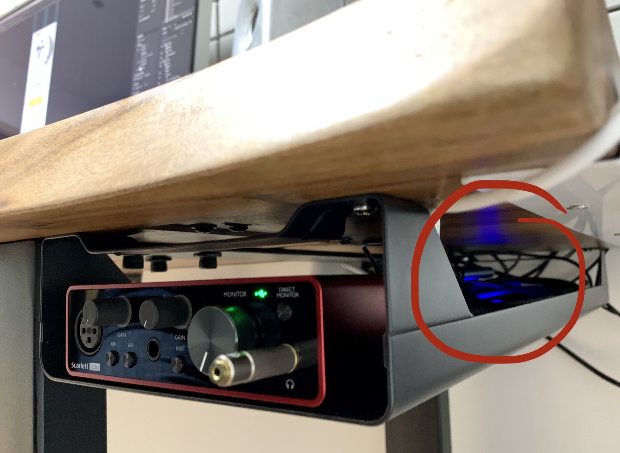

Nice setup! Yes, that light is annoying. I have my hub hidden under the table 👍
