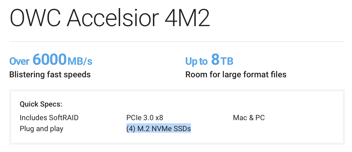

The ONLY way they can achieve those maximum advertised speeds is with RAID involved. No commercially available single blade can hit 6000MB/s.
Not sure for their specific blades, but most are rated around 1/2 that speed at theoretical maximum.
Samsung 970 PRO NVMe are rated at 3,500MB/s read and 2,700MB/s write.
Samsung 970 EVO NVMe are rated at 3,400MB/s read and 2,300MB/s write.
Samsung 960 PRO NVMe are rated at 3,500 MB/s read and 2,100 MB/s write.
Samsung 960 EVO NVMe are rated at 3,200 MB/s read and 1,900 MB/s write.
The NOT YET AVAILABLE 980 PRO is currently rated at 6500 MB/s read and 5000 MB/s write, but is a PCIe 4.0 device. Unsure what impact/hit would be with PCIe 3.0 adapter. Samsung says more information will be available in Q2 2020.
