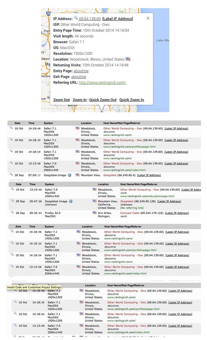

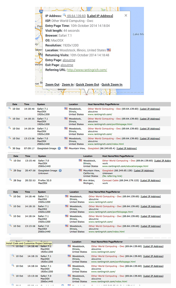

BIZARE Event
In a BIZARE twist to all this OWC is apparently very interested in me and my website. Now I never told OWC what or if I had a website. I wonder why they are paying so much attention to my website
... taking the thread a whole new direction, you can add me to your website visitors. :roll eyes:
