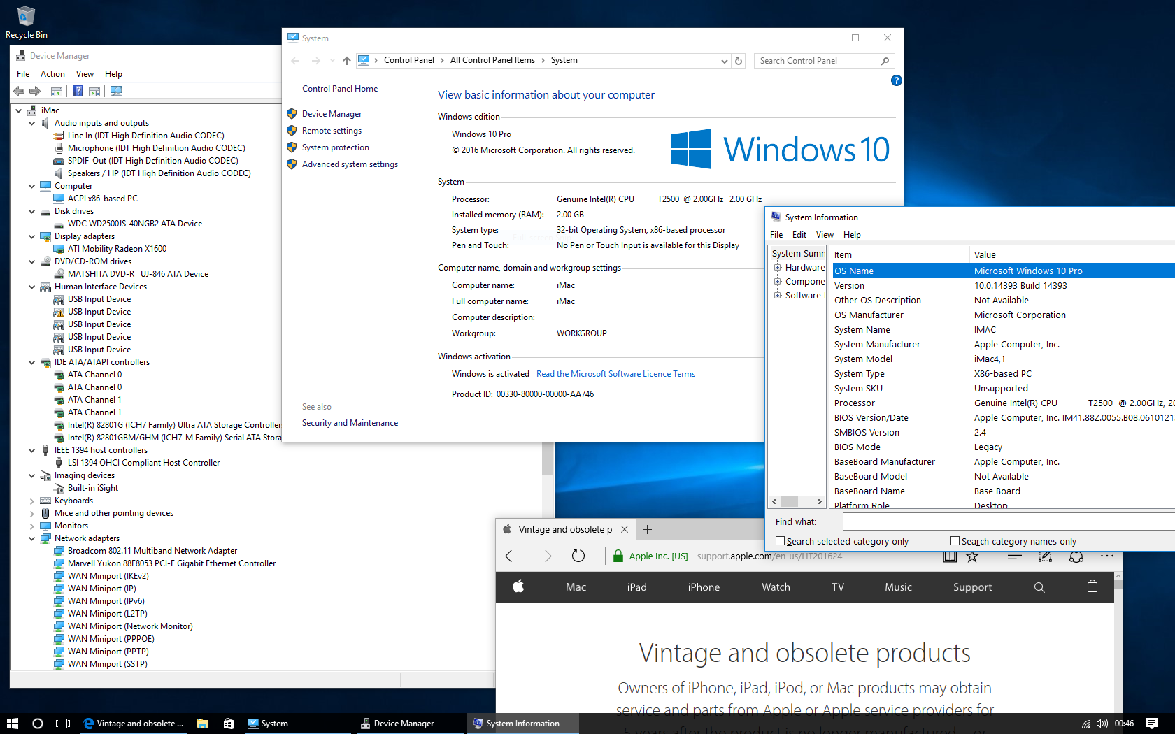

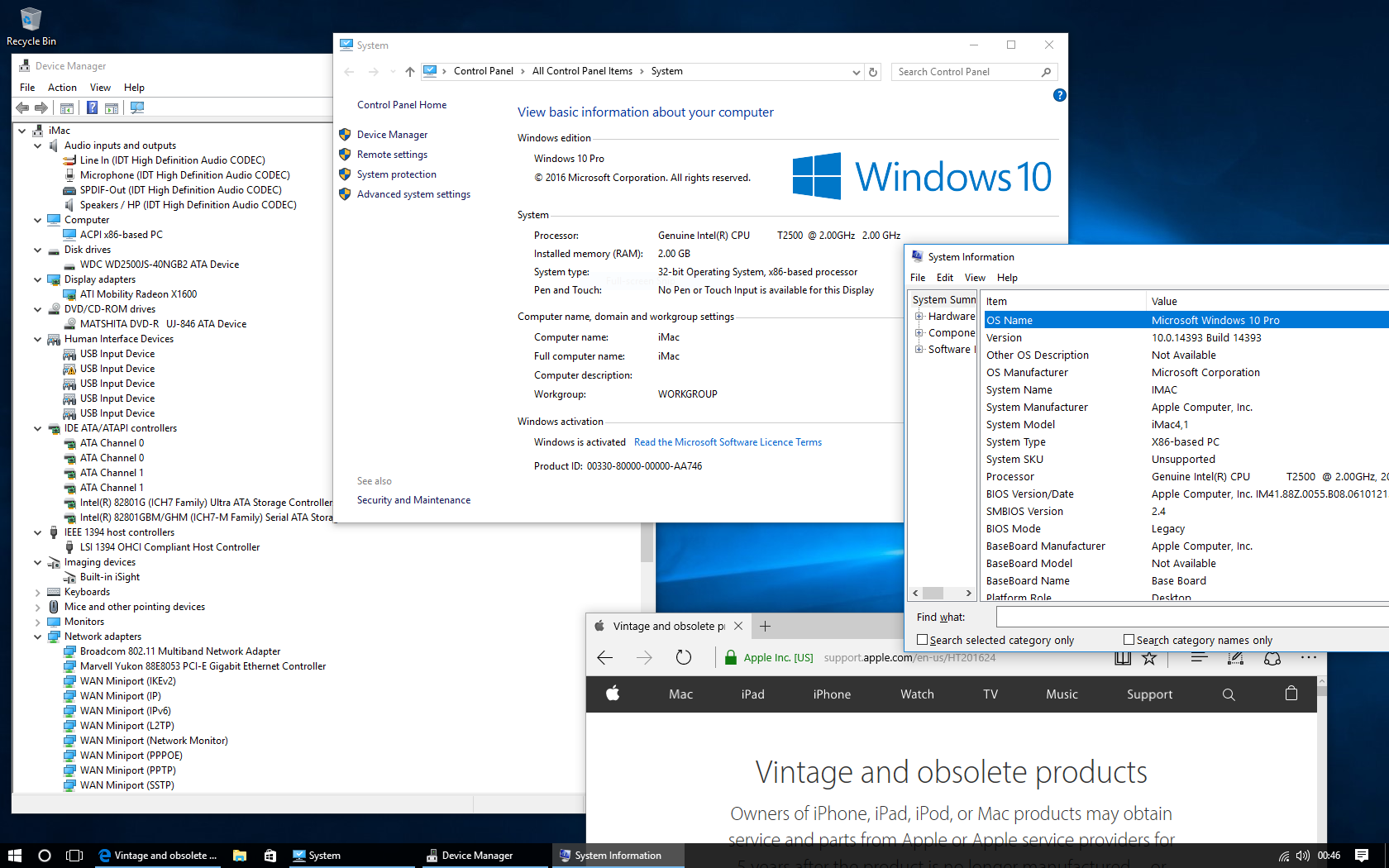

This may or may not be of interest to you all, but I found that you can indeed run the very latest Windows 10 on the first-generation Intel systems (I tested this on an Early 2006 iMac i.e. the very first Intel Mac to ship, but should be similar on the others). Considering the latest Apple OS that can run on them will soon be 7 versions behind the latest it is interesting that Microsoft's effort not only runs, but runs pretty well and they make surprisingly good PCs for next to no cost these days.
Officially Apple only supported XP and Vista on them - 7 installs fine without any messing around, but the 10 DVD fails to boot with a "select CD-ROM boot type" screen that you can't get past. However these steps which are intended for getting 64-bit versions of Windows to run on EFI32 Mac Pros work, only difference being that you obviously need to use the 32-bit version for the Core Duo systems: https://forums.macrumors.com/threads/installing-windows-7-10-x64-on-mac-pro-1-1-2-1.2037620 Drivers intended for Windows 7 generally work.

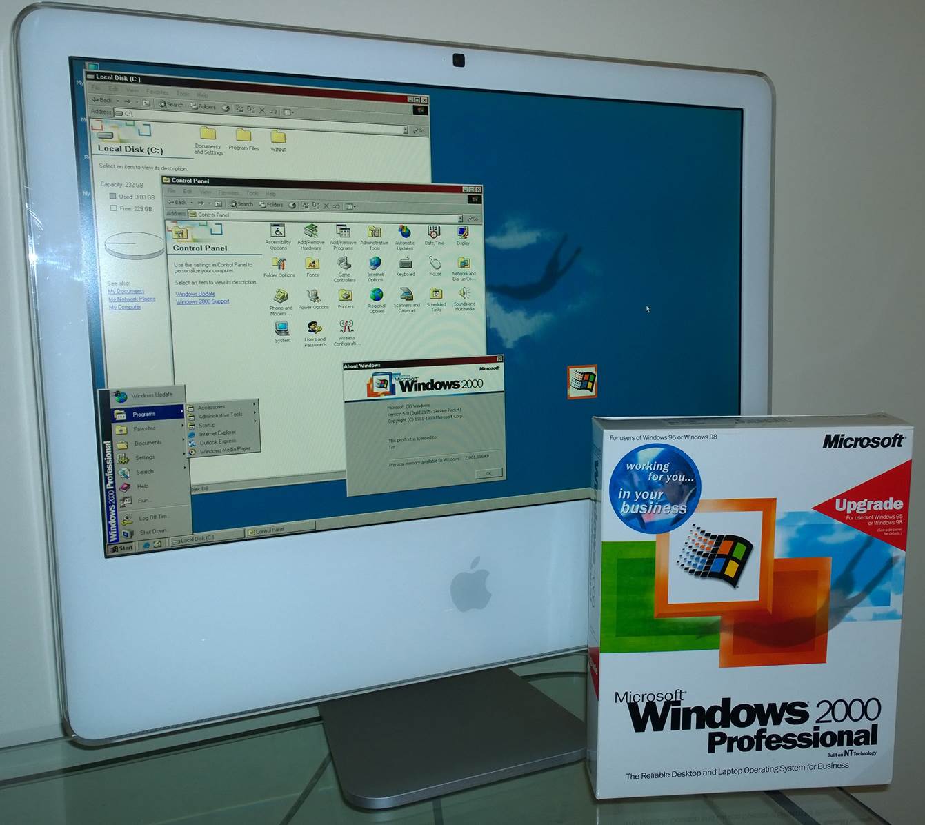

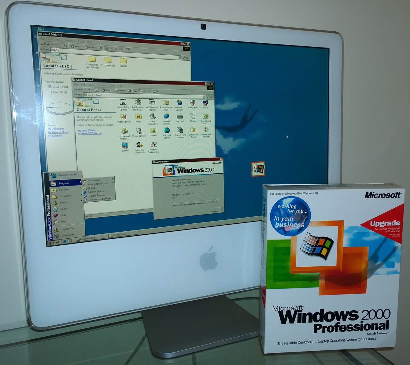

Going the other way, you can also run Windows 2000 on an early Intel Mac which is interesting to see given that only XP was ever supported and a Mac running 2000 looks a little...unusual! You just have to make a slight modification to your 2000 disc: https://forums.macrumors.com/threads/windows-2000-install-success.202695/
Of course, really the Early 2006 iMac needs to run Tiger 10.4.4, given that it is the only machine that can run the very first official release of OS X for Intel 😉

quite cool to see windows 2K running on the iMac, its something iv been meaning to play with/try and do my self 🙂 going to have to drag the MacBook2,1 out heh

What's Win10 performance on the iMac like? I've installed it on a few low end laptops for people and it performs great.
Pretty decent! The slow hard drives that Apple still ship to this day don't help of course, I'm sure if you were willing to open it up and replace it with an SSD that would make it much faster, and the graphics card is weak, but they make a decent PC as long as you don't expect *too* much from them 🙂 By the way I had a glitch with the graphics driver (presumably due to it not being an actual Windows 10 one), if you find that you can't see the desktop when it starts up press Win+P to change the display mode until you see it, then go to Control Panel > Power Options > Change what the power button does > untick Fast Startup - otherwise it thinks there are two displays connected for some reason and defaults to the non-existent one.
Yes, it does that on the laptops I installed it on too - easy fix though.
