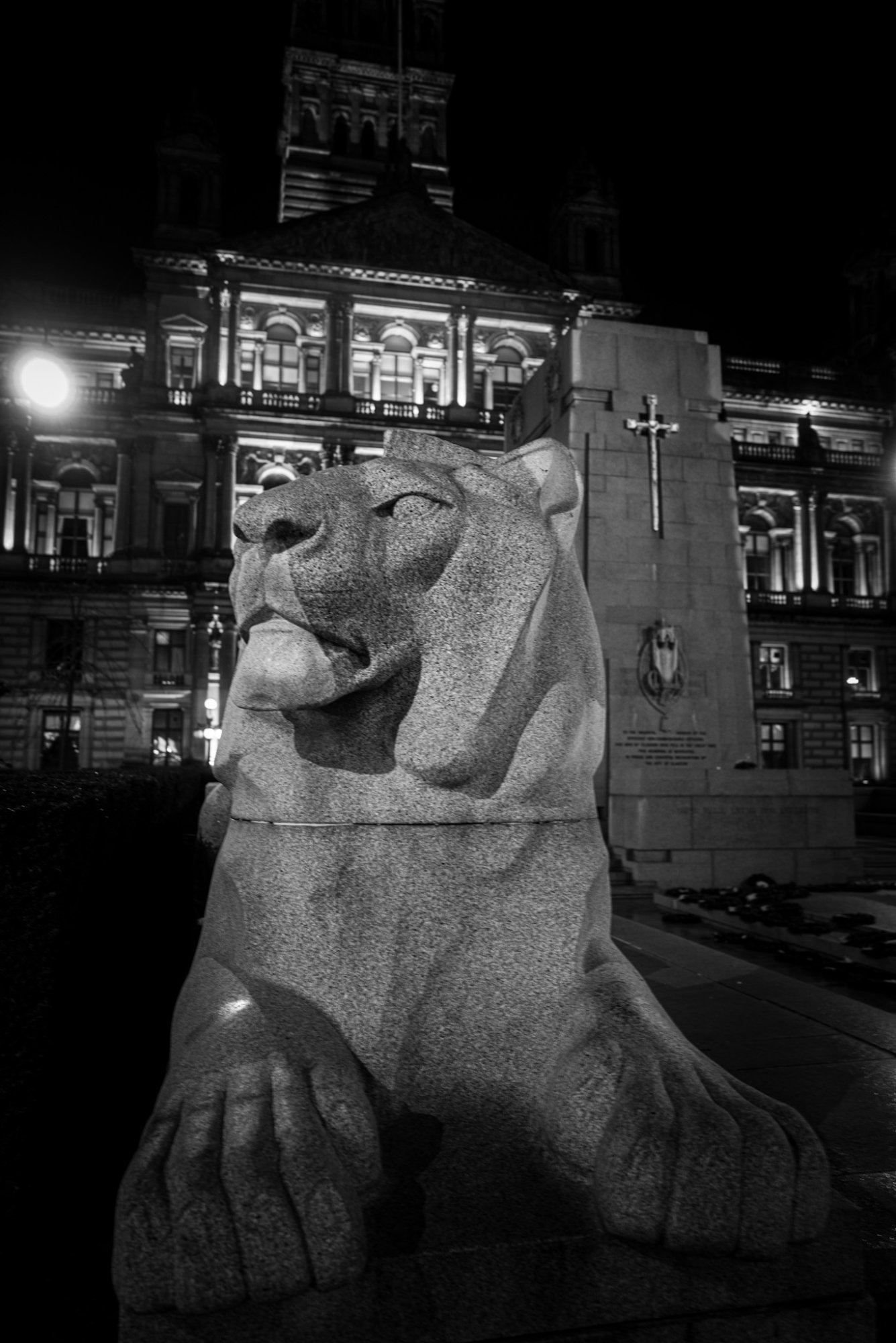

ISO 12800 | f/5.3 | 1/800 | This image required a high ISO because I needed a fast shutter speed to capture the sports in action. I did not need to expose for the shadows behind the field and chose my settings on keeping the exposure correct for the players.

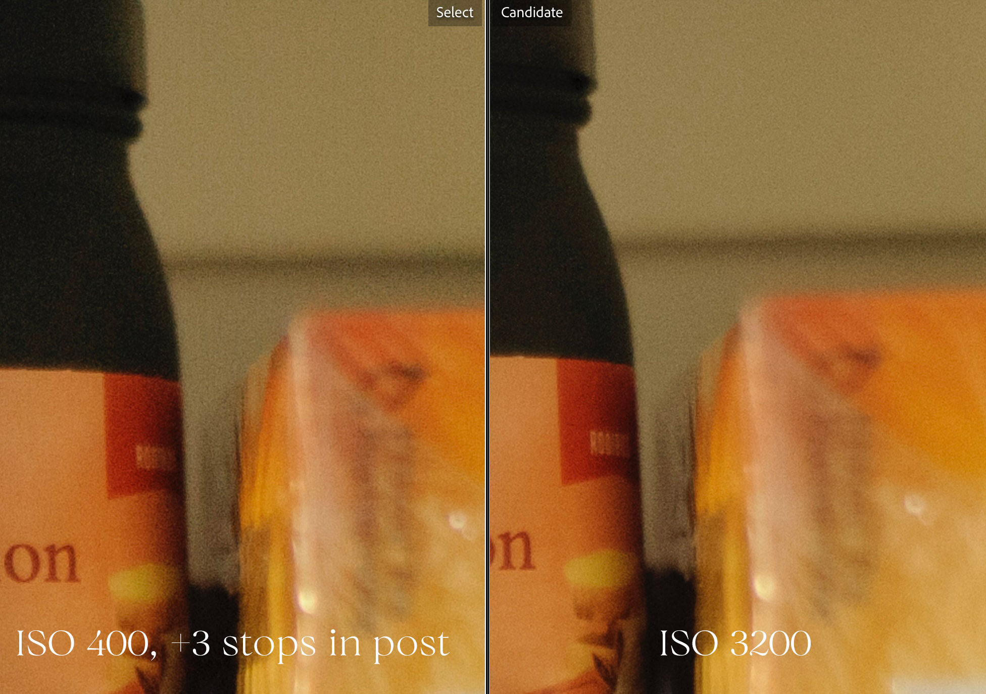

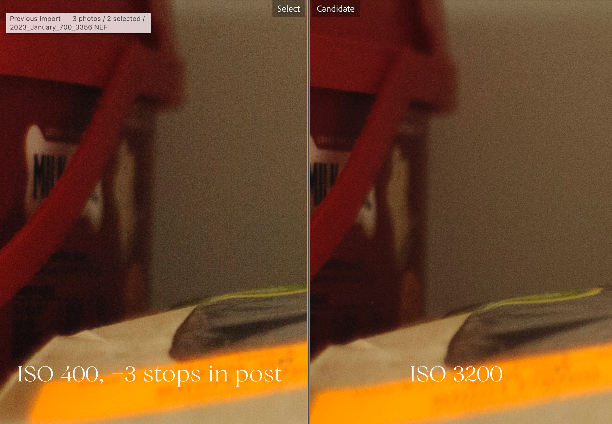

Here are two examples of the dangers of raising ISO in post. I had a hard time finding examples of this as my newer cameras are largely ISO invariant, and my D700 which I pulled out to take these samples, although very old, has extremely good high ISO performance. If you are using a newer camera, you might be able to ignore ISO to some extent, but I highly recommend just raising ISO in camera to set your exposure. You can see that the ISO 3200 images, on the right in both examples (these are the same images, just different parts of the frame) there is less noise overall in the shadowed areas, and the text is slightly sharper as well because there is less noise overall.

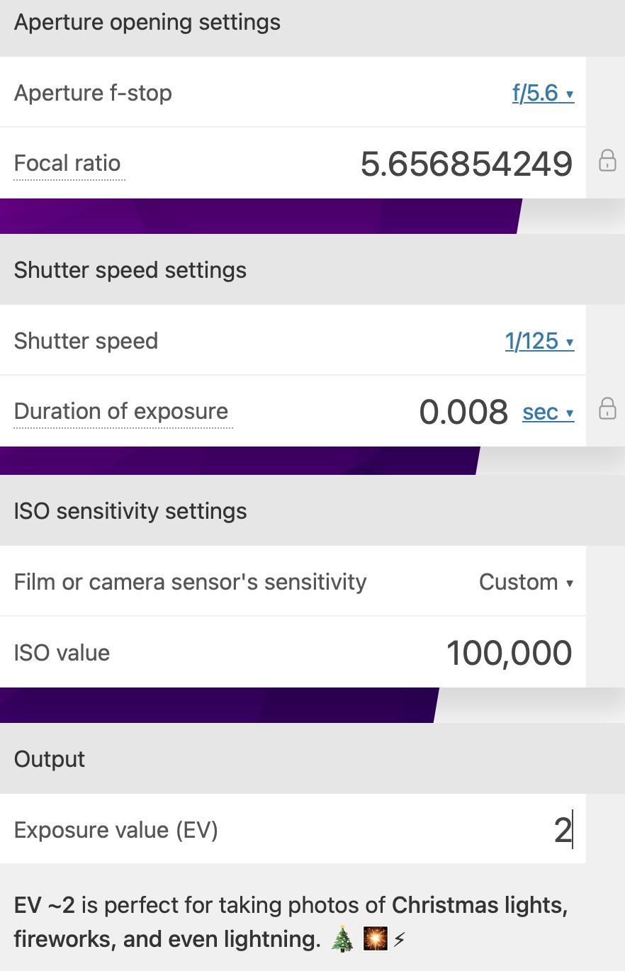

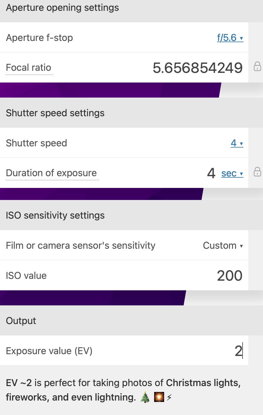

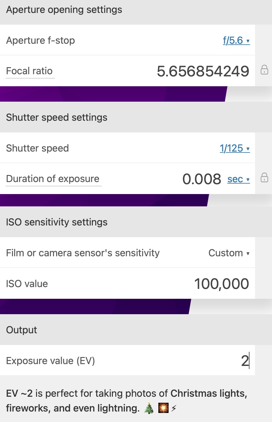

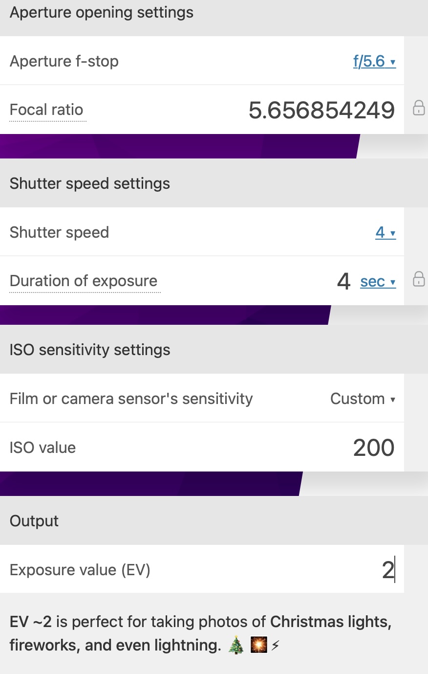

@PhilBoogie I apologize if you already know this, but if you do, then maybe it will be helpful for someone else. When shooting in manual mode, you control all the settings, unlike in auto (or even semi-auto) where the camera decides the settings. Choosing a purposely long shutter speed is often a creative decision, like if you want to smooth out waterfalls or a stream, or if you are trying to capture stars in astrophotography. If you are using a long shutter speed, you have to reduce light elsewhere, because even at night you could ultimately overexpose an image if all the exposure triangle areas are wide open.
For Bunn's image, five seconds is a really long time for the shutter to be open, so he has to lower the ISO accordingly so as not to have too much light (he could also stop down his aperture, or use a combination of those things). However, you can figure out an equivalent exposure, which means the overall light value doesn't change for the image because you've changed something to compensate for letting in more or less light.
In Bunn's image, he chose settings of ISO 200, f/5.6, 5s. If you had been in that room, you might have decided that you wanted to handhold, so you choose a shutter speed of 1/125. You've decided to keep your aperture the same as Bunn, so that means in order to compensate for the lack of light at 1/125, you now need to increase your ISO. You would then need an ISO of 100,000. That is astronomically high, and I'm not sure any cameras right now even go that high, regardless of performance; the highest I know is 51k. And while I did say that it's better to raise ISO in camera to get your exposure than to keep it low and raise in post, even the best cameras start to fall apart around 16k or so and you get visible noise.
Here is an exposure calculator where you can play with different settings to find equivalent light values. This calculator didn't have a 5s option, so I chose 4s instead. 5s would actually increase the needed ISO levels even more.
These are the settings that Bunn used (fudging the shutter speed slightly).

Here are the equivalent settings if he'd wanted to handhold at 1/125 instead.
When you play with this, put in your initial settings, then lock one or two of the parameters (it gives you directions) and then make sure your Output/EV number stays the same for your adjusted settings. When I do this IRL, I just count clicks on my camera; if I drop the ISO by two stops, that's six clicks (because I have my camera set to 1/3 stop per click), then I would increase the shutter speed by six clicks also and end up with an equivalent exposure. Remember, if you decrease the first setting, you have to increase the other one or two to compensate. Alternatively, I could decrease ISO by two stops (six clicks) and then increase SS by three clicks and also open aperture by three clicks.
I hope that helps. 🙂
