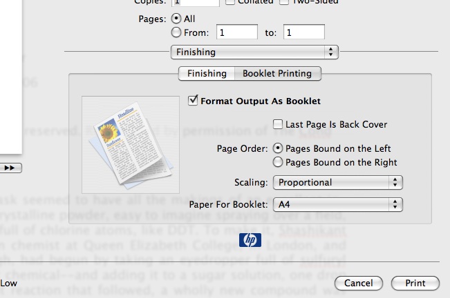

This may actually turn out to be really easy. At least, if you have a HP printer installed... Just go ahead and use a normal document, normal page order.
In the Print menu, select "Finishing" from the drop down menu, and then look at "Booklet Printing" options. I remember trying it once, and it seemed to work. I remember being impressed.
I don't know whether you get these options from non-HP printers. I cannot test that right now, but maybe it is possible to simply install one, and then save the print output as a pdf?
