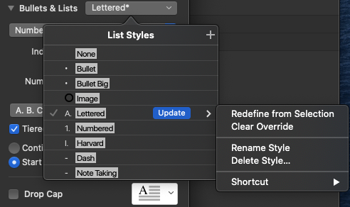

I found you can modify an existing List style.
I started a Lettered list
I clicked the Tiered Numbers checkbox
Right after doing that, "Lettered" in the Bullets & Lists checkbox acquired an asterisk
I clicked on Lettered* to open the dropdown list, and Lettered in the dropdown had an Update button to the right. Clicking Update recorded the change to the style
There's also a ">" icon to the right that, naturally, opens a list of additional options
To undo the change, I then de-selected Tiered Numbers and followed the procedure above to Update the style again.

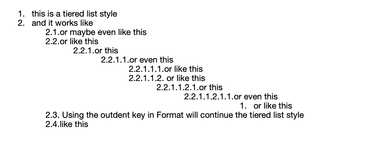

I created a Tiered Numbered list style and it works pretty well. It's best to use the indent and outdent Format buttons (although tab works ok for indenting). Once the return key is hit, the style is no longer active. Those indent and outdent buttons can also be added to the toolbar for easier access. Unless there's a way to save global list styles, it would need to be recreated in a new document. No time at the moment to research whether that's available in today's Pages version update.

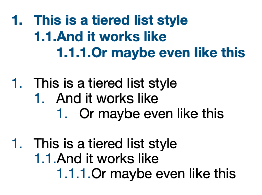

So I create the first one as I want (like if I wanted to create a "paragraph style")
I applied the "list style" in order to have the number, and I enable the "Tiered Numbers".
After that, I saved this "list style" as a new one (I tried too with replacing actual style)
I apply the "list style" to new texte and used tab in order to have the subnumber. It give me the 2nd part.
Have to enable "Tiered Numbers" again (using tab remove it) and I have the 3rd part.
Still far from the one I want and that we can define as style in Word. So in order to do that, I have to do in app :
  • Word : 1 clic
  • Pages : 3 clic ...

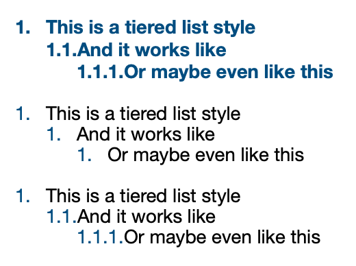

It's what I have already done... You can find bellow this new test.
"List Style" doesn't save :
  • "Tiered Numbers" if I use Indent and Outdent buttons (same than with tab)
  • Font of text (other than the number/letter one)
In your screenshot, it seems to be the same for the font. I don't see any color or bold font...
