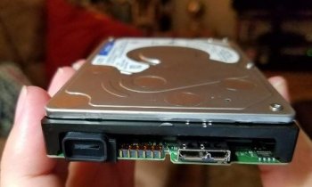

Seems like my 4TB is really slow when dealing with a lot of files. I took the drive out of its WD Passport enclosure only to find out it's not Sata, it's USB 3.1. 🙁 Was going to put it in a UASP enclosure.

SATA is the drive interface (to anything) and USB is the enclosure's interface to the rest of the world. A drive itself is never USB anything. Only an enclosure.
So you may be making a decision (about the other enclosure) based on incorrect information.
Yeah, what I'm saying is that most drives come with a sata interface. This WD 4TB Passport Drive has a unique electronic board going directly to a Micro-B 3.1 interface only (when I took it out of the enclosure). Usually you take those drives out and they have the ability to be plugged into any Sata enclosure. Not this WD 4TB Passport Drive. 🙁.
https://www.amazon.com/Black-Passpo...8&qid=1531327601&sr=8-3&keywords=wd+4tb+drive ---- This is the drive I purchased.
Ah, OK. I see what you mean. But I have to ask -- are you sure? WD is a big company and they can make drives the way they want of course. There's no way to disengage/slide out the USB circuit board and get to the traditional SATA dual connections?
If not, then I've learned something about drive configurations. Always good but I was hoping to help.
Yeah, check it out - I lucked out and found a pic on Amazon Reviews (I should have taken a pic of mine when I had the drive apart):
This is what it looks like (see attached) when you take it out of the enclosure. I was very surprised too.

Amazon Review from another customer (not me): "It worked great for a year. But I got careless and carried it with the cable attached. I'll speculate that the cable got torqued and put too much pressure on the connector. When I got home it wasn't recognized by the PC. I popped it open to see if I could fix it. The connector is soldered to a very thin and fairly flexible PCB, i.e. it isn't supported particularly well. I'm guessing that I cracked the pcb or lifted a pad where the connector solders down. My data was backed up, not the worst mishap. I was hoping that behind the dead USB i/f would be a SATA i/f to allow me to still get some use from the drive. No luck. "

Damn. I had no idea. Well, as I said -- WD is big enough to make drives with custom interfaces.
I always buy bare drives and empty enclosures, so I've never noticed anything like this.
Sorry not to have been able to offer useful advice.
