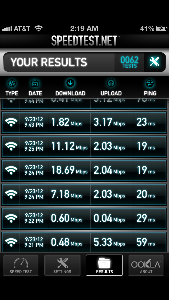

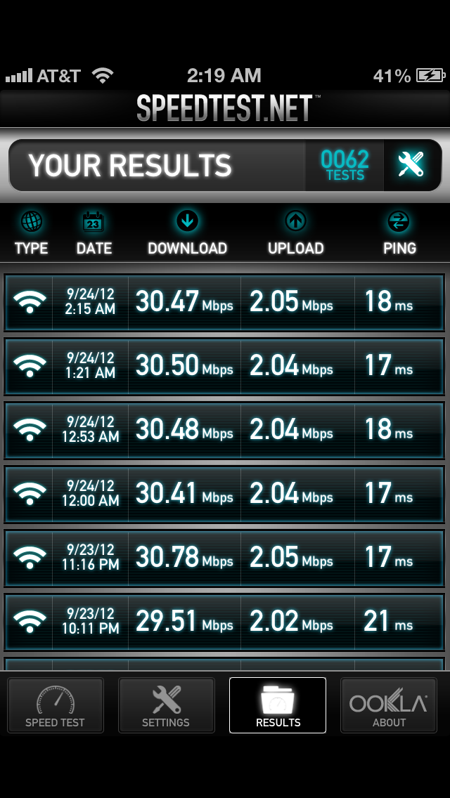

I have resolved this issue on my phone by going into my router and setting 802.11 N as the only wireless signal before I did this I was broadcasting n/g/b and my speeds were all over the place after disabling g and b all was fast as can be. After doing this though a 3gs would not connect to router and I think its because it does not support N but not sure I went back and enabled N and G now both devices can connect but my speeds have also gone down to 25 Mbps - 27 Mbps but i can live with that.

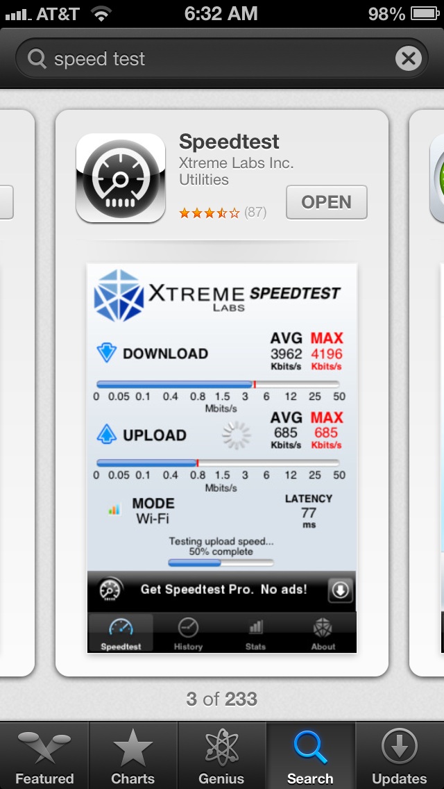

This might be due to the speed test app because when I use the test below it gives me good results.
