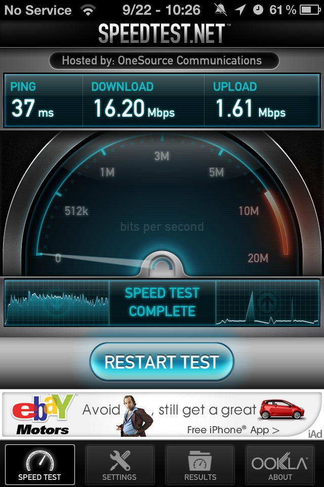

My iPhone 4s on ios 5.1 on my home wifi:

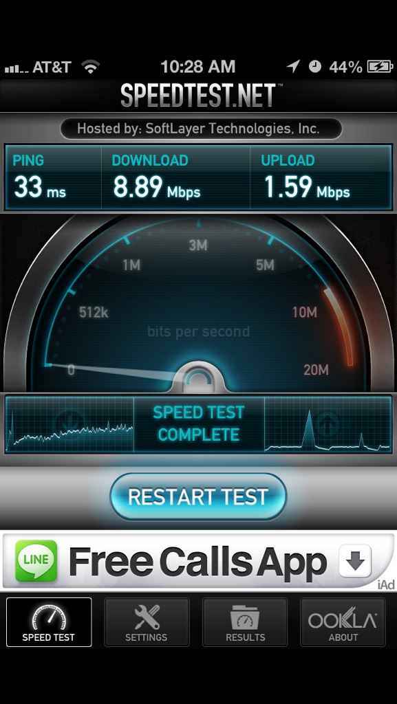

My iPhone 5 on home wifi from the same spot:
My wifi is Uverse and the results are consistent over multiple tests. I'll see about changing to WEP, but if it messes up my mac's connection, I'll switch back.
8mbs is still fast, but I'd like to get the speed that I'm paying for.
