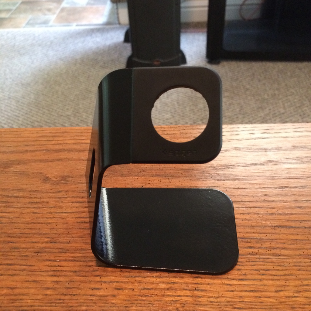

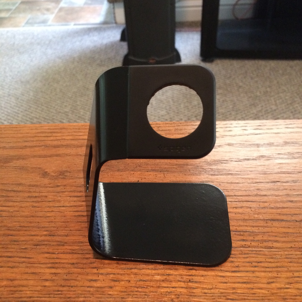

Here's the "after" pic:

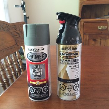

Rust-Oleum Self-Etching Primer

Rust-Oleum Hammered Black (which really isn't Black) 🙁

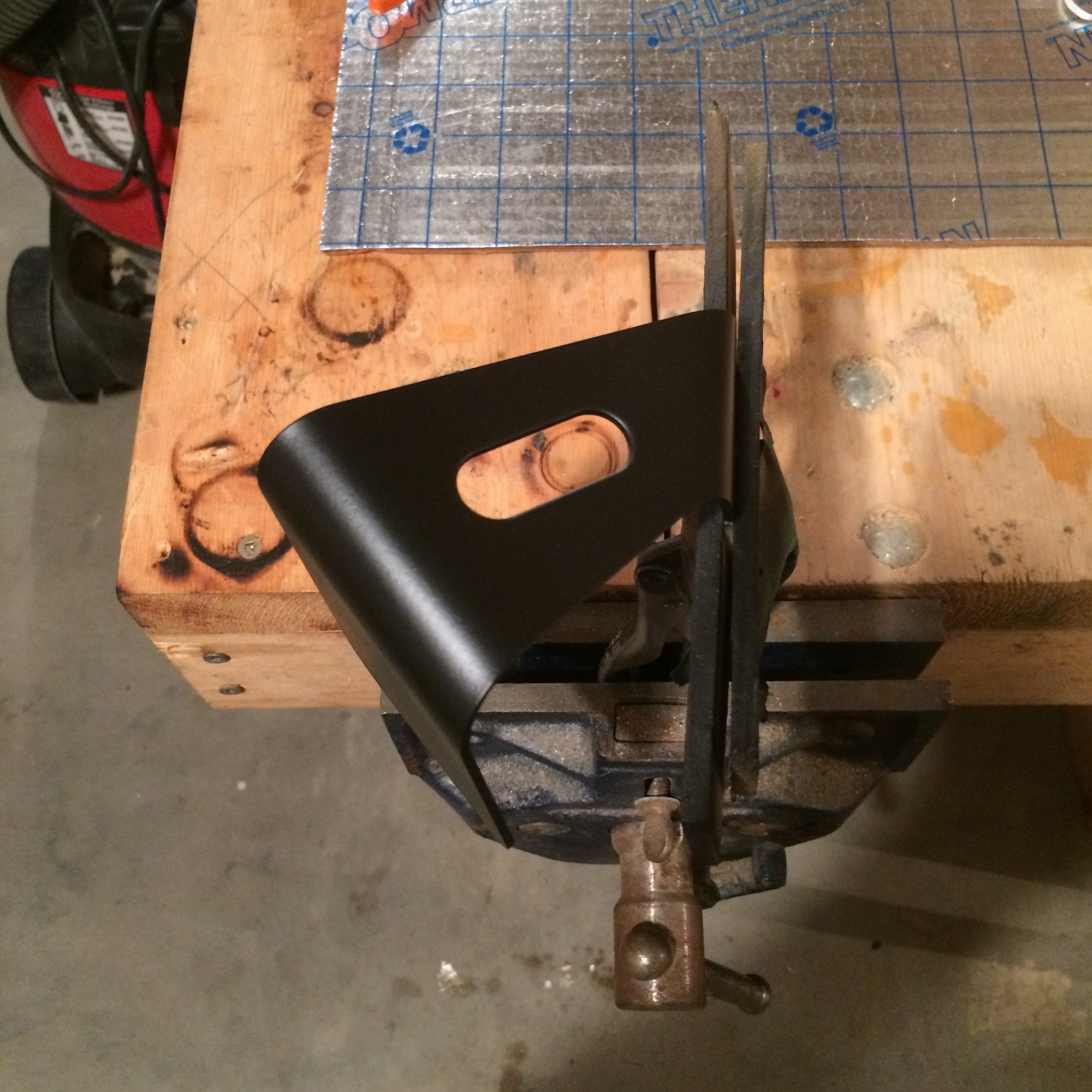

Some pics showing progress:

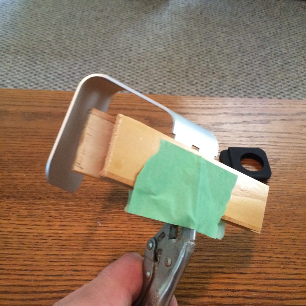

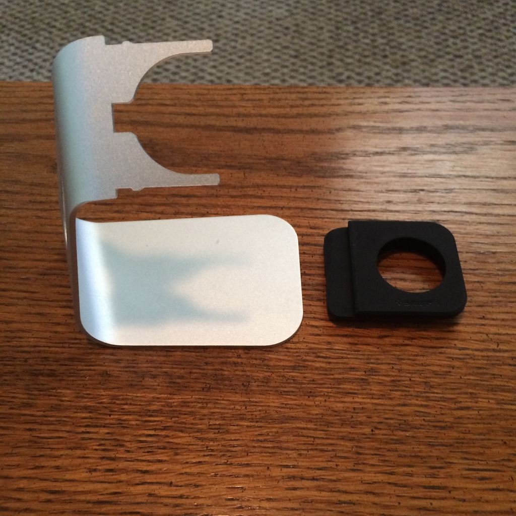

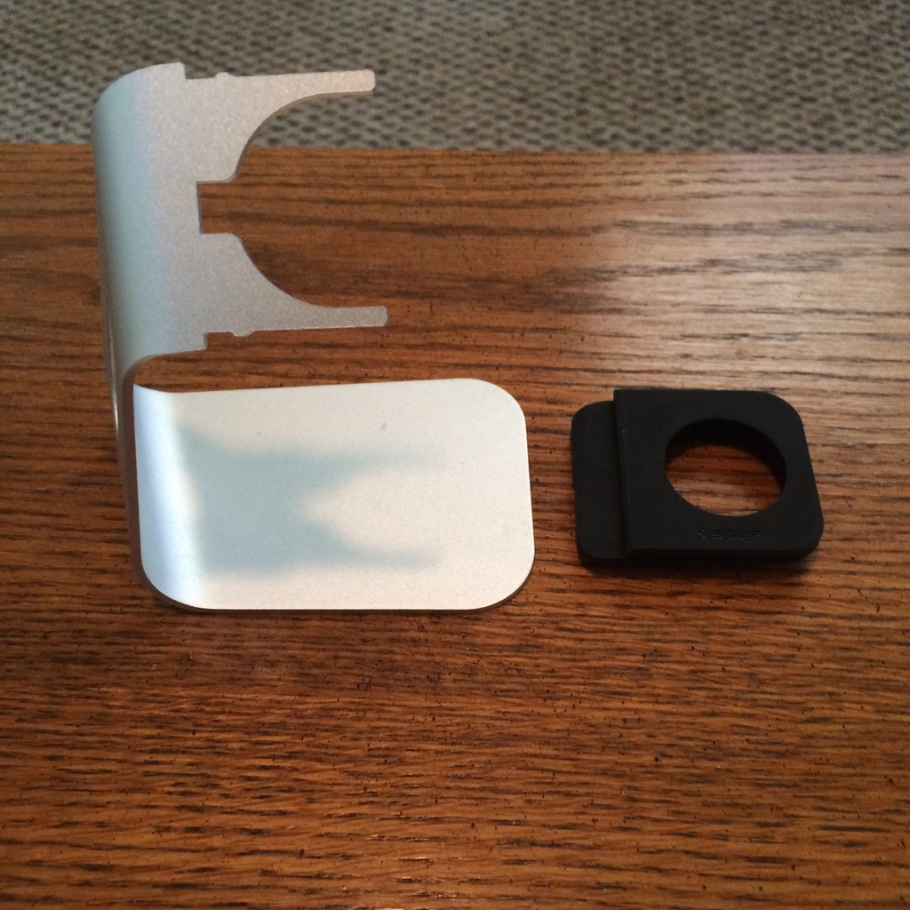

The rubber top pulls straight off:

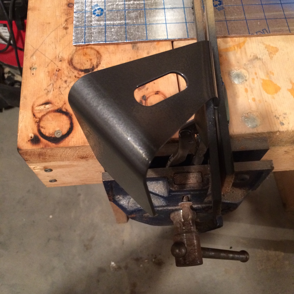

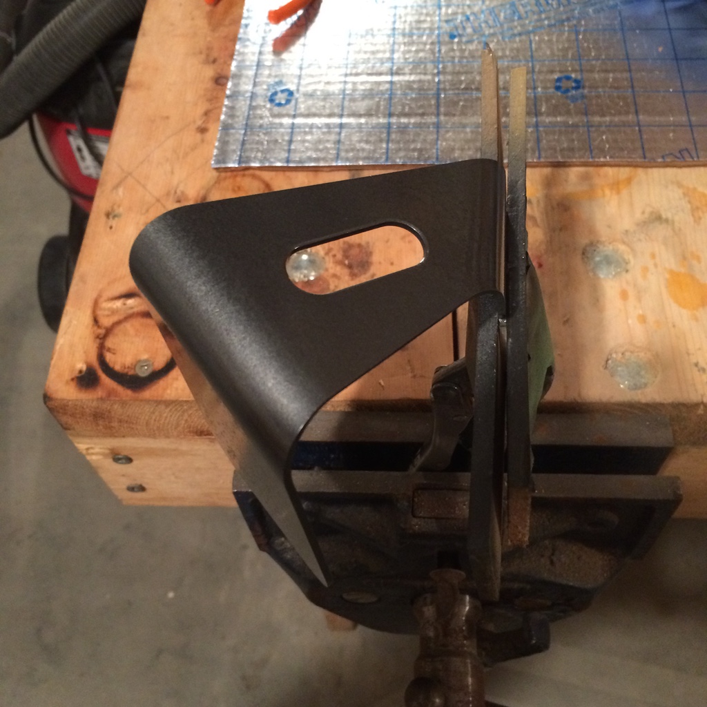

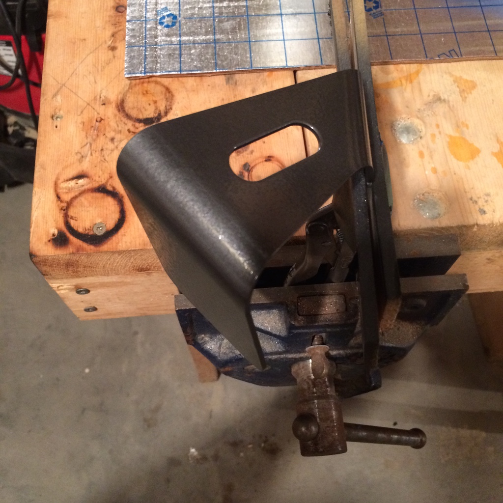

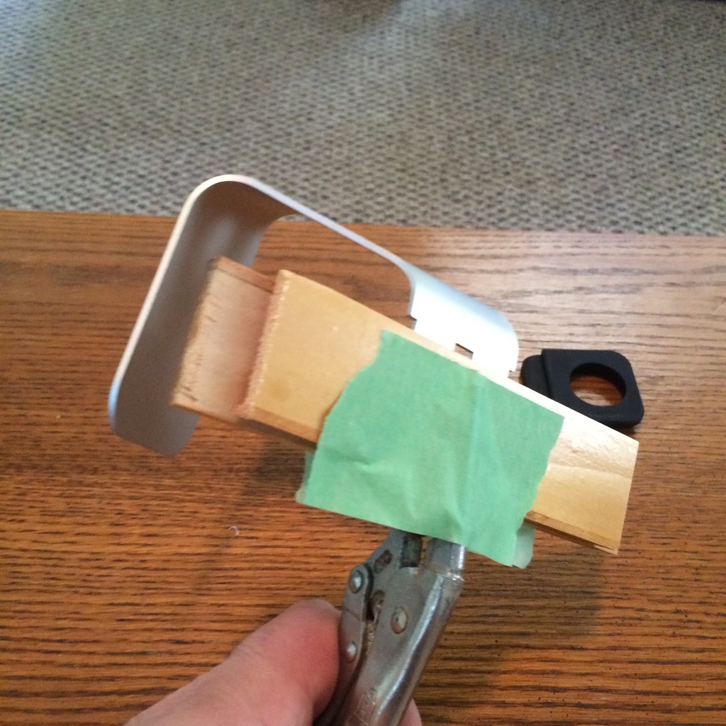

Putting strapping top/bottom protects the aluminum - vice grips in the middle
You want to paint some of what's covered by the rubber so you don't see any bare aluminum

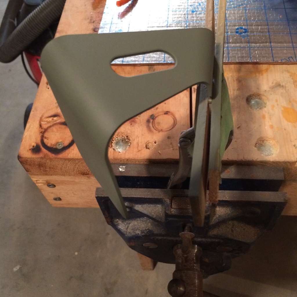

It's important to use a self etching primer on the aluminum first
Primed:

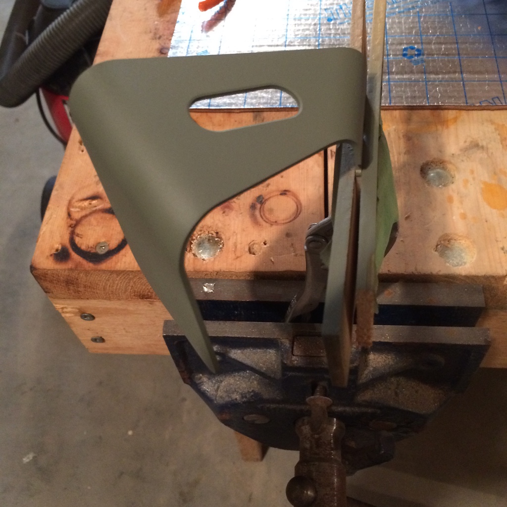

First coat of paint:

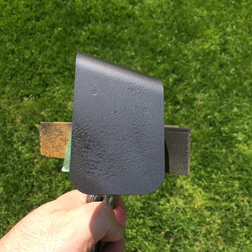

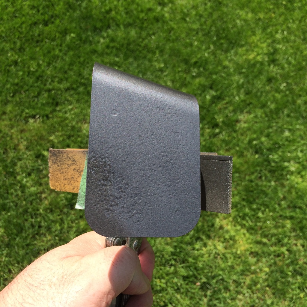

As you can see from an outside shot, the paint hasn't darkened enough

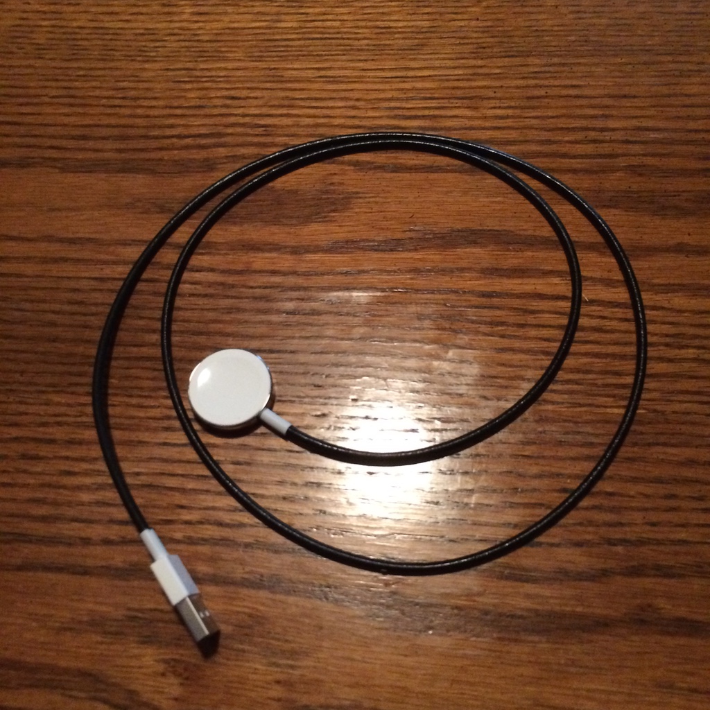

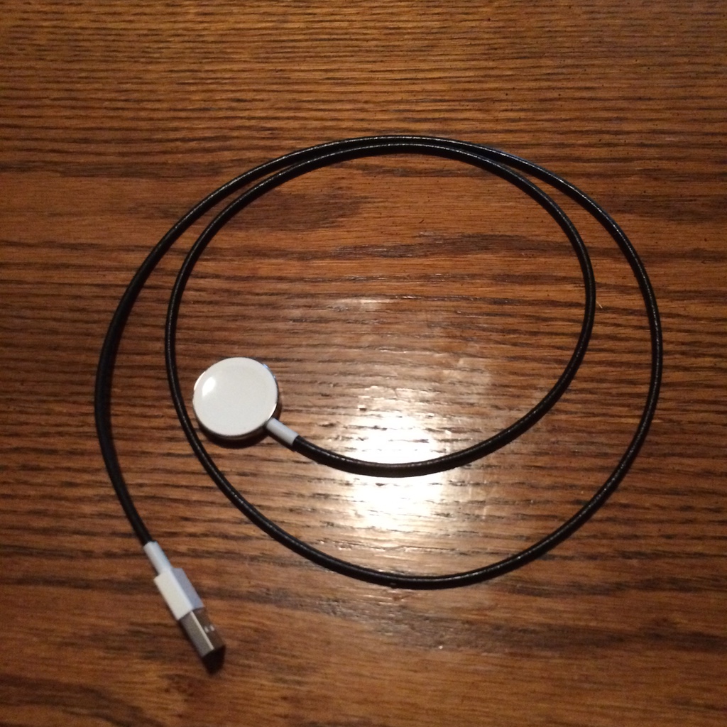

The Plasti-Dip does an excellent job at making our charging cord black!! 🙂
Showing the second coat - doesn't appeared to have darkened at all. 🙁
Looks like I'll need to do some more painting - this certainly isn't dark enough!
Notes on the Plati-Dip/making your cable black.
- I left the tabs at the end white as I figure they're prone to a lot of contact (in the case of the puck end, it's going to be hidden by the rubber Spigen top anyways)
- Doing a good job on taping is, as always when you're painting, key to having a good clean result
- Have a paring knife handy to protect the rubber on the cable as you're removing the tape
- You need to lay the coating on thick - really soak it to get a really good shiny look
- If the final product isn't shiny enough for your liking, give it a coat of armour all (also gives it more of a plastic feel)
- The cables have a natural curve / way they want to lay - by using that, you can spray one side, let it dry (10 minutes or so), then flip over and paint the other side. USE a new surface for painting the other side! The rubber will stick to the oversprayed portion from the first side!
- After doing both sides, I just had a little touching up to do (a couple thin spots)

Edit: The colour of this paint is definitely a "gun metal grey", not black as advertised on the can / can top - the can top is CONSIDERABLY darker / more black. Either I got a dud or they've misrepresented the colour of this paint. After looking at several pics of available black metallic as well as considering Glene's suggestion on creating a piano-like finish, I'm going to cover the current colour with a flat black, then a couple coats of clear-coat to shine it up. If I can find the Meguier's polish, I'll also use it to give it that extra richness. 🙂
Stay tuned....

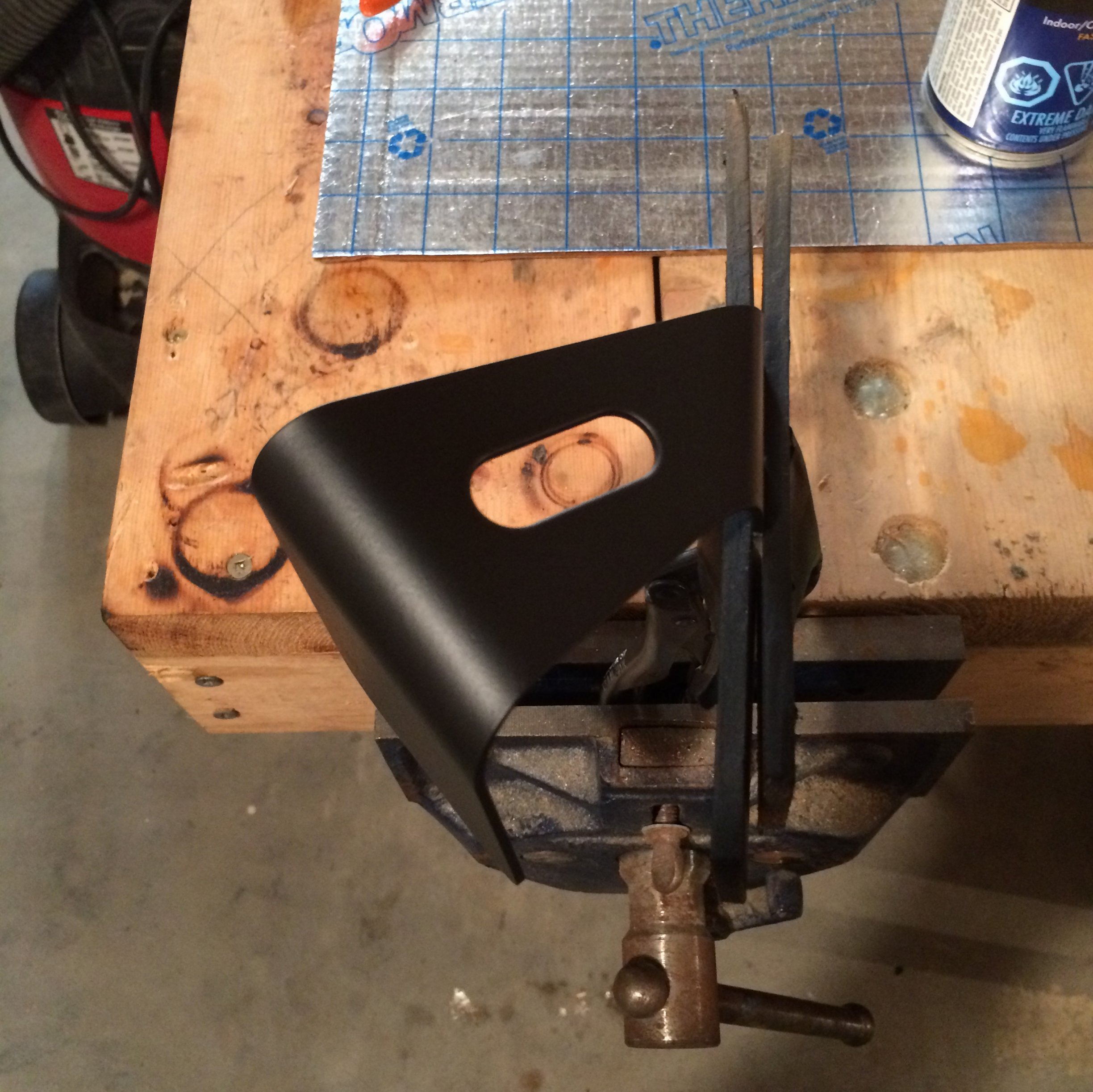

Had these handy (didn't use them for a prior project)

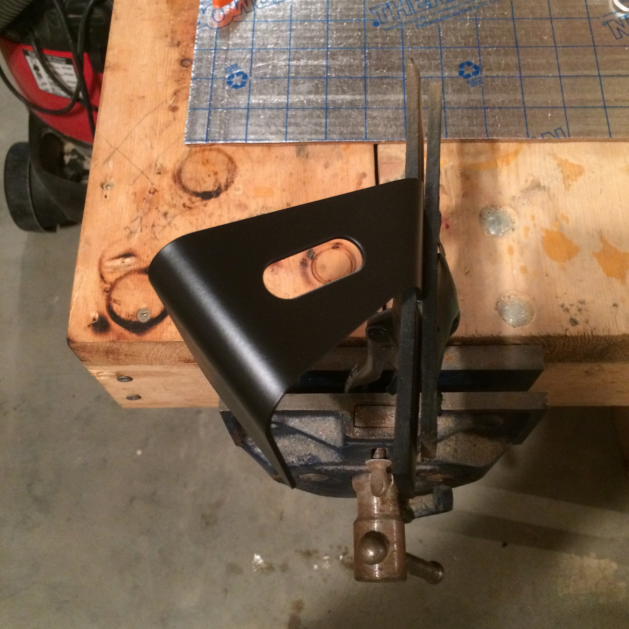

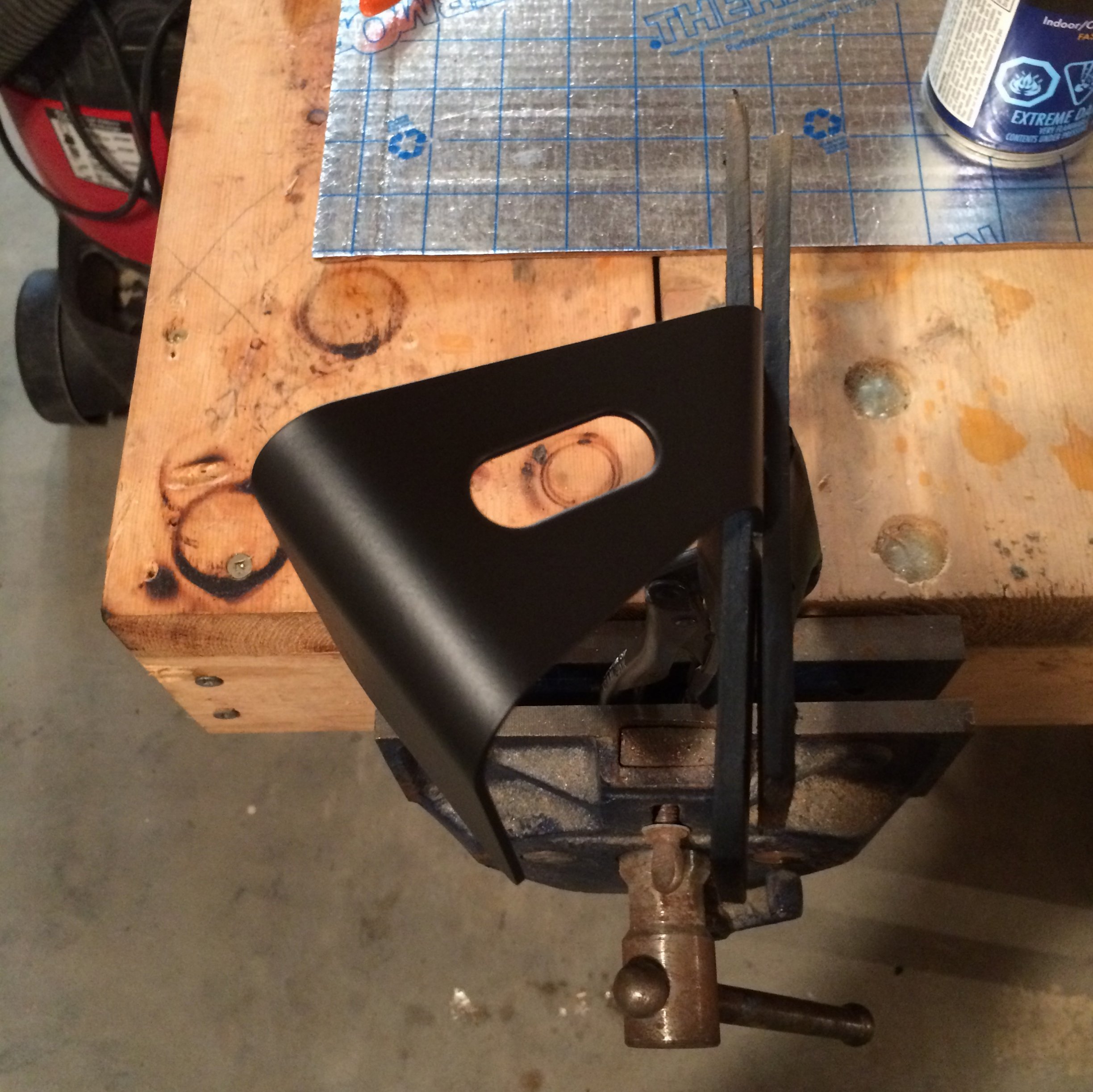

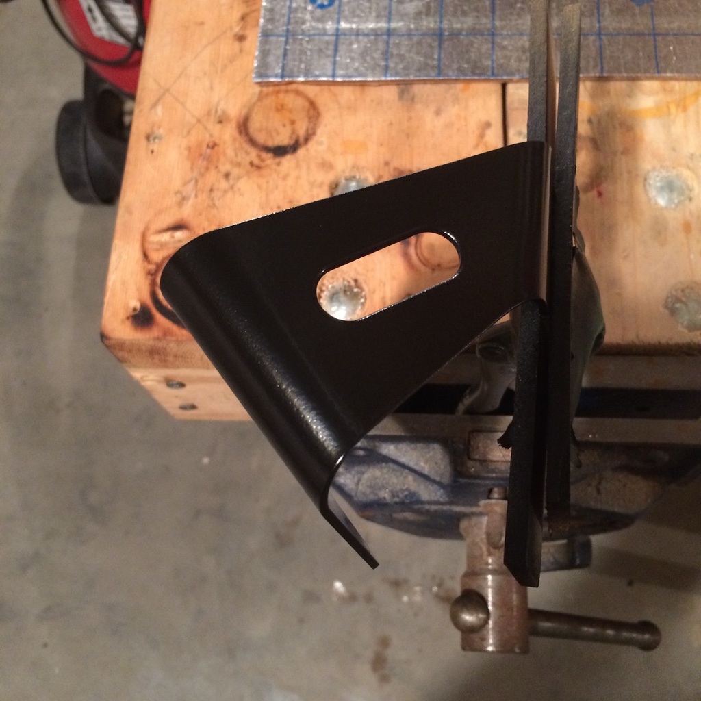

First coat of black:
I'll be adding another coat of black to make sure the colour's perfect, then a coat or two of clear.
May be another day or two (I do my painting outside - rain delays) 🙁

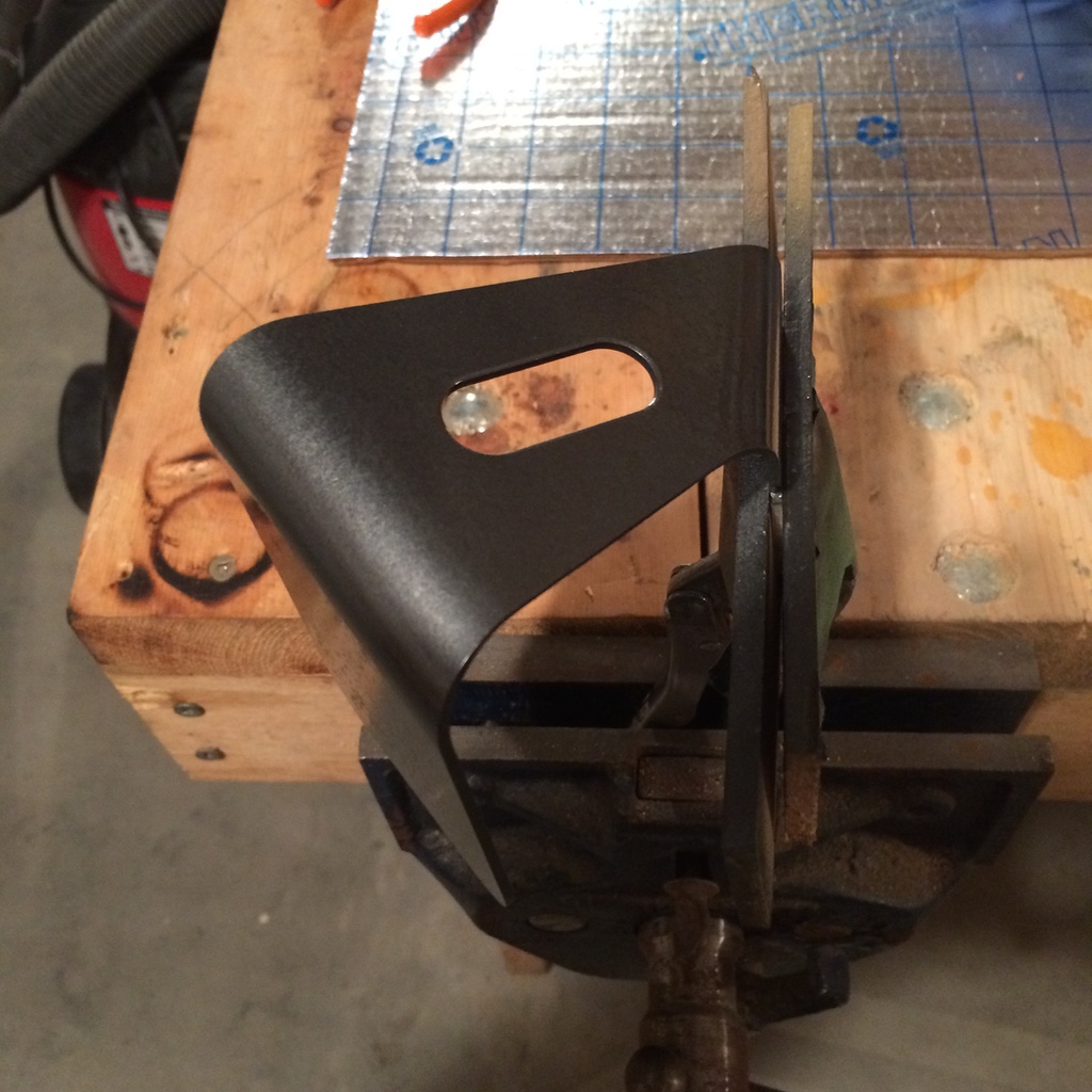

Second coat of black:

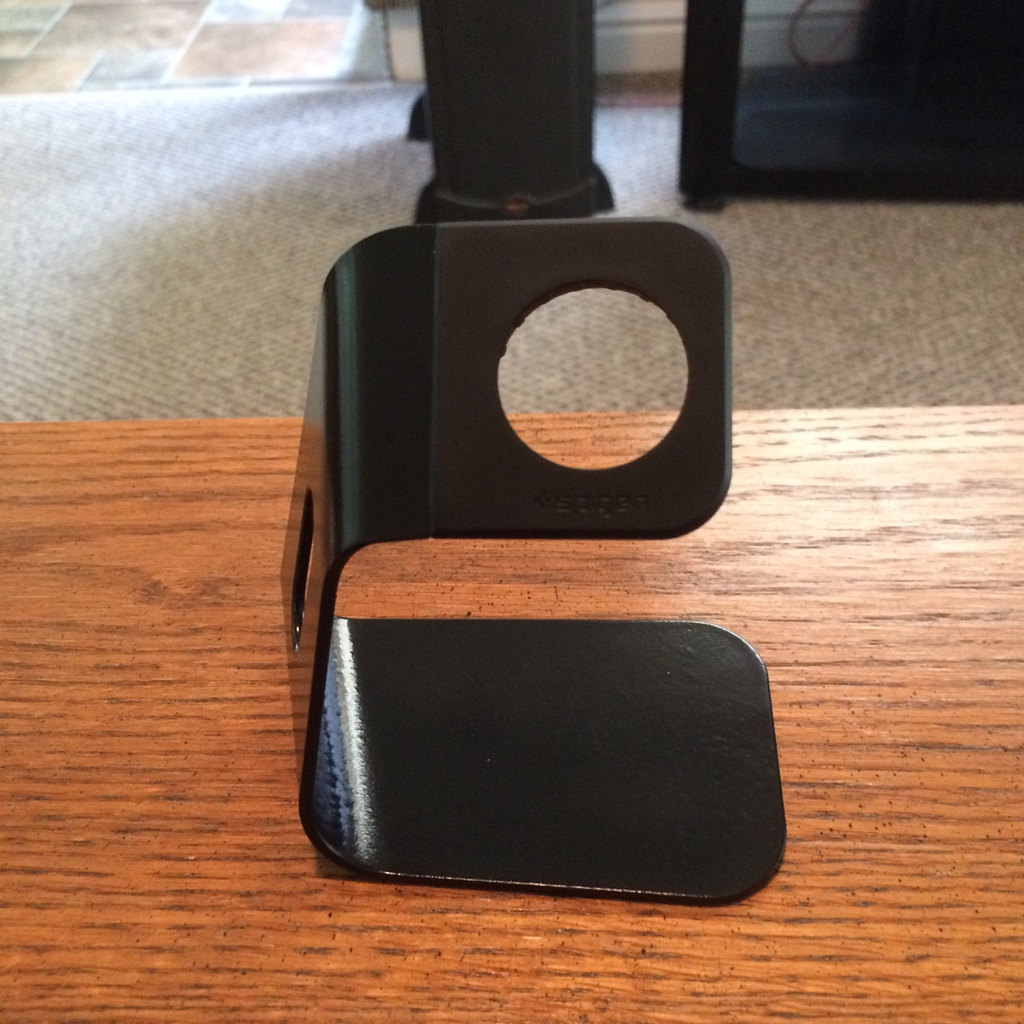

3 coats of clear:
Once this last coat of clear has cured, I'll debate whether I use an automotive polisher/cutter to give it more sheen or not. I like the Meguiar's suggestion I got from Glene, but at $45 a bottle, that's a little pricey when I don't have another project in mind to use it for. 🙂

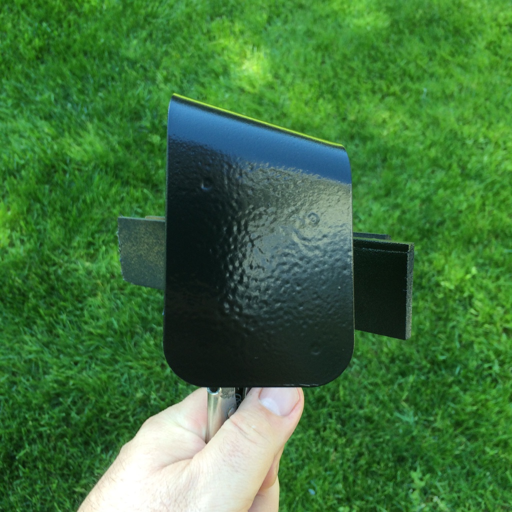

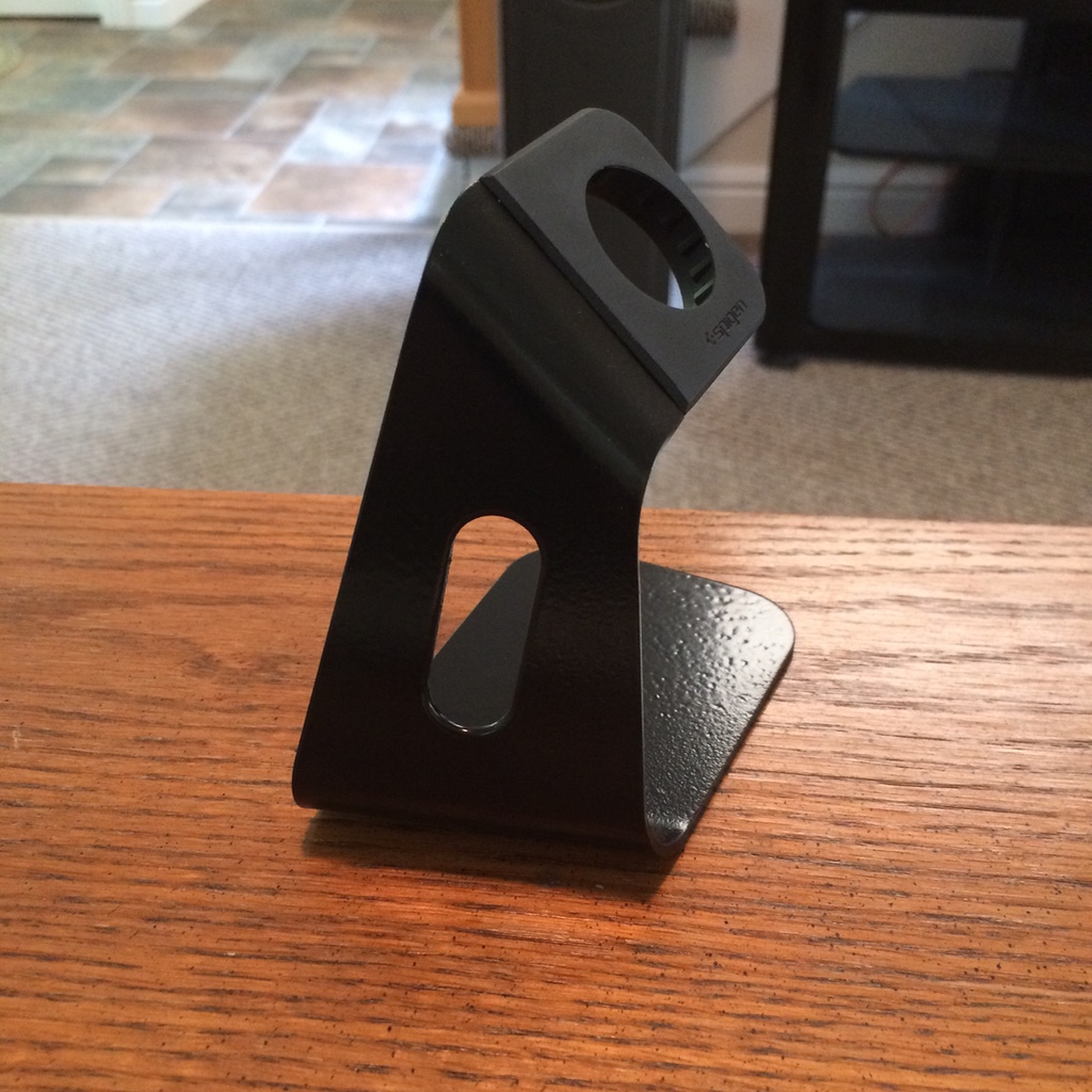

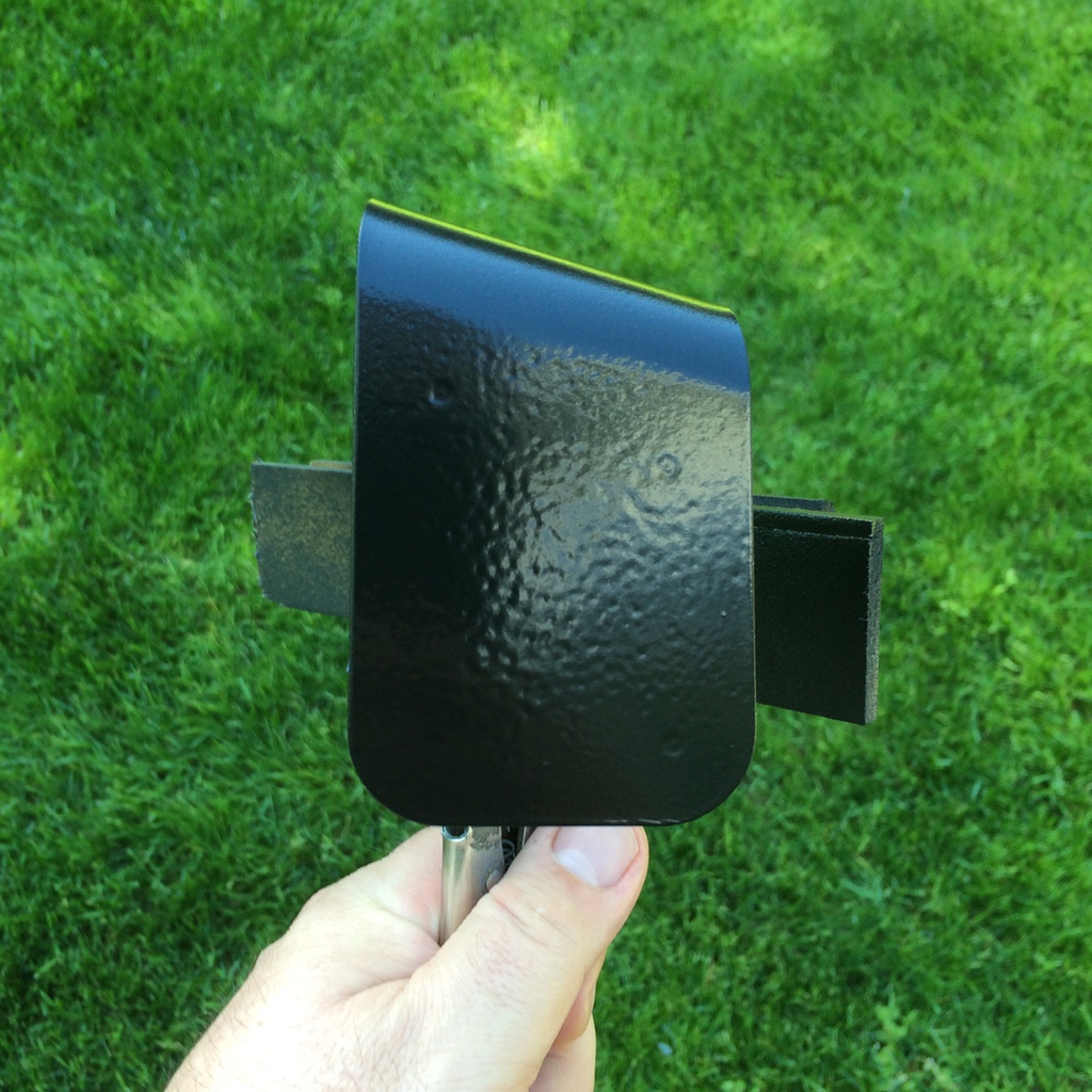

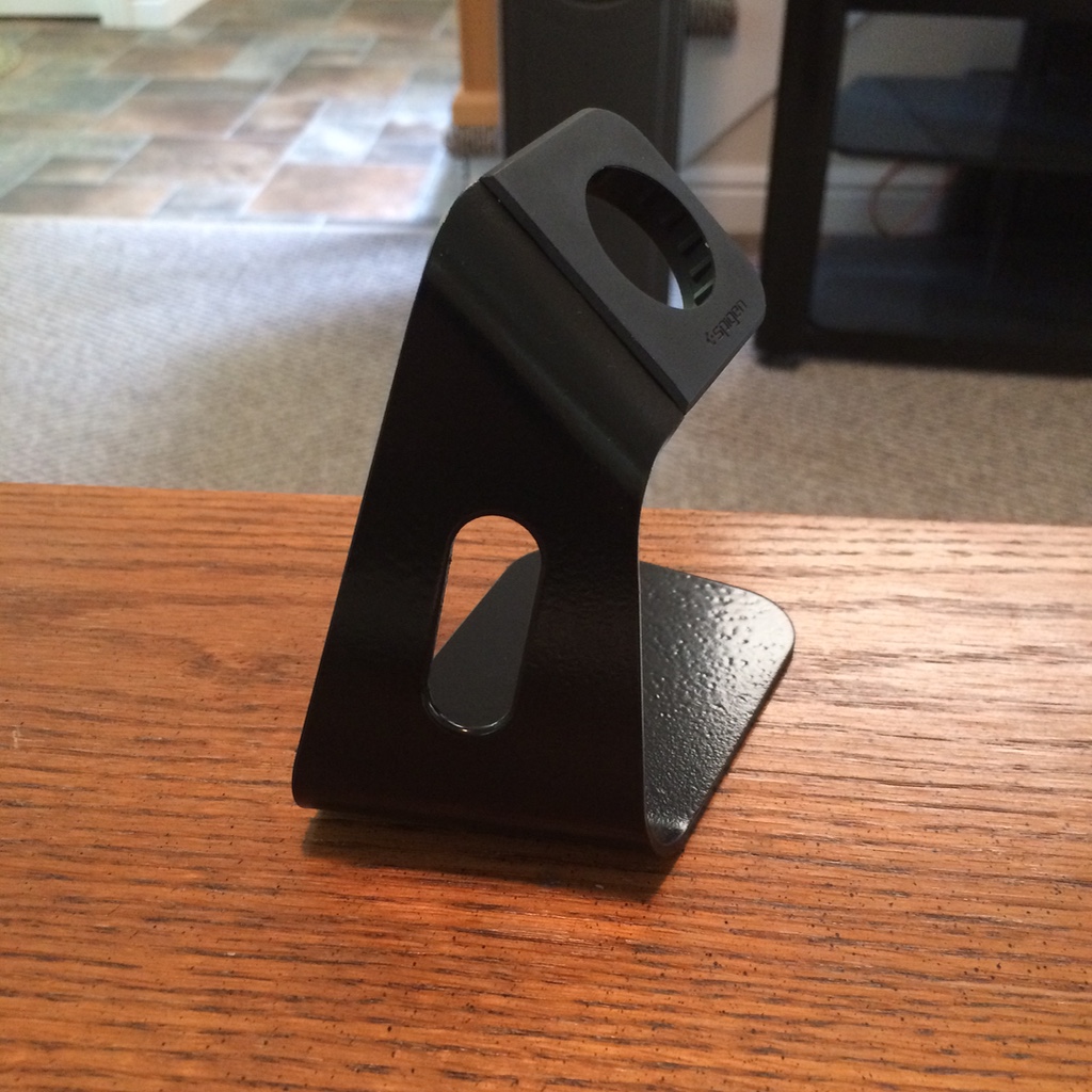

Oh, and I decided to grab another outside shot, so you can see how much blacker it is than the "hammered black" I tried first. As you can see, it still keeps that "hammered" texturing in some spots. I think it gives it a little character....if I decide to change it, I'll have to sand this all out. 😱
Stay tuned!! Next should be assembly with our nice black charging cable! 🙂

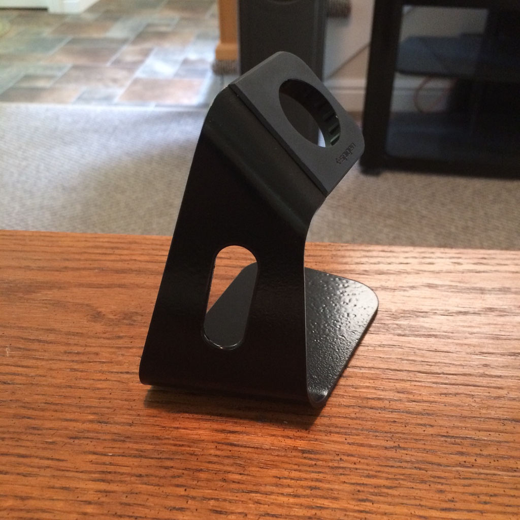

Here's some "eye candy" until I come back with it polished (and possibly assembled) 🙂
Front:
Side:
It's still giving off paint fumes, so I'm going to let it cure another day before polishing it up.
I'm planning on "tacking" the cord to the back, left, inside edge of the stand with gorilla glue to make it stealthy - the design of the stand should hide that for the most part.
Front:
Side:

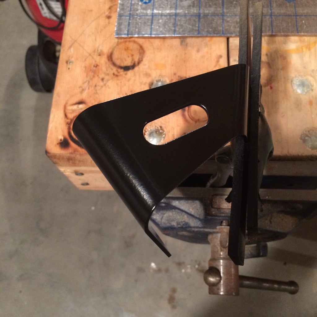

No offence. But that isn't a very good spray job. It's not very flat. Looks like you've tried to apply too much all at once.
Heh. If you actually read the thread, you'll see that I started with a "hammered black". That leaves a texturing to the finish. I put a darker black over it. I could have sanded the texture out first, but I think (as I said earlier), it adds character.
Reactions: frifra
Not the way I spray but ok. Doesn't add character. Looks shocking.
Well, I was on the fence about it. Just talked with Glene about it (who paints all the time) - the problem with a textured surface like that is that your polishing won't work (you'll get build-up of residue in the crannies, thin spots in your clear coat on the highs. So, I'm going to have to do what I thought in the first place and take it back down to the aluminum.
Heh. On my way out to grab some airplane paint remover. 🙂 Thanks Glene!
