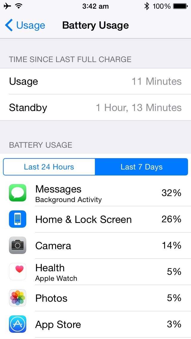

After I get the watch, and paired it up with my phone, I still can't see any significant different on battery usage. Same as my wife's 6+ and my daughter's 5s. We bought the 5s purely to pair up the watch for our daughter, her phone don't even has a sim card. It's the best tool to access how much battery required to run the watch only. We turn the airplane mode on, and then manually switch the Wi-Fi and BT back on. I didn't run a test accurately yet. However, the overall battery consumption on the 5s is less than 1% per hour. So, the battery drain effect should be almost negligible on the 6+.
And I can confirm that the watch won't make the usage time always equals to the standby time. The following screen capture is made on the 5s. As you can see, they are different with the watch paired. And the 5s still has 100% battery after disconnected from the charger for more than an hour. So, the "pure watch consumption" is actually very low.

Yeah, what flur said (and similar to my earlier reply)- while the Watch obviously keeps the BT on between the two devices, it does not- or should not- be causing your iPhone to not rest. Having your battery usage the same as the standby time is, and always should be, an obvious sign that something is wrong with your phone.
