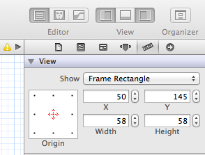

If you've designed your interface in a .xib file, open that up, click on the button named plus one, and look to the right half of the screen. You should see something like the image I've attached to this post. Click on the center dot of the white box labeled "Origin". At this point, the starting center X and Y coordinates of plus one will be displayed. To reset your view, you'll want
plusone.center = CGPointMake(<whatever the initial center x coordinate was>, <whatever the initial center y coordinate was>);
