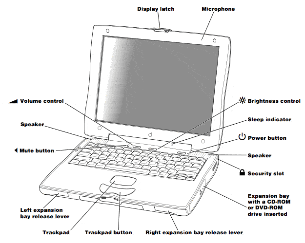

Are the contrast and brightness buttons at the base of the LCD hinge on your Wallstreet detected correctly by 10.3?
I loaded 10.2 on my Wallstreet last night (was a mighty resurrection) and the brightness button works, but contrast button is controlling sound volume.

Just FYI... the reason that the "contrast" button is controlling the sound is because it is a volume control button. There is no physical contrast control on the Wallstreet series PowerBooks.
You may want to take a quick look at the user manual before pressing too many other buttons. 😉
Ahh.. I suck. 😉
