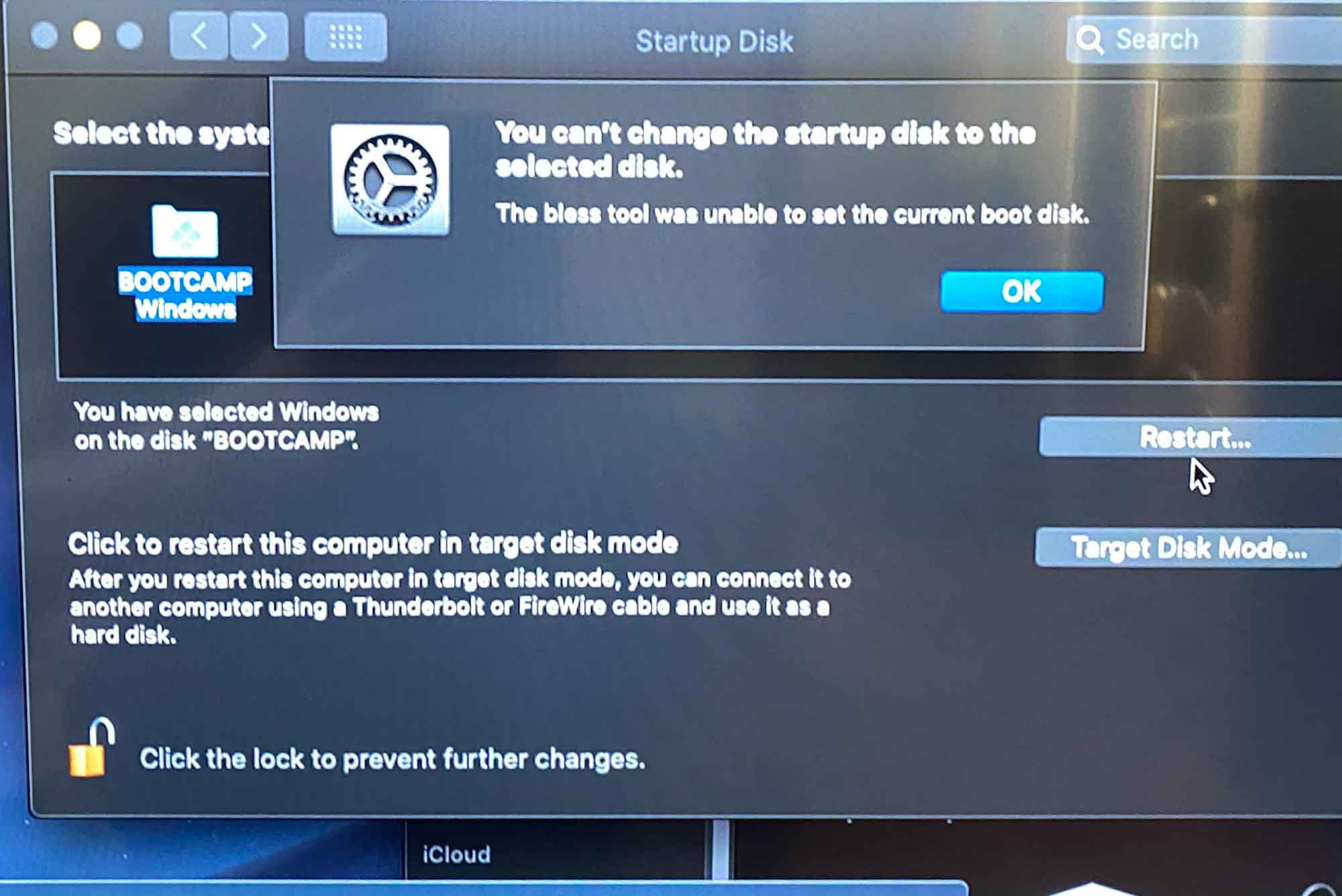

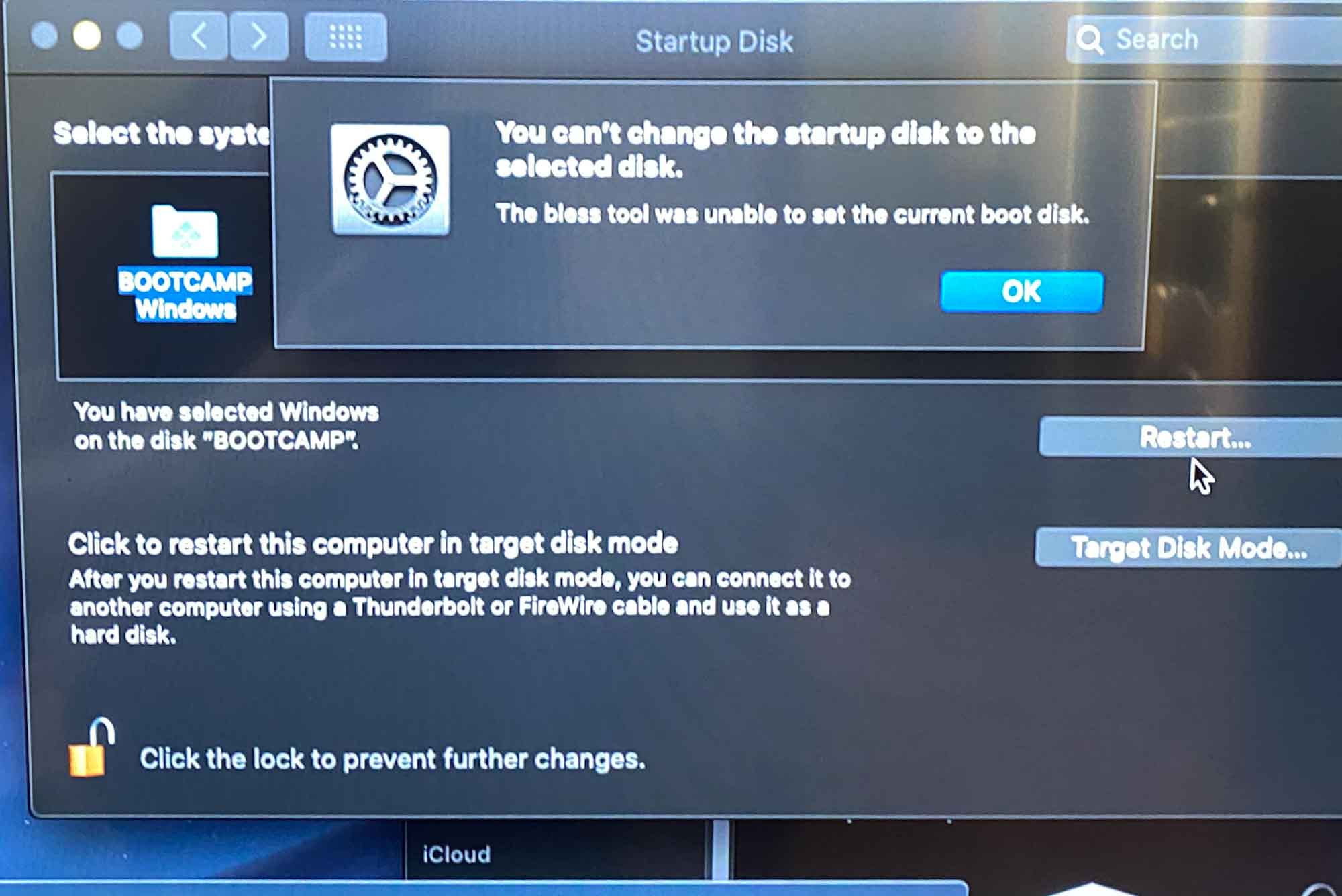

3) When I tried to get back to Windows on Bootcamp I was greeted with an error message “Bless tool was unable to...” and was unable to restart in Bootcamp partition at all...

What is this ‘Bless’ error and how to avoid it?

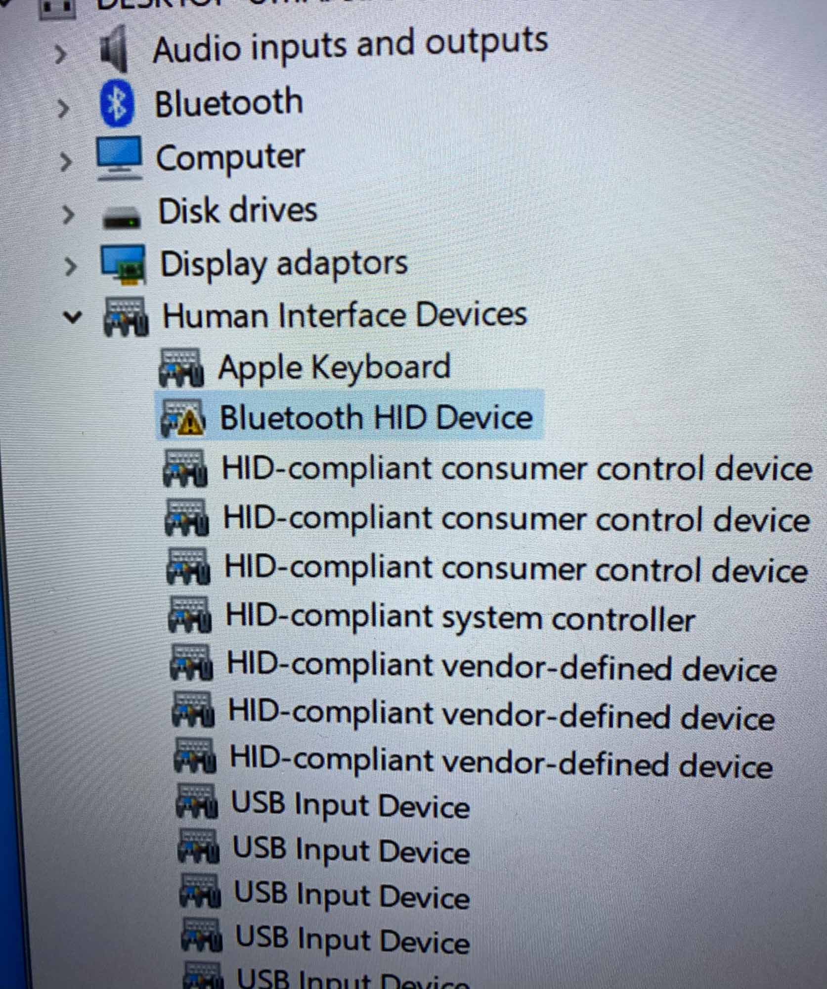

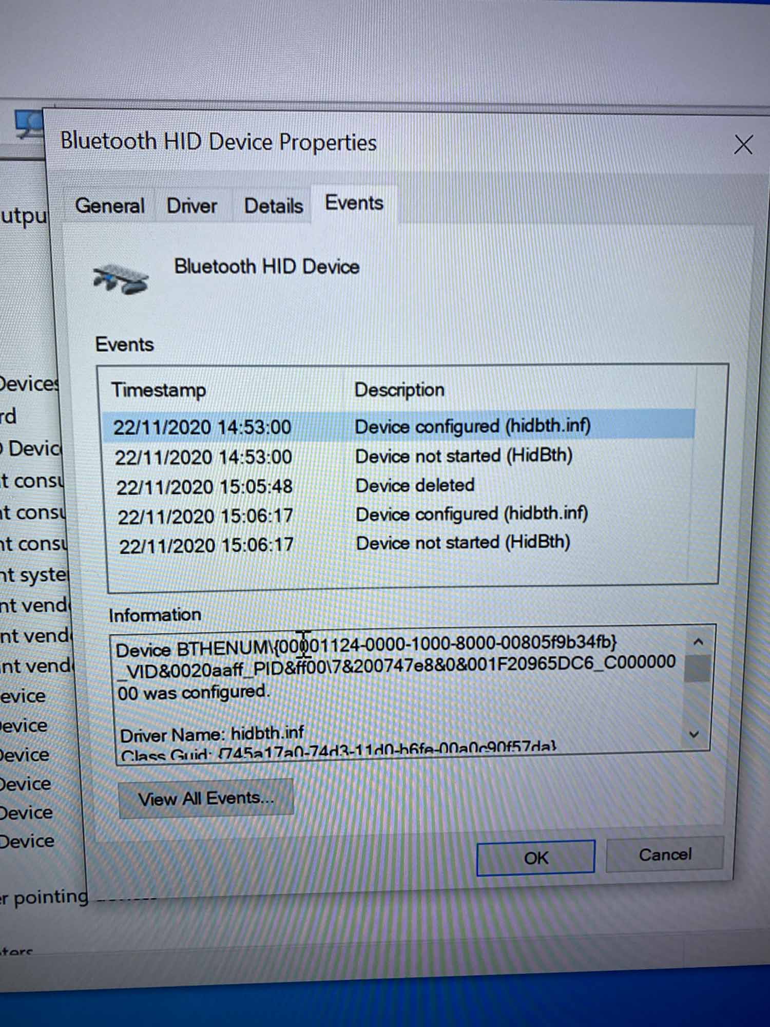

Might not be related to the Parallels but after I reinstalled W10 in Bootcamp, I noticed some unrecognised Bluetooth HID device under Device Manager. BT is working Bootcamp software was installed, and previously there was no such issue (Previous installation).
Has anyone encountered something like it?

Still have to figure out if reverting to original state (and reactivation) is possible without reinstalling Bootcamp, and this ‘bless’ issue, as well as whether using W10 within a separate Parallels installation would leave Bootcamp intact.

I have W10 2004 image from MS on my SDD drive as well as installation USB which came with retail version of Windows. I have no issues reinstalling the system. The issue is ‘bless’ error (I am quite certain it would reappear if I use Parallels again) and some activation questions (reverting activation without reinstalling).
P.S. There seem to be some info on the internet regarding the ‘bless’ issue. I’ll try to find some solution.
I reinstalled W10 within Parallels, and can confirm that it did not break my Bootcamp partition (no activation issues). There are no ‘bless’ issues so far as well.

I also reseted NVRAM an reinstalled Bootcamp one more time - currently there are no unidentified devices anymore under the Device Manager.
