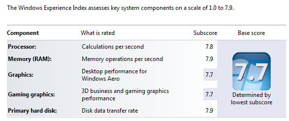

My Windows Experience Index is attached. Geekbench 3 scores are 3026 single and 14,888 multi-core
That comes between a Intel Core i7-3630QM 2400 MHz (4 cores) and a Intel Core i7-4700HQ 2400 MHz (4 cores) on the single core tests.
On the multi, to a Intel Core i7-3770K 3500 MHz (4 cores) or Intel Core i7-2700K 3500 MHz (4 cores)
Pretty respectable, all in all
