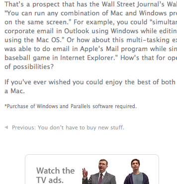

According to Apple's "Get a Mac" page on their site, they want you to use parallels. Look (Second line from the bottom):
