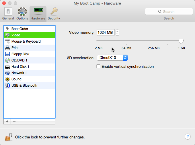

Are your settings as such:
That's odd. How are the settings when you boot straight to bootcamp? GPU drivers all updated, etc. ?
Yup.
