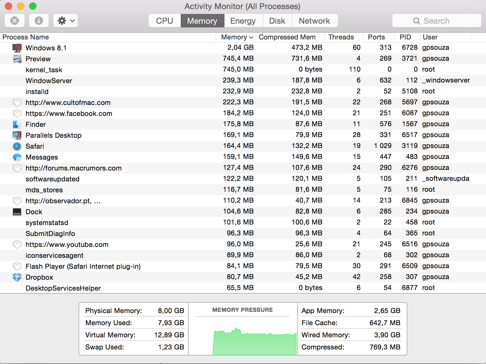

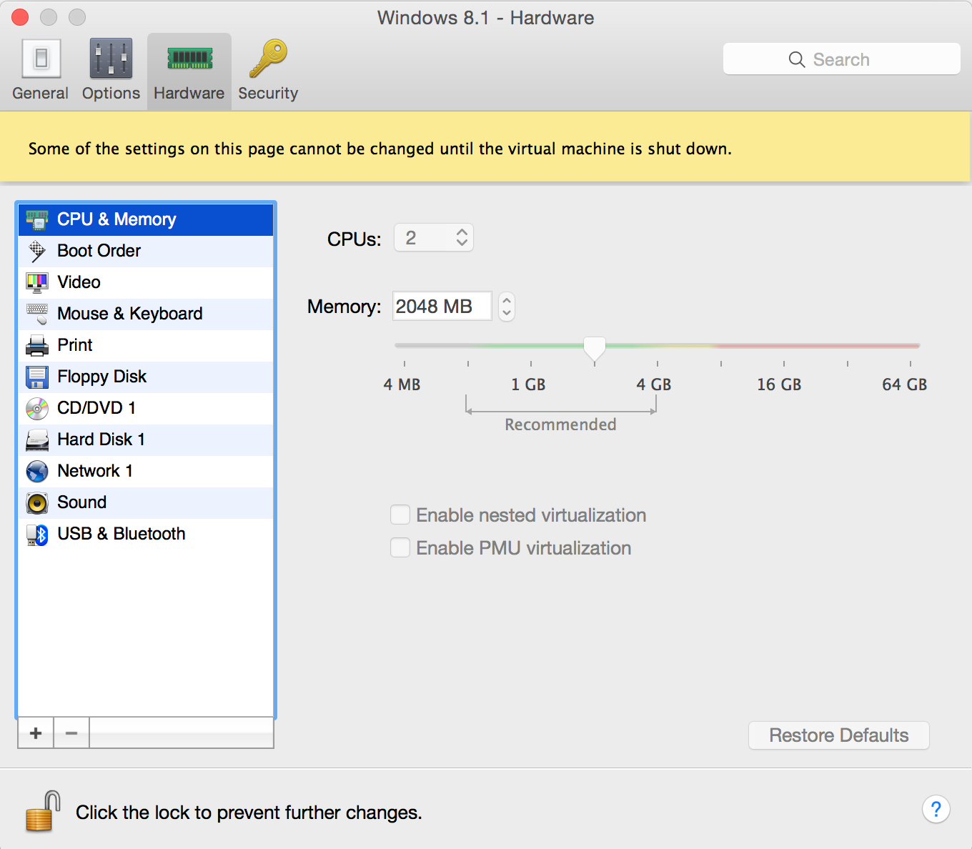

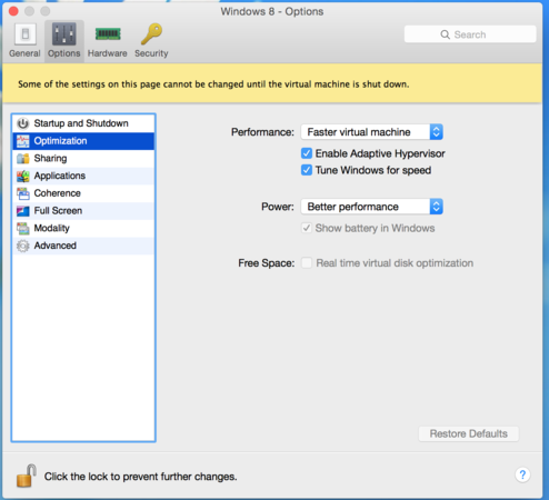

Don't know if these pictures answer your question... I don't know what swapping memory is, sorry...
See CPUs : 2 (cores) in picture posted? Try increasing it, 8 is max. Max it at 8 for a start and see if that helps (you'll have to do that while Windows VM is shut down.)
It made my fans run at full speed 😛 But it helped a little, thanks
looking at your video at 1:04 you look to be using all your RAM and falling into SWAP which will hurt performance.
Try a clean boot and only running the VM with 1GB assigned and see if that helps.
Assigning windows less RAM doesn't seem to hurt performance at 1GB and above IME.

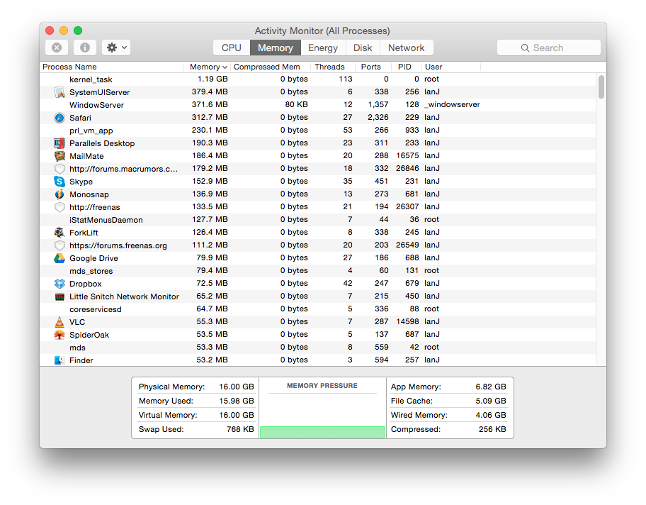

Ive attached my activity monitor so you can see the difference.....

Adding more RAM to the VM won't help as he's already running into host memory issues indicated by the compression being applied. The poor perf is indicative of thrashing of host resources IMHO and not performance starvation within the VM.
Advice to the OP is try both ways and let us know what fixes it! Good luck!
