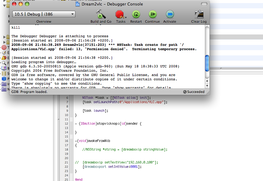

The port and the ip i wil get from a textfield , but how to paste this in the arguments. And i've also a permission error.
Read the documentation for NSTask. There are clearly marked methods for setting the arguments.
Also you, as a developer, should be aware that /Applications/VLC.app is a directory, not an executable.

Yeah , was already reading the doc.
I've also changed my code to :
Code:
NSTask *task = [[NSTask alloc] init];
	[task setLaunchPath:@"/Applications/VLC.app/Contents/MacOS/VLC"];
Because you're right.

IIRC, launching GUI applications this way isn't recommended by Apple due to differences in the way that bundle-based Mac applications are launched compared traditional *nix executables. Admittedly, VLC is already a *nix port so may be a bit more forgiving of you bypassing the normal Mac launch procedure.
Still, if it provides an Apple event API for the purpose, that's probably the best (and most official) way to do it, either via NSAppleScript or an ObjC-Apple event bridge.
