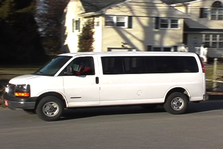

Ok so what everyone has been telling me isnt working at all. My situation is I have a van driving down the block with markers on it.(Red tape like this +) There are 2 trackers. I then bring my footage into AE and then I track it with 2 points a scale and position track. I did this to put the Words Toyota Van on it just a practice. This worked ok i had to manually touch up some keyframe but it worked good. I then exported a random frame like everyone said and brought it to photoshop to clean and paint out the markers. I cloed them out. Then i brought the clean plate (frame) into AE and did a Single Point position motion track and applied the data to this clean plate.
The thing is now when i erase the the footage beacsue the clean plate is underneath its not working its clean for the one frame i cleaned then thats it. Any help. Could it be i need to clean the very first frame so it tracks perfectly in video or is this method only if the trackers are still in the footage.Example a tracker on a bottle sitting on a table and just the camera moves.

the single frame does run the entire length of the clip. My whole problem is it doesnt follow perfectly under the source footage . The first frame i erase the marker and it shows thru which is good. It shows the bottom layer which is the clean plate. But once it starts moving im shot.

Can no one point me in the right direction on how to paint out markers when the camera is movie. Or vice versa moving markers if the object like the van is moving? This is a very common workflow being that its done in all shots that have motion tracking.
