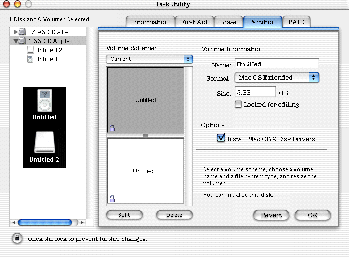

Well, I'm actually going to answer your question, unlike most others here.
The answer is yes, it just transfers the iPod control data to the first part and the second is left as a plain storage drive.
Heres a pic:
Here's a pic of it working with iTunes:
(i split the drive into 2 parts)

I got some bad news, I tried to boot my iPod and it was a no-go. Wierd how it works on the comp, but not by itself.
I just did a factory restore and it's all better now. But partitioning/erasing it does something so that it can't operate by itself. I tried replacing the iPod_Control invisible folder with the original, but that had no effect.
I think that the iPod is set up in such a way there can only be one partition for it to operate correctly by itself. I can't think of any way to hack it to make it do otherwise— it must be something at a lower level than I can't tamper with.

The iPod is basically set up in this way— 3 partitions: a Partition map, a 32MB Firmware Partition that the iPod uses for its proprietary OS, and the rest of the space is for mass Storage of mp3s, data, and iPod/iTunes preferences (see picture for partitioning scheme).
Now the problem that arises when you partition the iPod is NOT imaging the FW part, but rather the fact that there is no way to format the 32MB FW part to Apple_MDFW— the FW most likely standing for Firmware. The iPod is fine on the computer after partitioning, but the FW needed for standalone operation is not there so it gives a system folder icon meaning that it can't boot.
So the only problem is formatting the firmware partition. In theory, if you imaged the FW and were able to reproduce the Apple_MDFW format, then you could partition it successfully. I used the the dd Unix program to image in this way:
dd if=/dev/disk#s# of=~
if means input file, and of means output file and # is the disk/part to image. So if I could successfully format the 32MB part to Apple_MDFW, all I would have to do is switch the arguments so that the ouput file is the new input file:
dd if=~ of=/dev/disk#s#
So, in theory, all the pieces are there except the proper format for the FW and the only program that can do it is the iPod FW updater with its Factory Restore option.
I researched this and nobody seems to have partitioned it, so we're stuck the MDFW conundrum. :confused:
