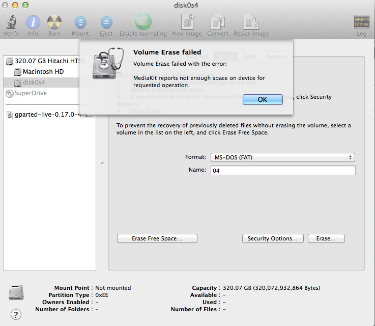

So I did this. However, Boot Camp disk in Disk Utility turned gray and changed its name to „disk0s4”. And now when I try to format it again I get error:
„Volume Erase failed: MadiaKit reports not enough space on device for requested operation.”
What can I do now to fix problem, I need to format it to Mac OS Extended (Journaled).
Also it is not mounted and its not possible to mount it. Partition type 0xEE.

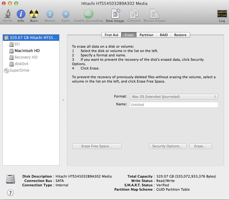

Right now my disk utility looks like this:
Problem is disk0s4 used to be BOOTCAMP, I ruined it and I can't repair or erase it.
So let's say reformating whole hard drive will solve the problem, won't it?

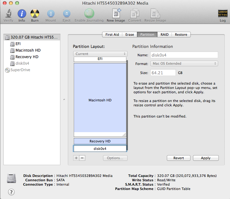

However, as you can see in the screeshot, Erase buttons are gray. Same in the partition tab: every button is gray.

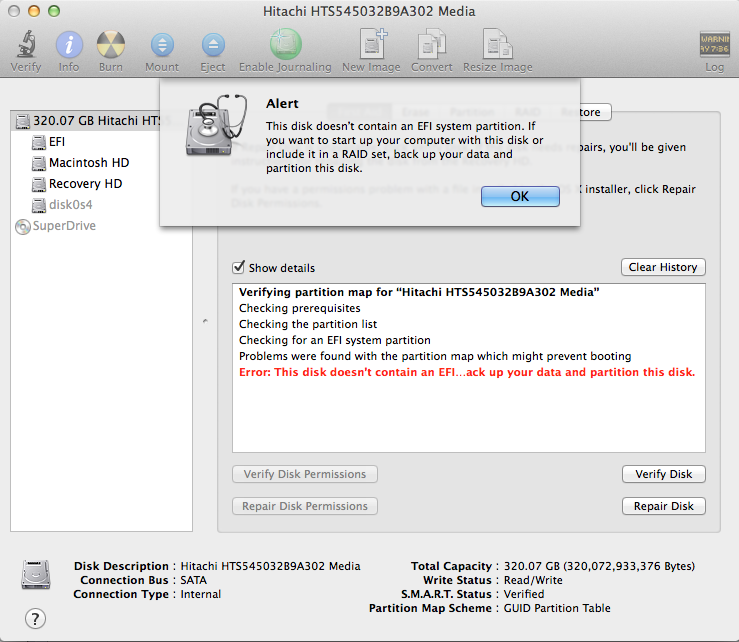

So I try to verify or repair disk. I get same error when trying to verify or repair:

You need to use the "recovery boot", and then use Disk Utility from there to perform those types of operations on your main disk. You can't repair a disk that you are booted from (sort of like sawing off the tree limb that you are sitting on 😉 ).
