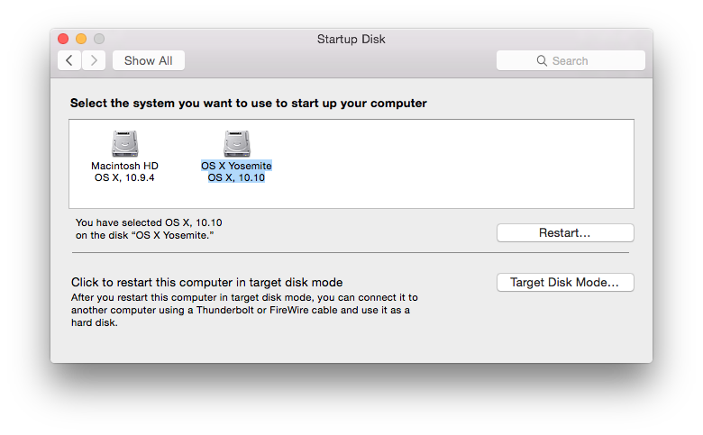

I made a partition on my MBP while 10.10 was downloading. Then once it was done downloading I selected the "OS X Yosemite" partition I made and installed 10.10 on that newly created partition.
Now I have two virtual HDD's. One with 10.9 with all my files and another one with 10.10 that is just 10.10 - no files, music, movies, etc. Just a clean install of 10.10.
