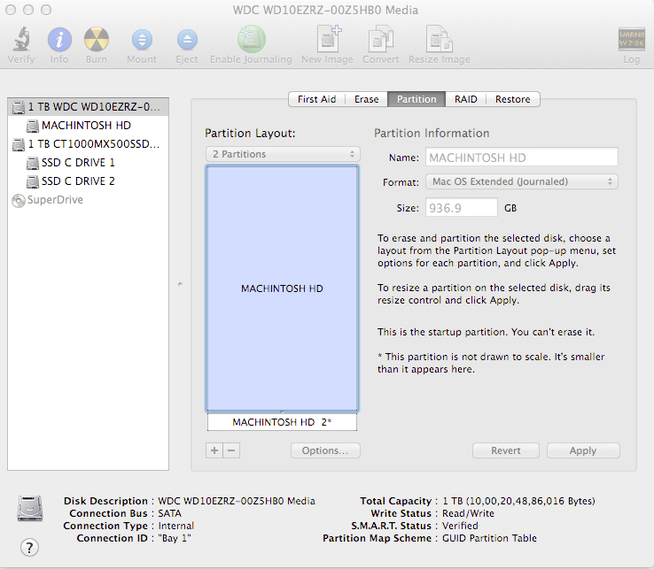

I wanted to partition my 1TB hard disk with disk utility , all I had in that disk was 400 GB data so I wanted to partition it into two partitions of 500MB each , I successfully dragged the slider to adjust sizes and started the process, unfortunately there was power cut and I had to restart the comp after which now it show a full partition of 999GB and almost entire partition barring a few MBs is blue , that is , it is showing that almost the entire drive is full with data which is not true, so obviously when I try it doesn't partition and all tabs on the partition page are greyed..... while trying to partition I get this error too :
Partition failed with the error:
Couldn’t modify partition map because file system verification failed.
How should I correct it now ......?

In the image below I have selected all these folders of the problematic Machintosh HD partition and found it to be around 400 GB unlike the size it is showing of 900 GB, does just copy pasting these folders mean that you have copied the entire system , or restoring does something more or is anything more left to be installed or copied ?
bA96f8
, in case you are not able to open the image I am talking about the folders from 'Applications to users' that we see after opening Machintosh HD.....
