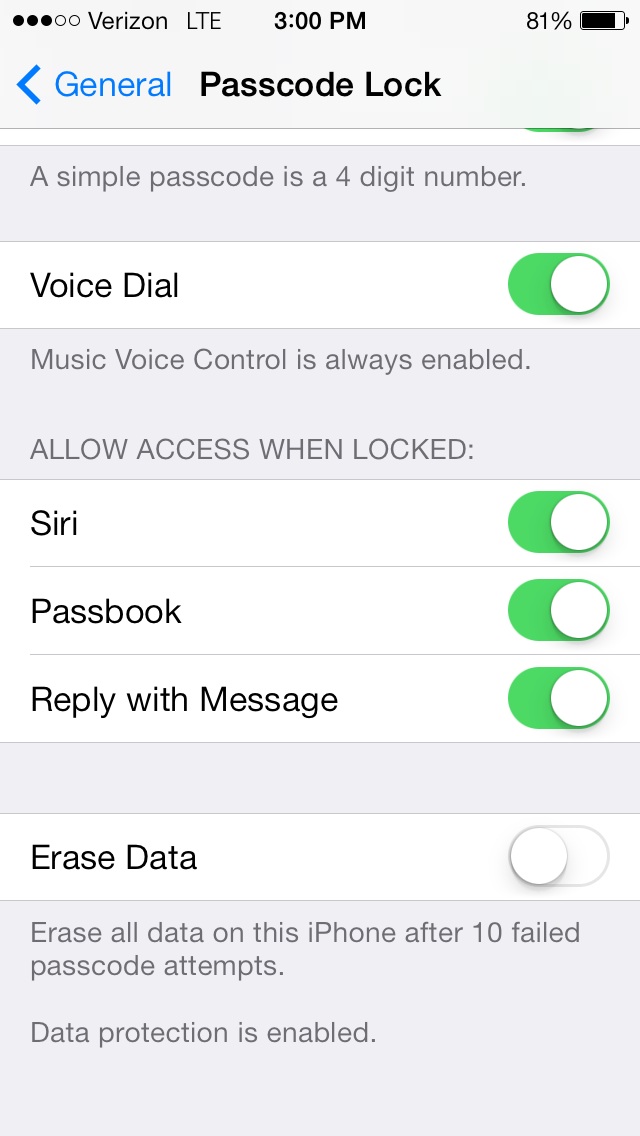

Just don't turn that on? After 5 or 6 attempts it locks you out. It only wipes your phone after 10 attempts if you have that feature turned on.
Just don't turn that on? After 5 or 6 attempts it locks you out. It only wipes your phone after 10 attempts if ok have that feature turned on.
I never turn on the 'wipe device after 10 attempts'.. I'd rather control when to wipe from iCloud. Plus, with the new activation lock, my iPhone will be a door-stop. 🙂
