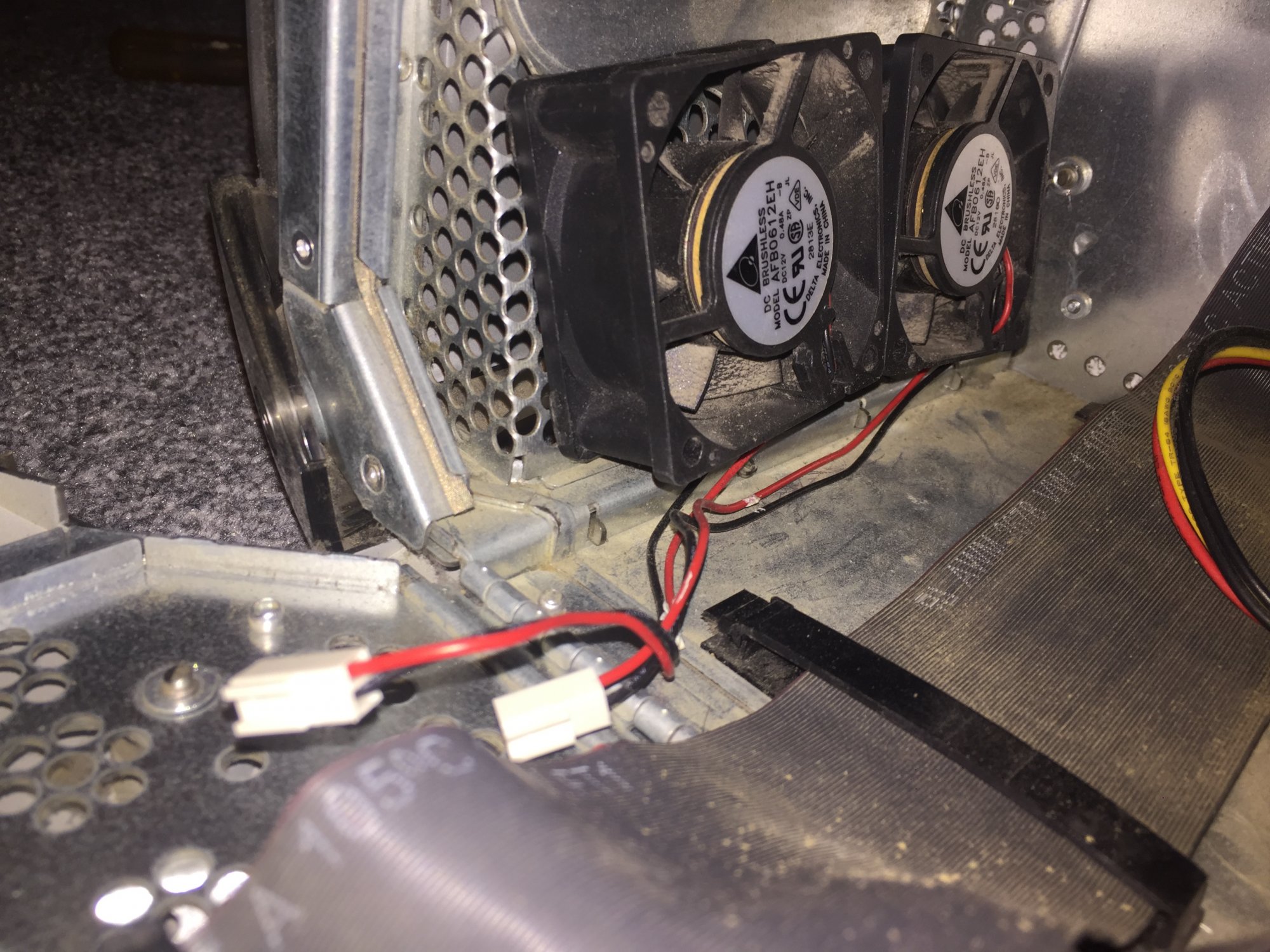

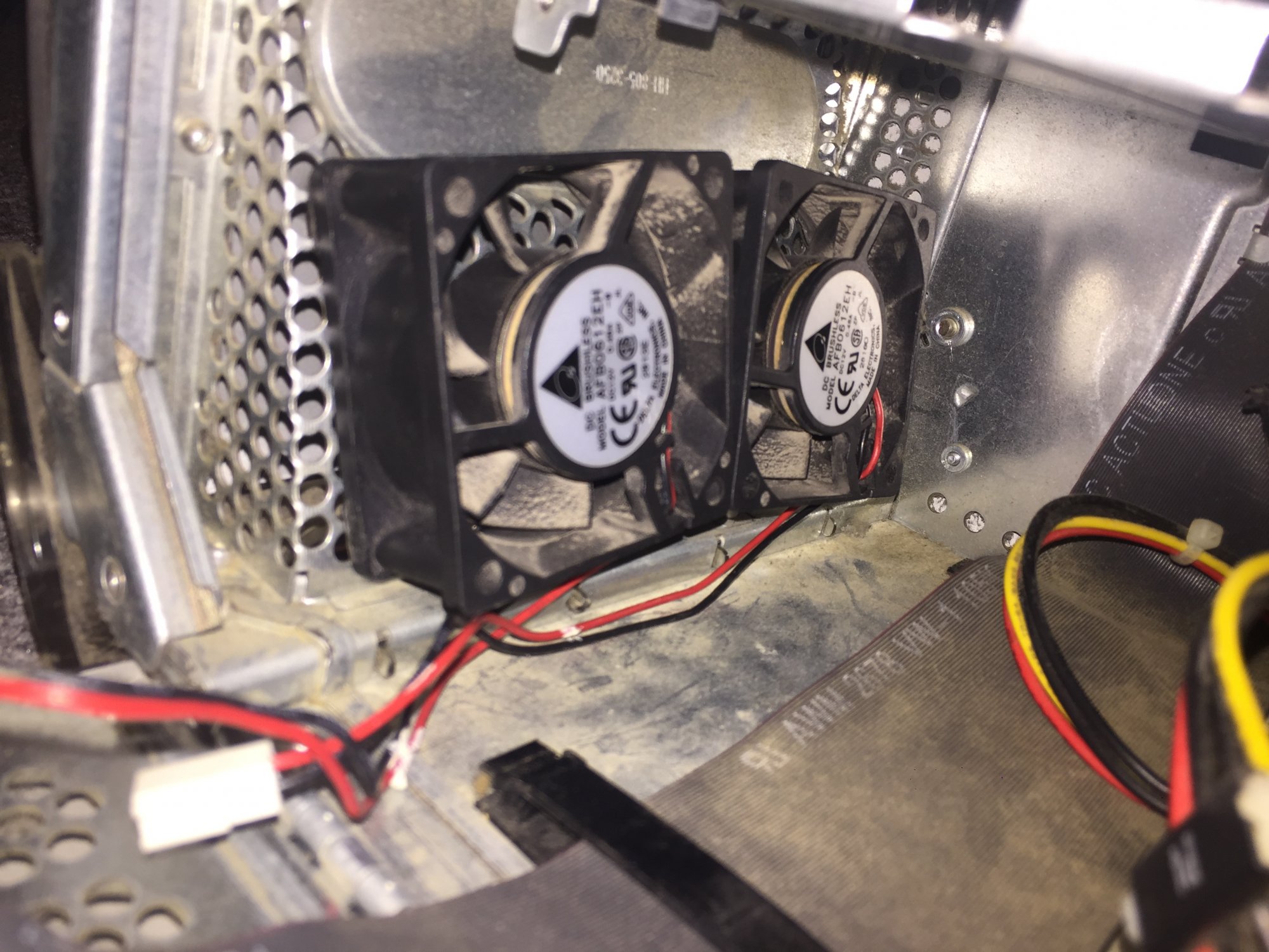

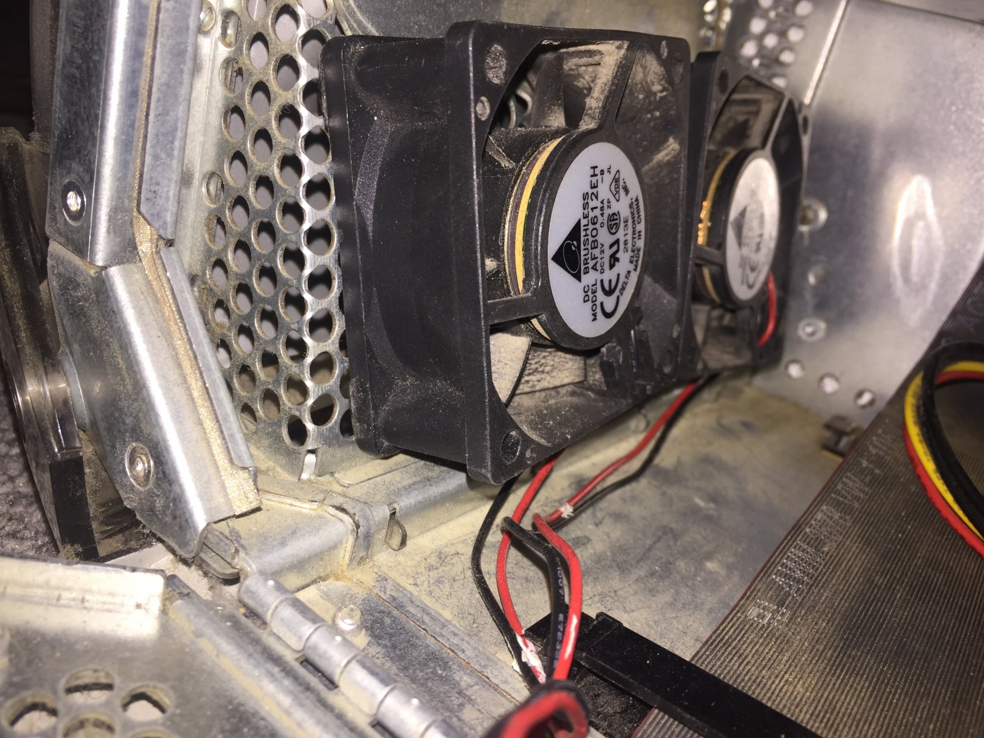

I had a failed psu, I took the two 60mm fans and fit them to the intake grille, no cutting, just waiting for two molex to farn adapters to arrive to test.
