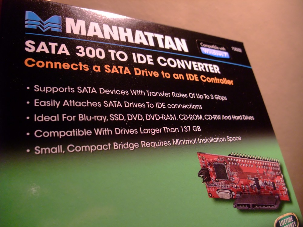

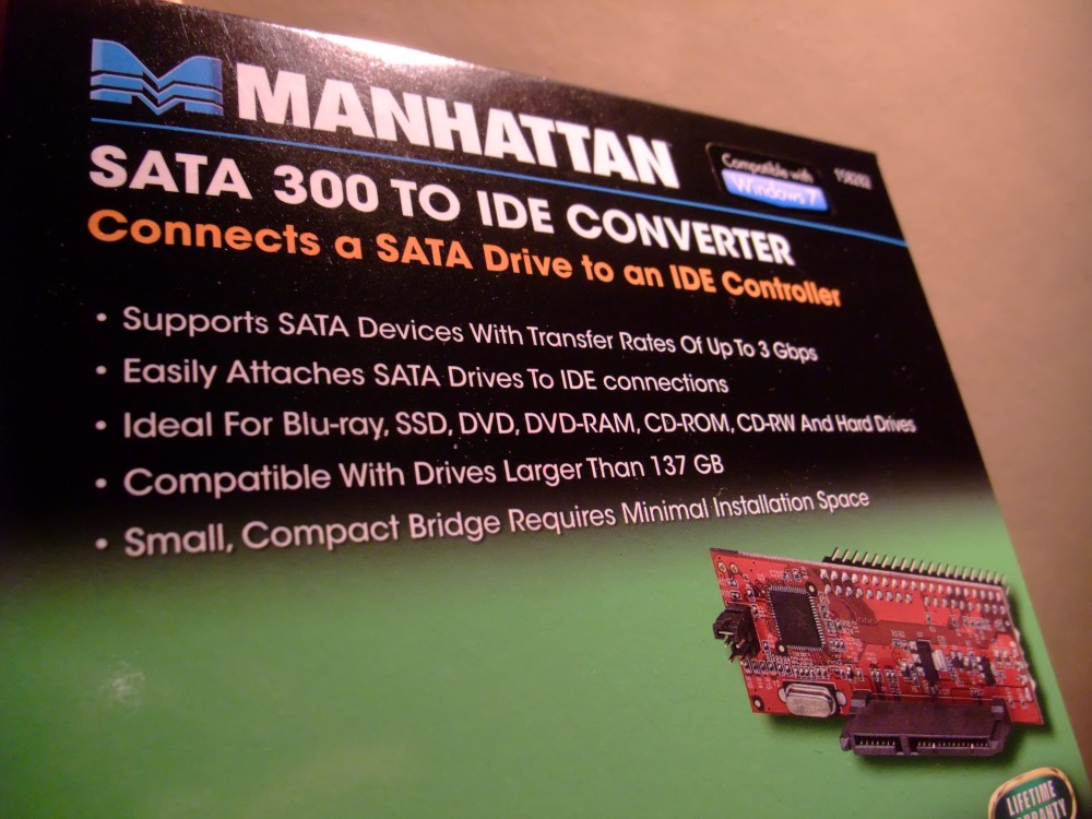

Based on negative experiences with some SATA to PATA (IDE) adapters in the past, I entirely switched to the red coloured adapter featuring the Marvell 88SA8052 chip.
This obviously is the best "multi-purpose" chip in terms of detecting hardware correctly. It allows both fast regular HDs (e.g. WD black series) and SSD to work up to SATA II speeds (3Gb/s), depending on the maximum speed the installed PCI host adapter provides.
This red bridge delivers accurate SMART data and supports master/slave mode and booting. I managed to connect optical devices (DVD Superdrives) and HD drives successfully, which previously were not detected by the OS while using other brands of adapters.
So this red adapter helps to use even newest hardware in combination with older Macs.
It is sold by different suppliers, but always comes with the well-made Marvell chip:
In most cases the Y-power-cable is included.
These are 44-pin "slim" variants:
http://www.conrad.de/medias/global/ce/9000_9999/9700/9720/9725/972597_LB_00_FB.EPS_1000.jpg
http://www.conrad.de/medias/global/ce/9000_9999/9700/9720/9725/972597_LB_01_FB.EPS_1000.jpg
http://www.conrad.de/medias/global/ce/9000_9999/9700/9720/9724/972440_LB_01_FB.EPS_1000.jpg
http://www.conrad.de/medias/global/ce/9000_9999/9700/9720/9724/972440_ZB_00_FB.EPS_1000.jpg
Conclusion: Do not rely on adapters you don't know the chip exactly! 🙂

The red one has a jumper to set Master and slave, the green one in your link does not. I had the feeling that PowerMacs need an adapter that offers a jumper.
