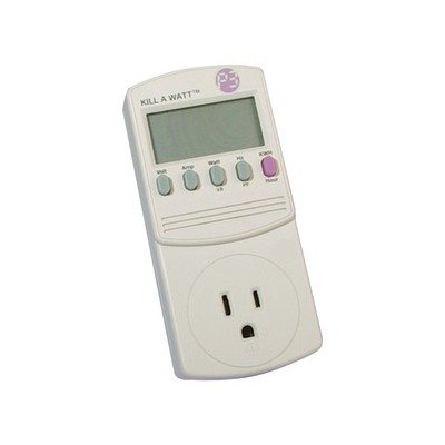

Not a software program , but something better 🙂 A kill-a-watt device . And you can simply add and remove individual PCI cards (and also place them at idle and at load) and get a real time readout of the amperage, wattage and voltage in any given situation . My stations are brimming with Kill-A-Watt devices ...

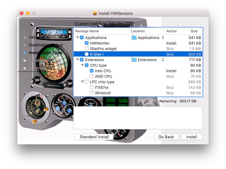

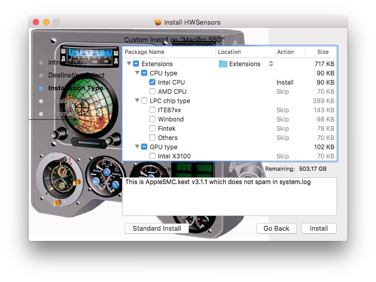

My Mac is encoding some movies at this moment, so can't test it yet. But this is what I understand so far. When installing this software, we need to choose custom install in step 3, and then pick the correct option. e.g. For my 4,1 (W3680, HD7950).
Choose the Intel CPU, AMD card, ACPI Access, and Silent AppleSMC.
However, I have no idea do I need to install the kext for LPC chip, or which type to choose.
After that, if we get all the readings, then it's fine. Otherwise, we need to write something into ACPImonitor.kext/info.plist with correspondence of ACPI method and SMC keys to get what we want.
It may be better to measure the overall power consumption, but can't measure each 6pin power source loading. The overall loading is not a concern for me. However, I would like to know how much power I am drawing from each of those line under stress (in Windows).
Maybe by using two external PSU , one for each power booster cable from the graphics card ? And a Kill-A-Watt device attached to each PSU ? That should do the trick . However, we are ,of course, not testing a normal System, but just an itemized draw from the video card's connectors .
