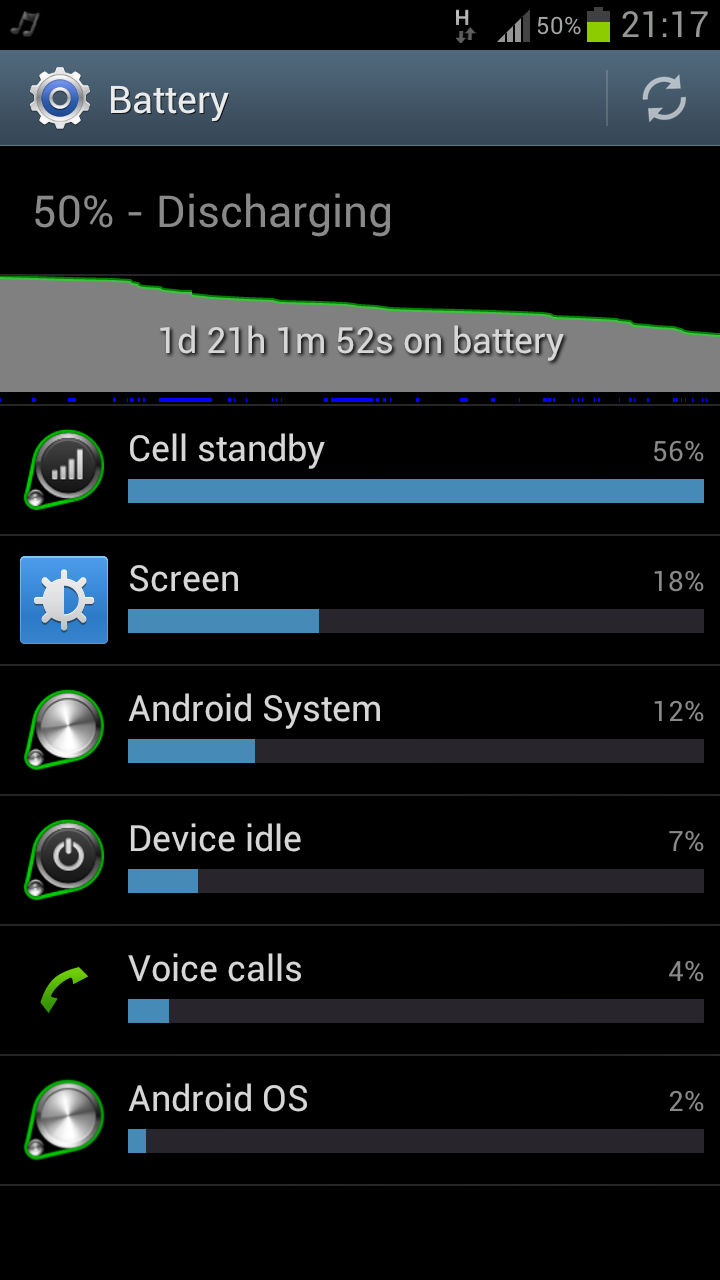

My Galaxy S3 is exactly the same. Oh no, hang on, after nearly two days my battery is at 50%.
I think the iPhone is great, but Apple really are beginning to look a little poor.
