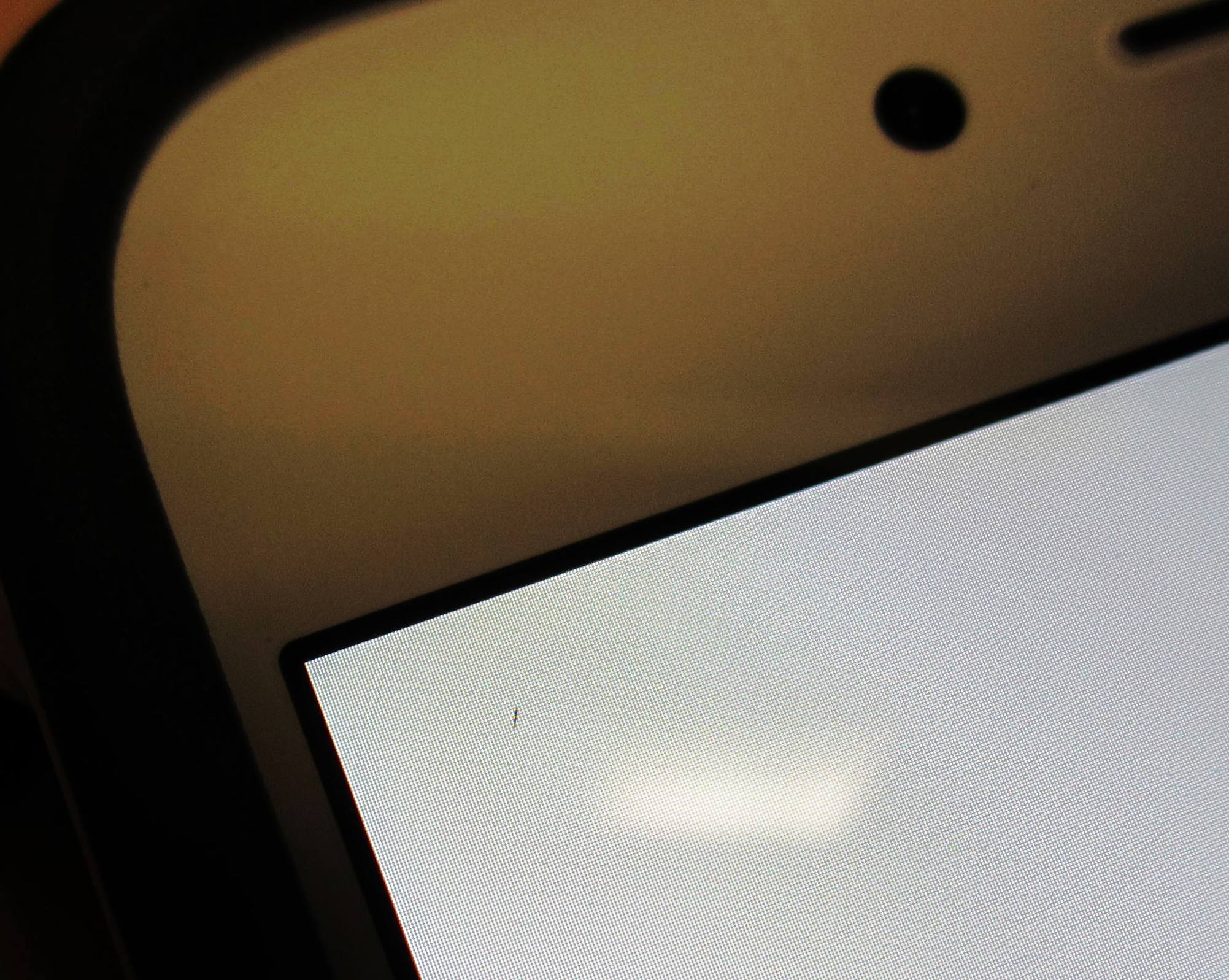

Can anyone else see a very fine honeycomb-like pattern when they look at the screen of their iPhone 6?
It's most noticeable to me on light solid colors when viewed at a slight angle. Although I do see it straight on at times too.
I've only been able to check one other 6 and it had the same thing.
It wasn't like this on my 4s, and not on the rMini.
it's part of the touch sensing pattern of the sensor its usually indium tin oxide which appears pretty transparent.
I figured that was what I was seeing. It's just a shame it's much more visible than on other devices.

Its usually more visible with the LCD off and the light reflecting off of the glass screen at a certain angle while you are looking at the screen at another angle.

Maybe I got a lemon. Going to the store tonight to have it exchanged for this..

Pattern on screen of 6
From http://www.anandtech.com/show/8554/the-iphone-6-review/8:
"The other issue at hand is that of viewing angles. While Apple is one of the first to really talk about dual domain pixels, this technique is rather commonly used to improve viewing angles. The result is that a pair of pixels will appear to be a chevron, and overall the pixels appear to be squiggly in nature. While this doesn’t really change the readability of the display at extreme angles, colors like white no longer have noticeable red/yellow/blue shifts depending upon the angle that the display is shifted at.
This is definitely noticeable in everyday use, as the iPhone 5s could only avoid color shifting at certain angles instead of every angle. As I predicted in the launch article though, the one caveat seems to be that black has a noticeable shift towards purple in certain angles. There's also a noticeable hatching on close examination, but this doesn't affect image quality. This is definitely better than what I see on AMOLED though, as while AMOLED has much better brightness stability the color shifting is far more obvious and significant."
