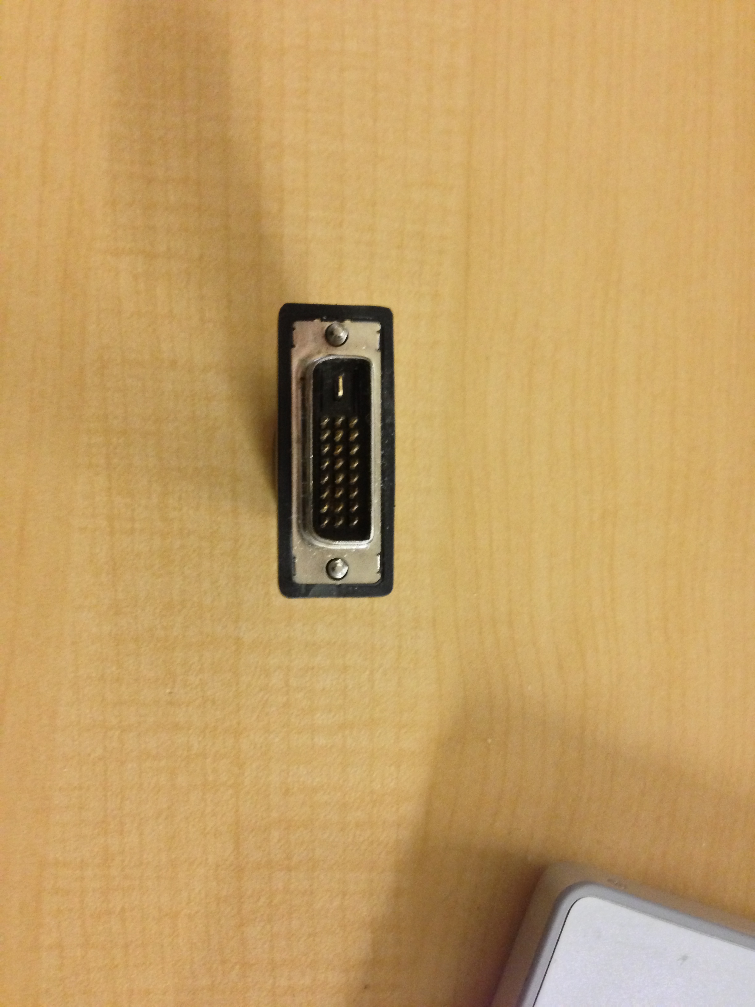

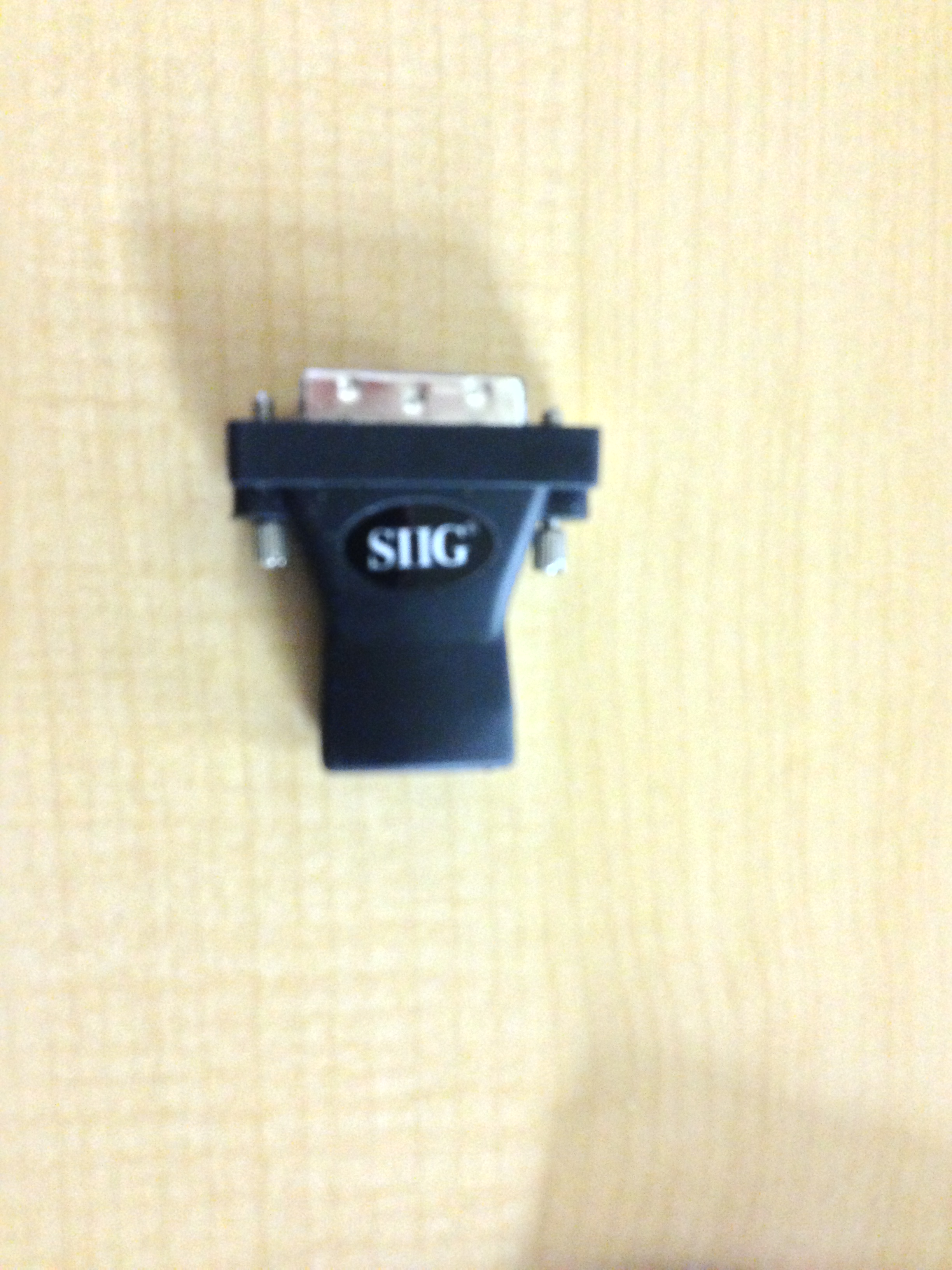

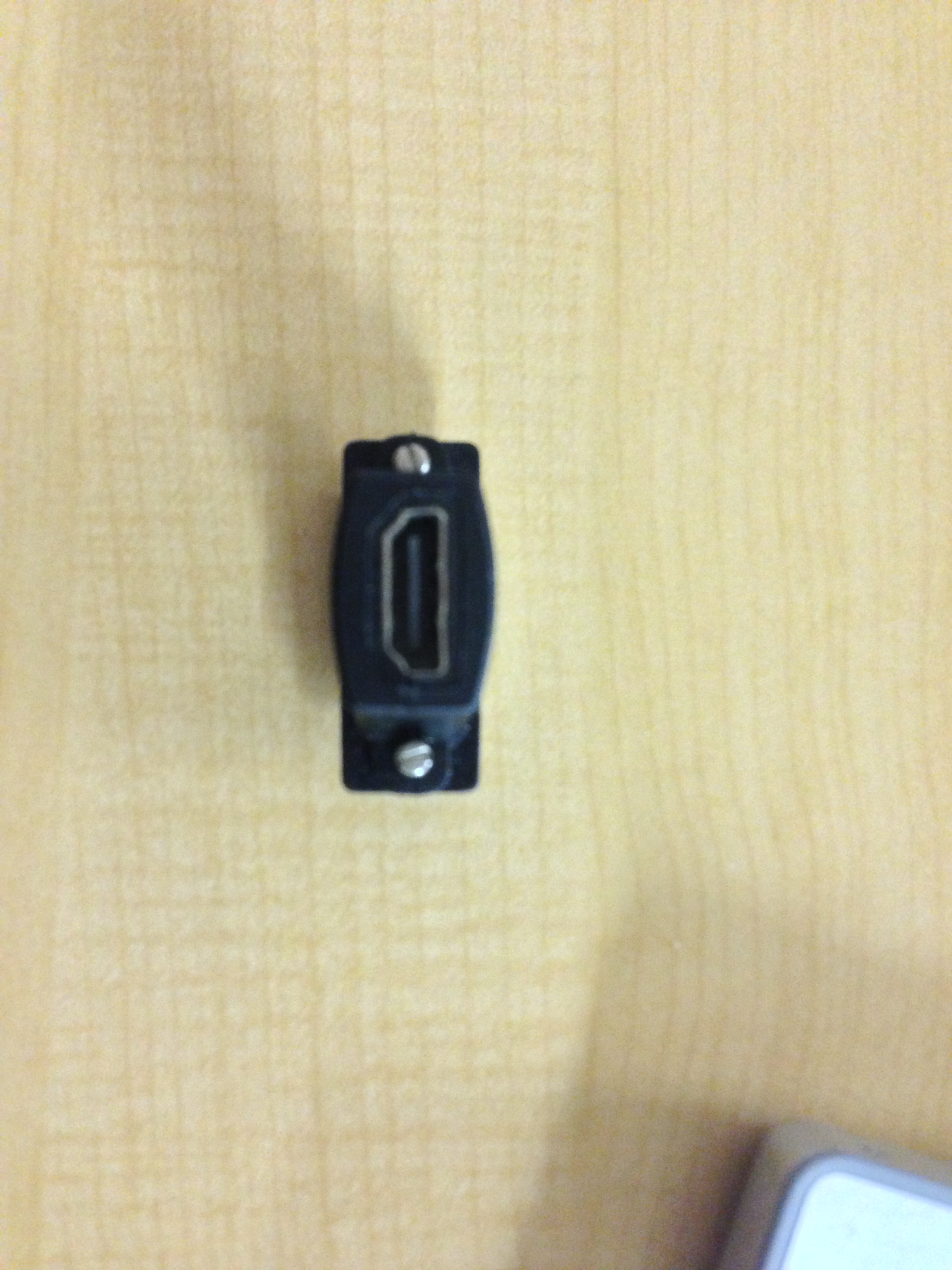

I have this…
DVI to HDMI adapter. As I understand it, at least with the PowerBooks Apple did not include audio with the DVI format. I just run a standard HDMI cable to my plasma tv. My TV has two HDMI ports. The first one has an audio jack and I run an audio cable from my Mac to that. It has the same connector on both ends. My cable box, which has digital audio with the HDMI connects to the second port which accepts audio from the HDMI cable.
DVI and HDMI by the way are the same. The connector type is all that determines if it's called DVI or HDMI.
Don't know if that helps or not.

I have this…
DVI does not include audio at all, it's just not part of the DVI spec. It's not an Apple thing.

In any case, I do believe it's possible with DVI-D. This is from Wikipedia about DVI. Empashis, mine.
"To promote interoperability between DVI and HDMI devices, HDMI source components and displays support DVI signalling. A 1080p HDMI display can be driven by a single-link DVI-D source -since HDMI and DVI-D both define an overlapping minimum set of supported resolutions and frame buffer formats. So, DVI-D devices output HDMI signals, many including audio, (examples: ATI 3000-series and NVIDIA GTX 200-series video cards),[7] and some multimedia displays input that HDMI signal, including audio, by using a DVI to HDMI adapter. Exact capabilities vary by video card specifications."

Nope, it's not part of the DVI standard, you'd need DVI-I or DVI-D and digital audio with an adapter to be able to output to HDMI with display and audio.
OK. I don't know much about it so I'm not going to defend the undefensible out of my ignorance.
Thanks for setting it straight.
