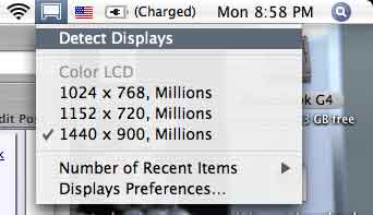

I usually turn off the monitor first, then click the "Detect Displays" thing and PB comes back in single display mode by itself without any issues. It is kind of a like ejecting a drive from desktop thing. I believe this is the proper way to disconnect them while they are still awake.
I don't think you should just junk the cable out while it is still feeding the signal to a external display. It is a bit of a different story when you connect, since the screen spanning/mirroroing is off.
