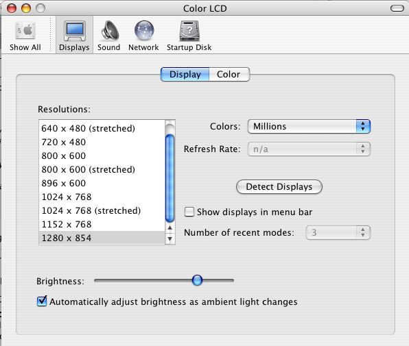

Are you working in a dim light? This is the powerbook trying to ajust to the light around it, to save power. If you walk into a dark room, it will dim the backlight to the screen and turn on the backlight to the keyboard (if yours has it). Try putting your hands over both speakers to block the light from going into where the sensors are at for a few seconds, the screen will fade out, then remove your hands, and it shouldl fade back in. You can turn it off I believe, not sure where though. I'll get back to you on that.
EDIT: Its under Display in the System Preferences. Its at the bottom of Displays area (Picture attached).

It's the backlight. You just have to adjust it. Try to keep the light in the room constant if you don't want it to dip in and out of brightness.
In addition, if you are running 10.3.8 there seems to be a common issue with hypersensitive brightness adjusting in powerbooks. I've found two suggested fixes. One involves simply disabling the automatic adjustment as mentioned above, and the other involves using Pacifist to install a previous version of the brightness control driver.
I've just disabled the automatic adjustments for now as I'm rarely, if ever, in dim conditions.

same here. since 10.3.8 the brightness changed almost randomly. seems it even reacted to the shadow of my hand while typing. it was much worse in artificial light compared to real daylight. probably it picks up the 60 Hz from lightbulbs.
disabling the automatic brightnes adjusting fixed it. its much better to adjust the brightnes with f1-f2 anyway.
