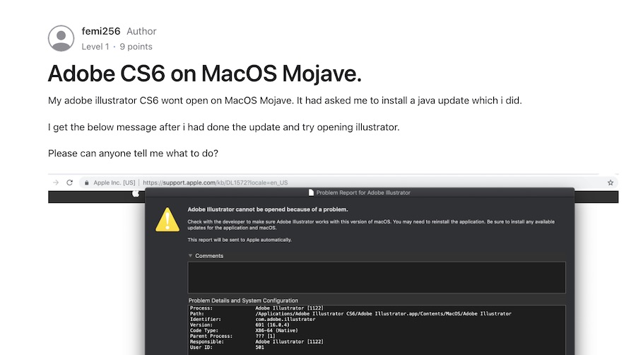

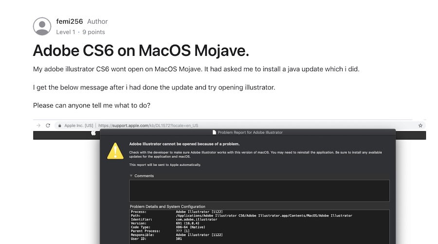

@toke lahti. Better to check if Adobe CS6 can run efficiently in Mojave 10.14.6. Retain a backup drive with Sierra or High Sierra if you intend to install Mojave. If I’m not mistaken, check OpenGL as this might no longer be working as in Mojave, Apple switched to metal. https://discussions.apple.com/thread/250007572
Enabling openGL in 10.14 would be interesting.
Can you point the way for that?
10.14 would be nice for both CS6 and FCP7...
You don't need to enable OpenGL in 10.14. Mojave has OpenGL working natively since day 1. It's just depreciated, not removed.
Anyway, you mixed up a lot of different things all together. This won't help anything. You better read and re-read what Tsialex told you. His info is accurate.
FCP 7 is a 32 bit application, won't work in 10.14 regardless OpenGL is there or not.
