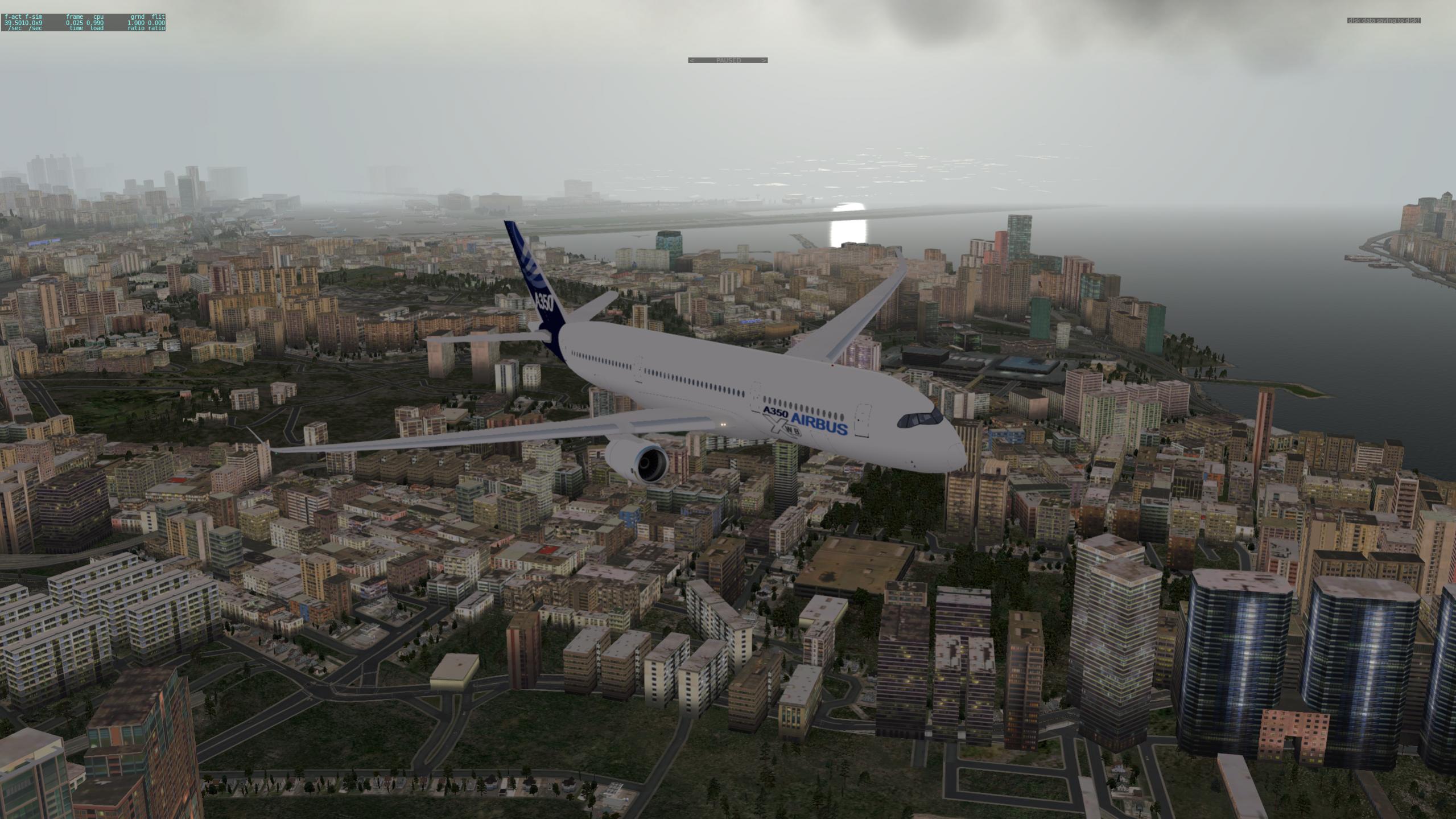

My spec is almost identical to you and when the 7950 was running at PCIE 1.0 is was very disappointed. Now that kit PCIE 2.0 it is night and day. I suspect X-Plane in 64 Bits needs that extra bus width to maximize the FPS.
I am using Extreme Textures compressed (compressed is apparently runs better on Macs) My scenery levels are mid to high, with only the traffic set fairly low. Shadows are 3D global and water is low. Distance is set to medium.
With HDR on and 2x SSAA with OSM scenery I am getting worse case 21-25 fps in the Saab 340, which is the most intensive plane on X-Plane. With the FF757 I get 28-35fps. I am also using Skymaxx which brings better frame rates and better clouds.

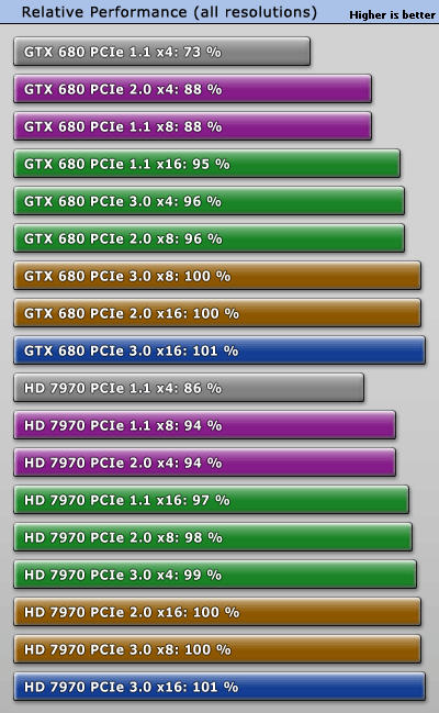

I looked up the problem, and got a pretty convincing chart showing the (pretty insignificant) performance difference between PCIE 1.1 and 2.0.
Not sure 5% performance boost justifies a $300 price boost...

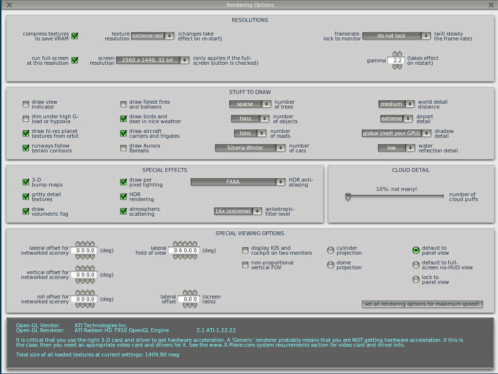

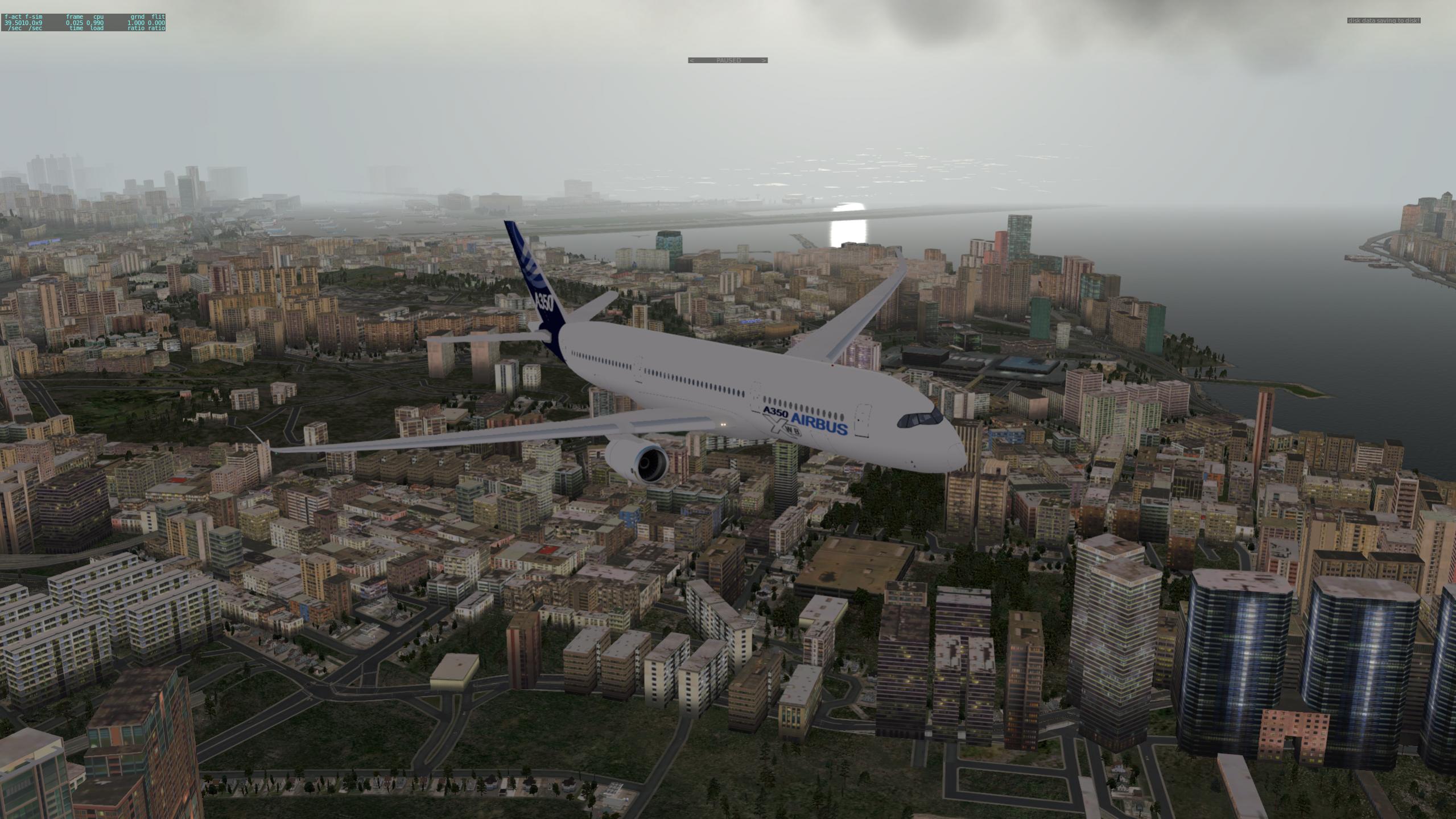

With reference to your settings. After some testes, I finally use the follow one.
Now I can have very good picture with constantly >30 fps, which is very decent performance. Millions thanks for your sharing.

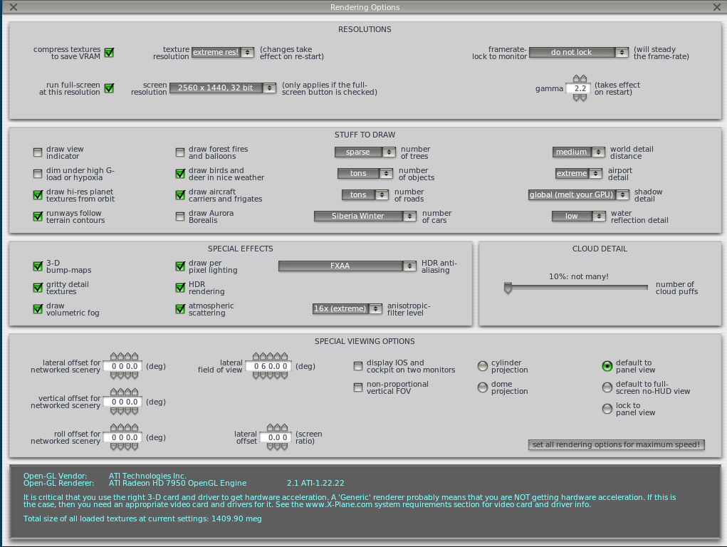

Glad it worked out, I got the tip, I think, from the X-Plane developers blog, it makes a huge difference and really needs to be promoted more to Mac X-plane users.

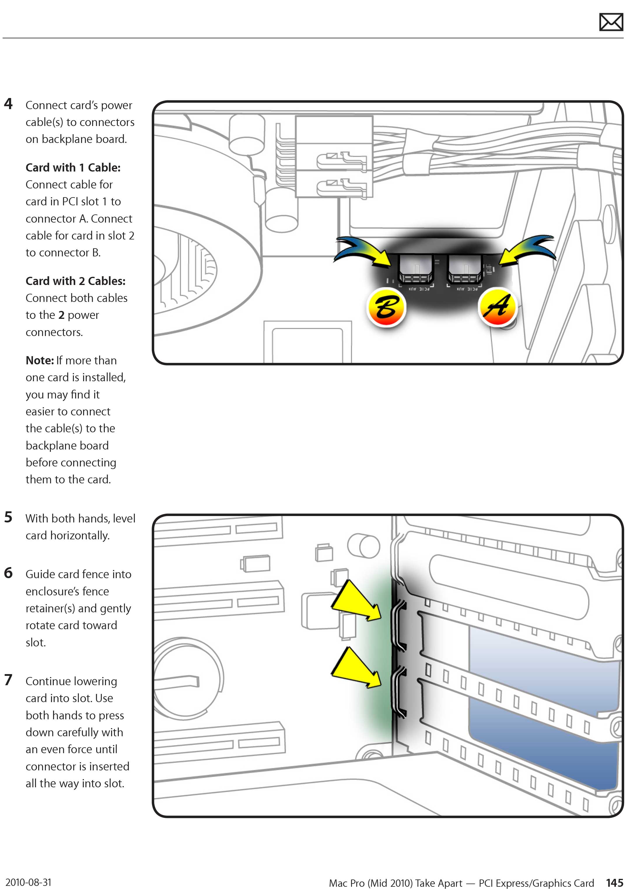

Do you know where I can find the power pins on the Mac Pro? I don't remember seeing anything on the motherboard...
Thanks so much flowrider!!! It's like you read my mind, I was just looking for those pci aux connectors 🙂
I'm now trying to find the right cable to order and try it out. Doesn't the 7950 have 8 + 6 pins? What would that mean? Do I need to plug two 6-pin cables ( http://www.amazon.com/PCIe-Power-Ca...ref=lh_ni_t?ie=UTF8&psc=1&smid=A3IDT9F5A1GWX6 )
and use an adapter 6-to-8 pins on one of them? Not even the manual is explicit about cabling to use. I feel like there's no documentation about this :| lol
